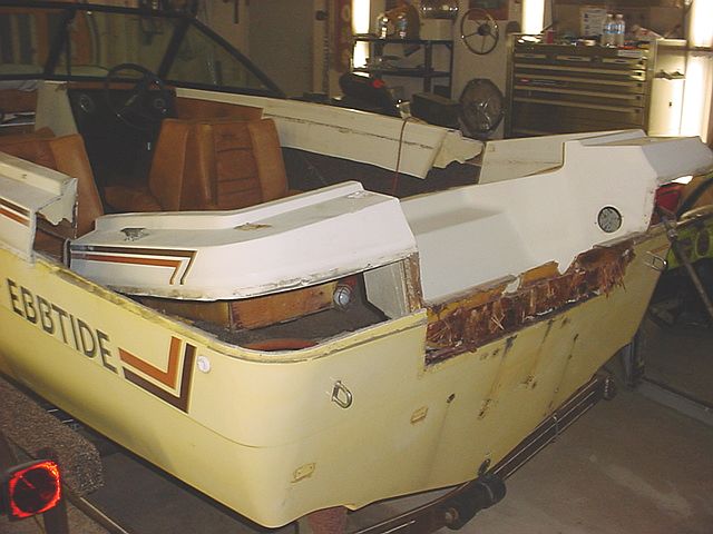

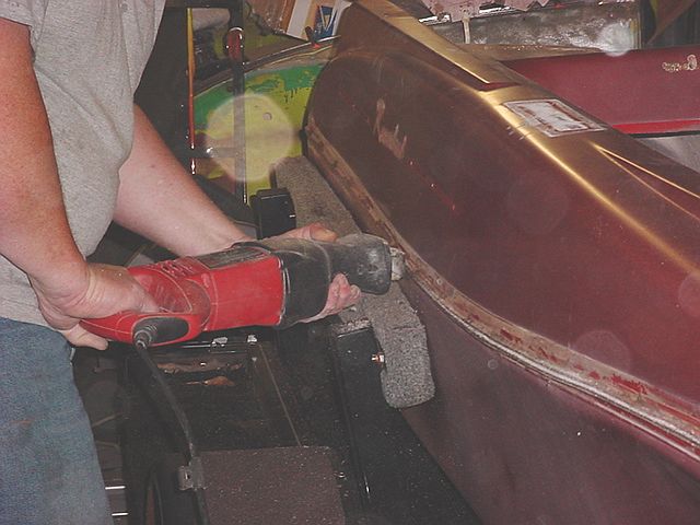

It depends on what type of deck/hull joint your Ski Horse has. If you could post a pic of the seam it would greatly help in determining what you need to do. If you have a flange joint (basically the deck uas a lip that turns outward a bit and the hull has a lip that turns outward a bit) then you can take a sawzall and cut it between the two halves and you're good to go.
But if yours has a shoebox type setup where the deck actually slips down over the outside hull by an inch or two, you'll have to get inside the boat and carefully cut the glass "tape" that was applied at the factory along the seam. Then the top half will slip up off of the lower hull.
I've included a couple of pics. 1st pic is of a flange type joint, the 2nd of a shoebox type joint. On the 2nd pic the rear section of the deck has been cut off, but you can still see the joint overlap. If you have a flange type joint and you just stick a sawzall there and slice it open, you will end up cutting part of the lower hull off. Then you will hav to glass in a section all the way around the top of the hull to get the correct hull height before you can install the deck.
Flange Joint
Shoebox Joint
