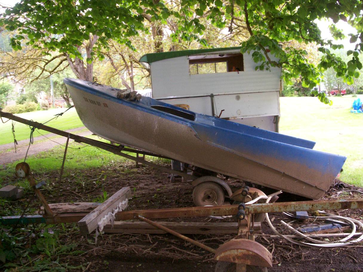

Cleaned the gunk out of my Banshee and ready to start grinding! I tried with 120 grit and my variable speed 5" and it barely touched it. Should I go down to 80? Seems to be 2 or 3 coats of gel coat. The hull is white but has blue-green gel coat under the white. Any recoo to get it down to where I can fill the dings and undercoat? Sold my Delaney Cat so I need a lake and river boat. Thanks in advance for the suggestions. Mike

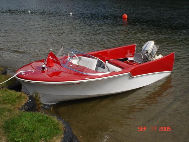

80 grit it is!! I've got lots of time and not many spiderwebs in the finish so I am lucky. Hope it turns out half as nice as Rons. (picture of Rons boat)

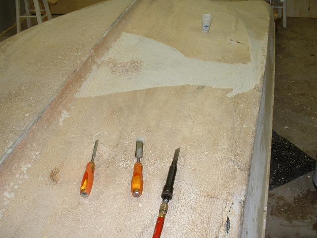

I think the most important part is when you are grinding you move the sander in different directions. Use the sander as if you where doing finish body work. Like in a forty five or cross cut pattern. By doing this you will get a smooth flatter surface. Sand with the course paper until you are close to where you want to be then switch to the eighty.
You may think you have a lot of time for sanding but some of these boats from the fifties can have old gell that is up to a quarter inch thick. Just depends what part of the mold it is and who shot the gell on.
I used an air powered gasket scraper on the hull of a carAgua because the gell was so thick.
