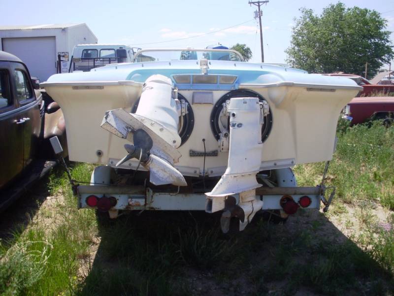

Did you notice the fracture on the starboard side lower unit?
This one is sad. Leaving them out in the Southwestern Sun for years apparently isn't all that good for them.
I made a deal for one in somewhat better - but also not great - shape in Mesa AZ. I might see if I can buy some bits and pieces off this one and pick them up on the way to get the AZ boat.
The Dual is such a goofy boat. Take the 88 hp 2 stroke outboard and run it through a weak sterndrive. Employ an auto lube system that never did work right, then double down on the resulting noisy boat with sketchy mechanicals that uses a prodigious amount of fuel.

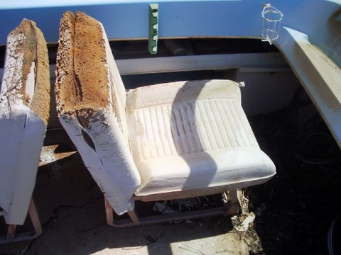

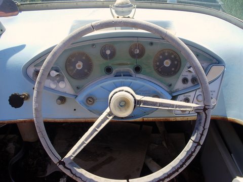

The heck of it with these boats is that the way they were built if certain parts are nasty they're really hard to restore.
The instrument panel is a good example as are the seats - well the seats are impossible to resore all you can do is recover them but you can't duplicate the originals which were made in a pressurized hot mold.
Another problem is that the decks are textured. The usual methods of restoration result in a smooth deck which is not right. So if the decks are bad it's almost a deal killer. But - those of us who like these behemoths must find a way to restore them and save the texture/seats/instrument panels or we'll have to write off 90% of the remaining inventory.

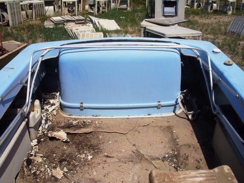

Some photos of the New Mexico Boat are attached.
Note the time honored 3/8" particle board floor skin attached with Black Drywall Screws !
