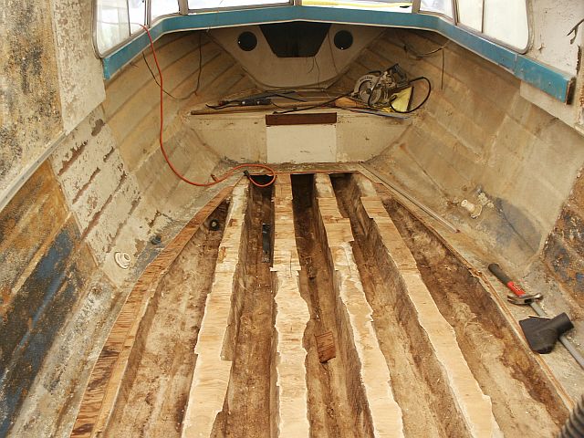

So I just got done cutting and glassing my strangers in on my seafair, I cut all floorboards out and I cut and glued my transom in. I'm working with Nautical 20 and Bluewater 26. The stuff cuts like a charm, sands like a charm, will not rot, needs minimal resin since you don't have to glass the entire piece, and is super light. If you can afford it...get it. I now have a glasspar seafair that will never have a rotting issue ever again. I also sealed the floor and filled it with foam and it made the deck which is made of nautical 20 as hard as the bluewater 26.
I cut some of the bluewater and nautical and put it in a jar of water and locked it shut about 3 weeks ago and set it on a 1/2 thick steel outdoor work bench that gets direct sunlight during the day hoping to get some expansion from the material when the water heats up to really test the material.
I took it out today and let it air dry for 30 minutes, weighed it and compared it to a non soaked piece of the same size...no water intrusion at all...both weighed exactly the same.
I live in southern california and my local dealer was revchem composites over in costa mesa.
I'm only posting this because all my searches on this stuff led to threads where the board was talked about but not actually used. And this is my personal experience with the board.
Hope this review helps with your decision on what material you are going to use for your project.
