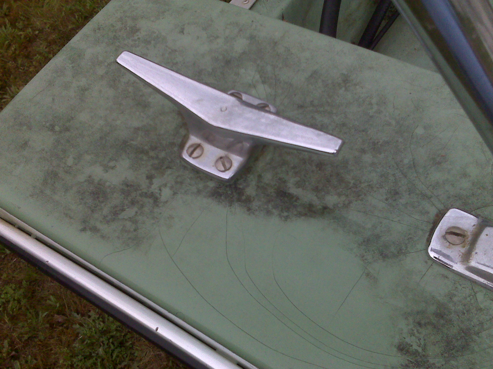

Re:1964 Wellcraft R-1500 Restoration project 16 years 5 months ago #7944
The wet sand really did wonders! I have cleaned the entire outside of the boat, and will be sanding this week. It looks as if this sanding will revive some of the life and remove the oxidation layer. It looks better already!
Thanks for the help.

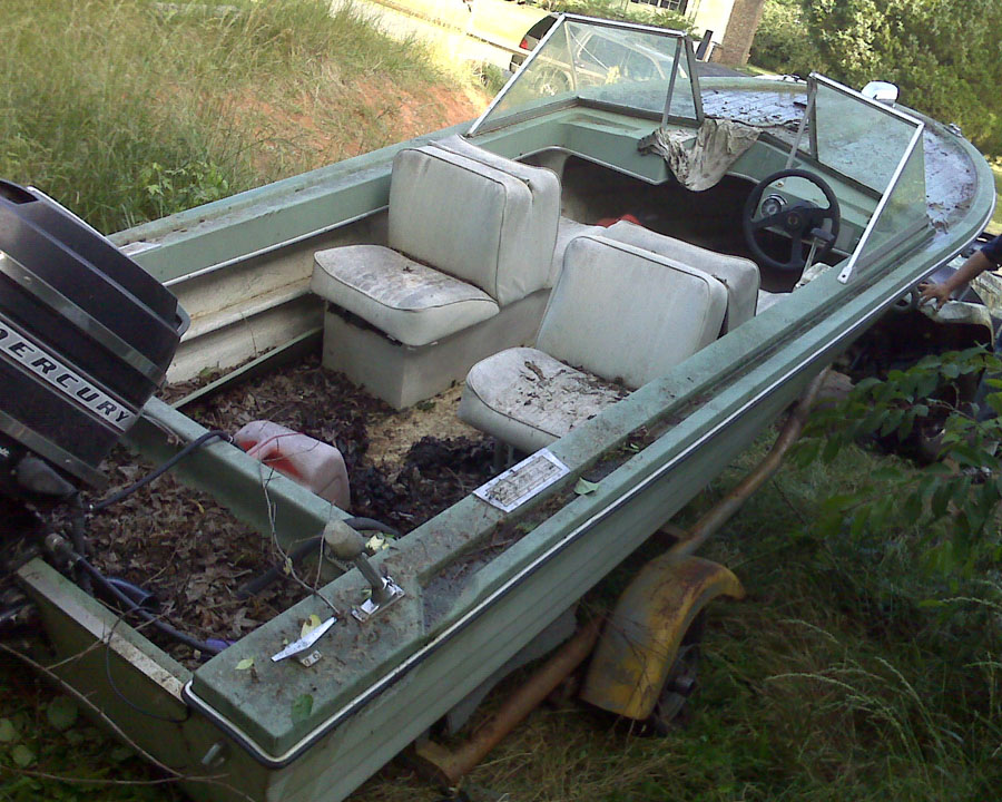

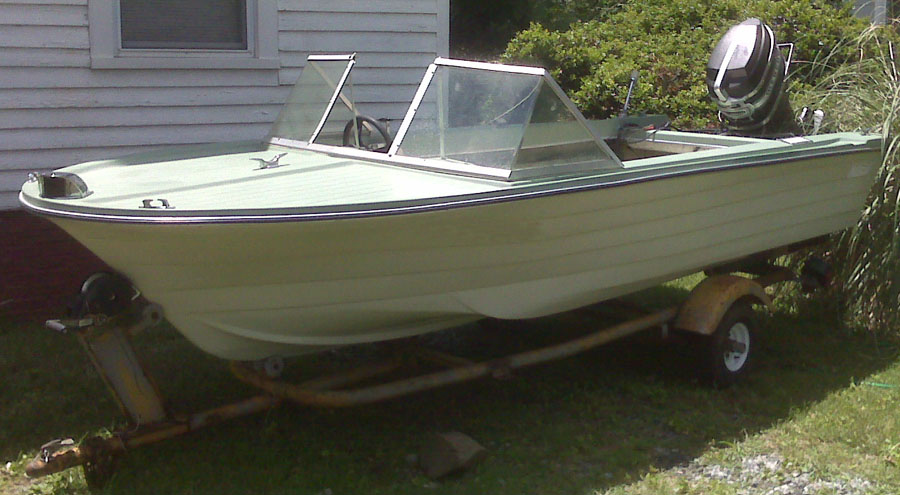

Re:1964 Wellcraft R-1500 Restoration project 16 years 5 months ago #7949
This was the beginning....

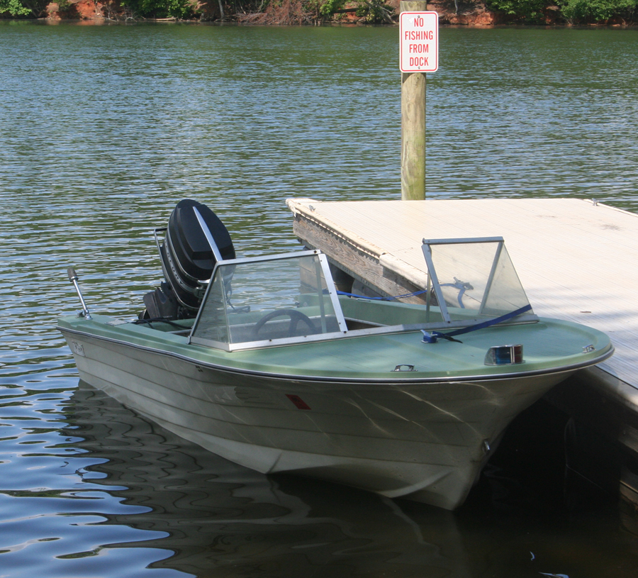

Re:1964 Wellcraft R-1500 Restoration project 16 years 5 months ago #7950
Here is the result of listening to a few good suggestions, putting it on the water (and not sinking), and a few days of intense cleaning.
How is it so far?

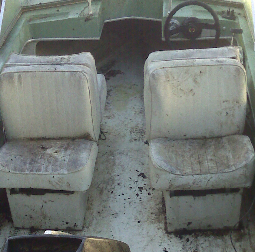

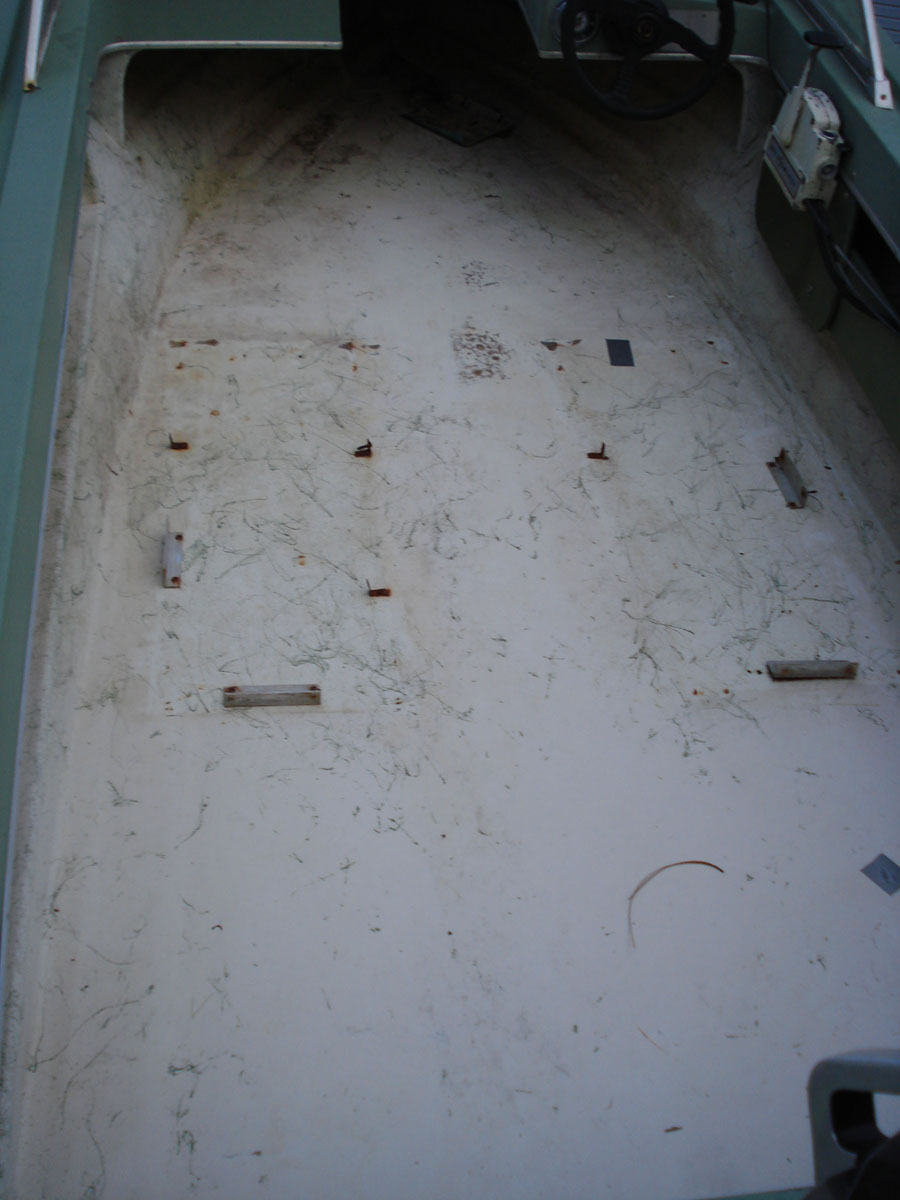

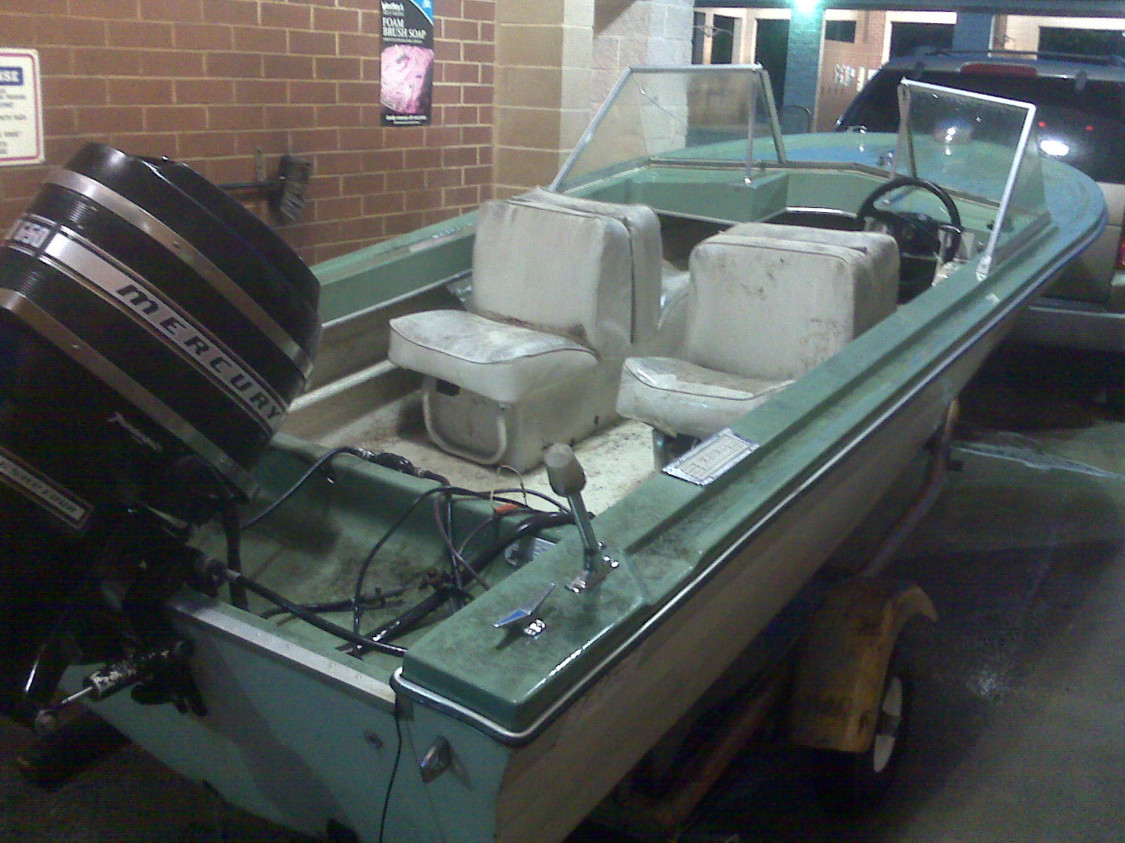

Re:1964 Wellcraft R-1500 Restoration project 16 years 5 months ago #7951
Here is the inside after the seats were removed.....
Re:1964 Wellcraft R-1500 Restoration project 16 years 5 months ago #7952
After the car wash
I will add more photos over the next few days as I use the wet sand to remove the crackling and oxidation.
I have been told that if we would like to keep the same paint to go ahead and a few coats of wax when we get the desired results from sanding.
I am beginning to fall in love with this project.
Re:1964 Wellcraft R-1500 Restoration project 16 years 5 months ago #7955
It's coming along nicely! I know it's hard work, but very gratifying, IMHO.

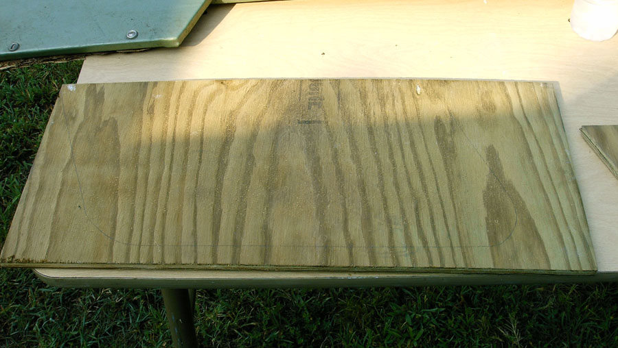

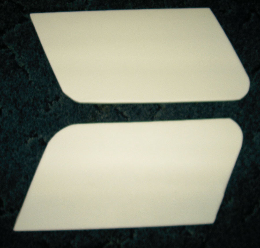

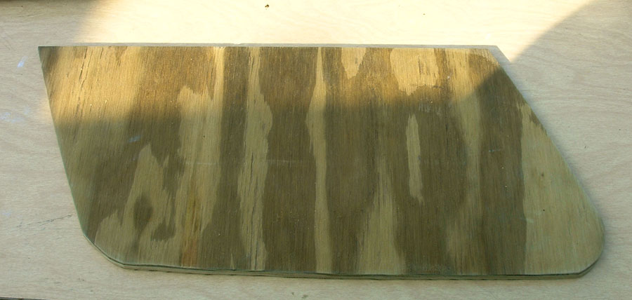

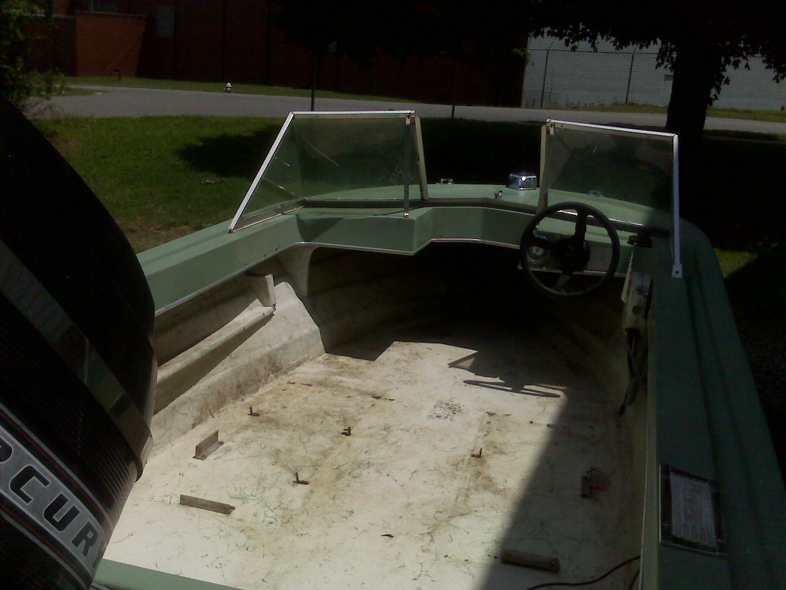

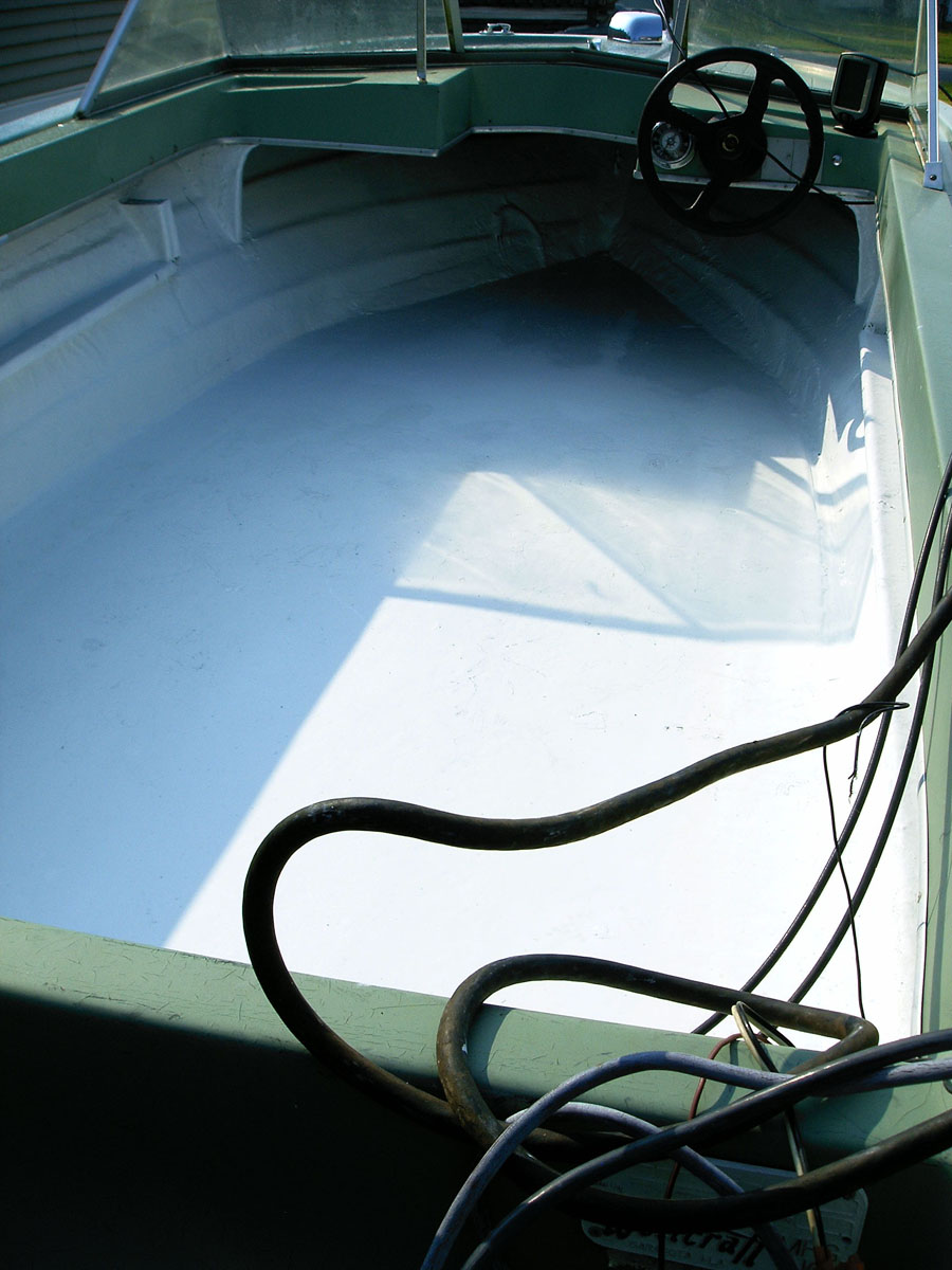

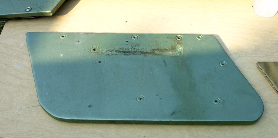

Re:1964 Wellcraft R-1500 Restoration project 16 years 3 months ago #12886
Here are a few pics of the project as it is coming along slowly but I am making progress.
I have painted the interior, removed the side panels and have made new side panels.
Here are the pics.
I will hopefully complete the installation of the side panels tomorrow, allowing the paint to fully dry on the interior floor and sides.
I will keep you posted on the progress and thanks for the tips and suggestions.....you guys are great!
