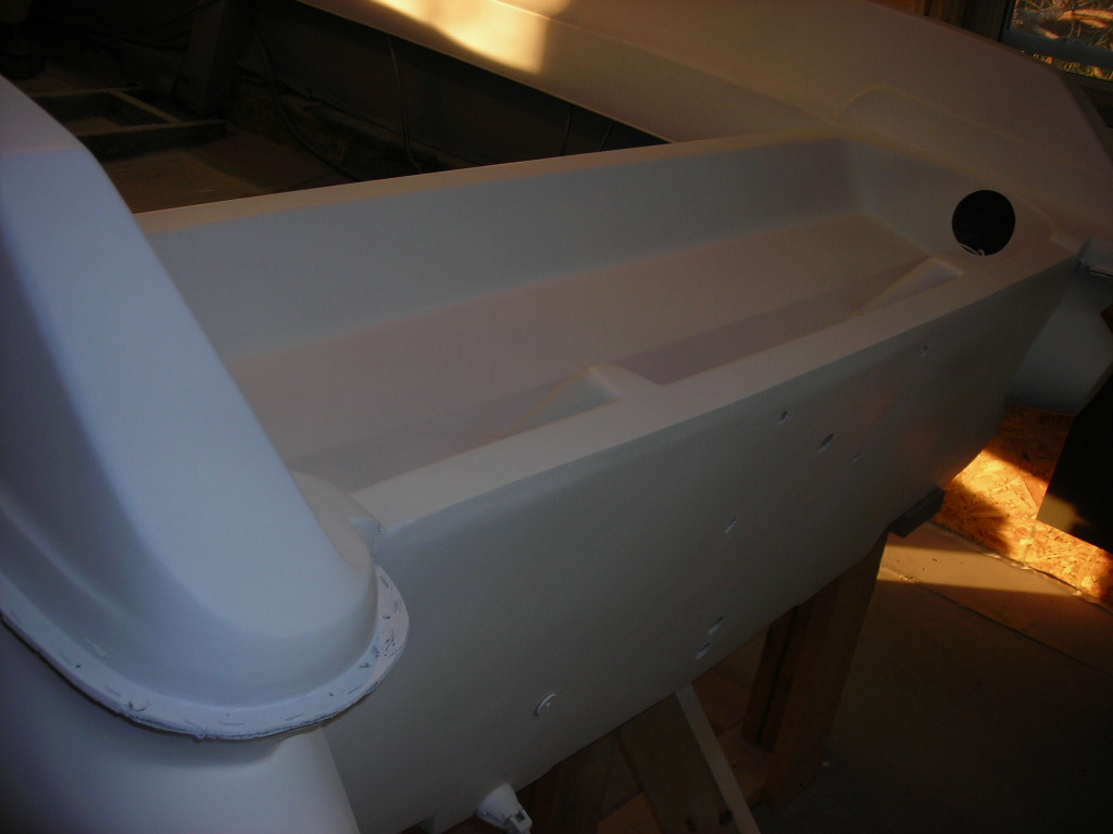

well i finally got the primer on,ill never use high build primer again,it wanted to splatter no matter what i did,so its 3:30 pm,next comes the white,seems like a waste lol,it already was white,lol,then the teal and clear

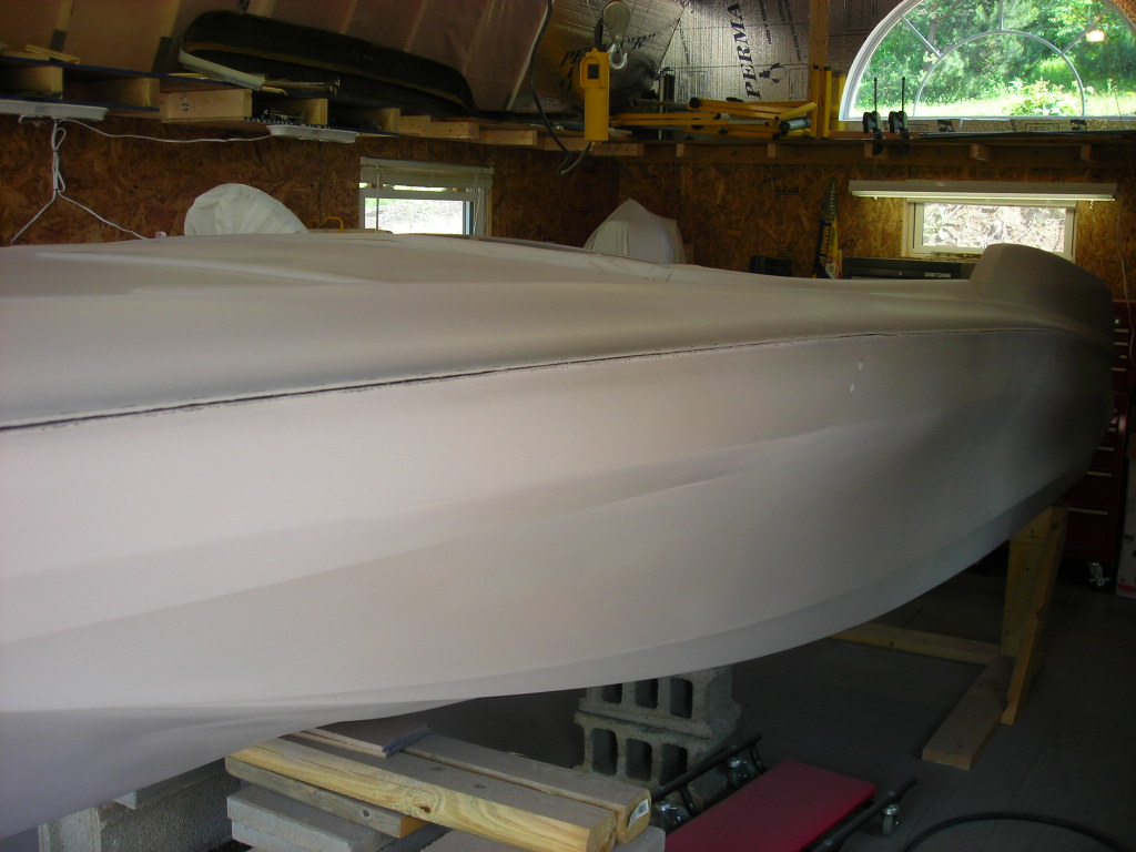

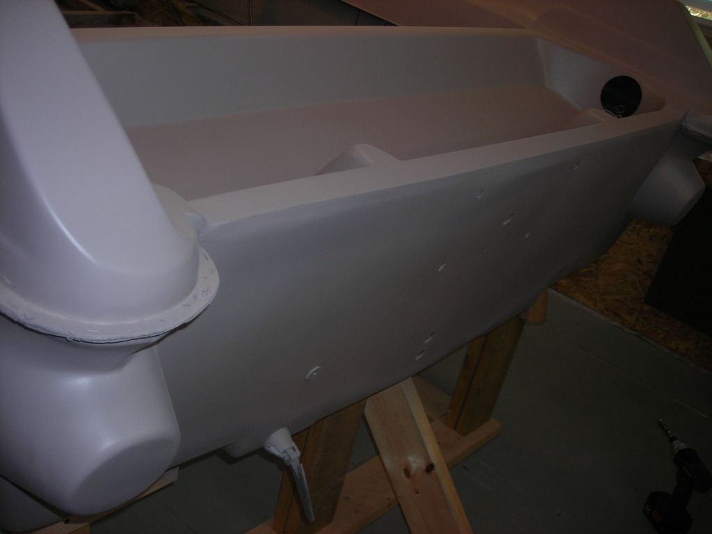

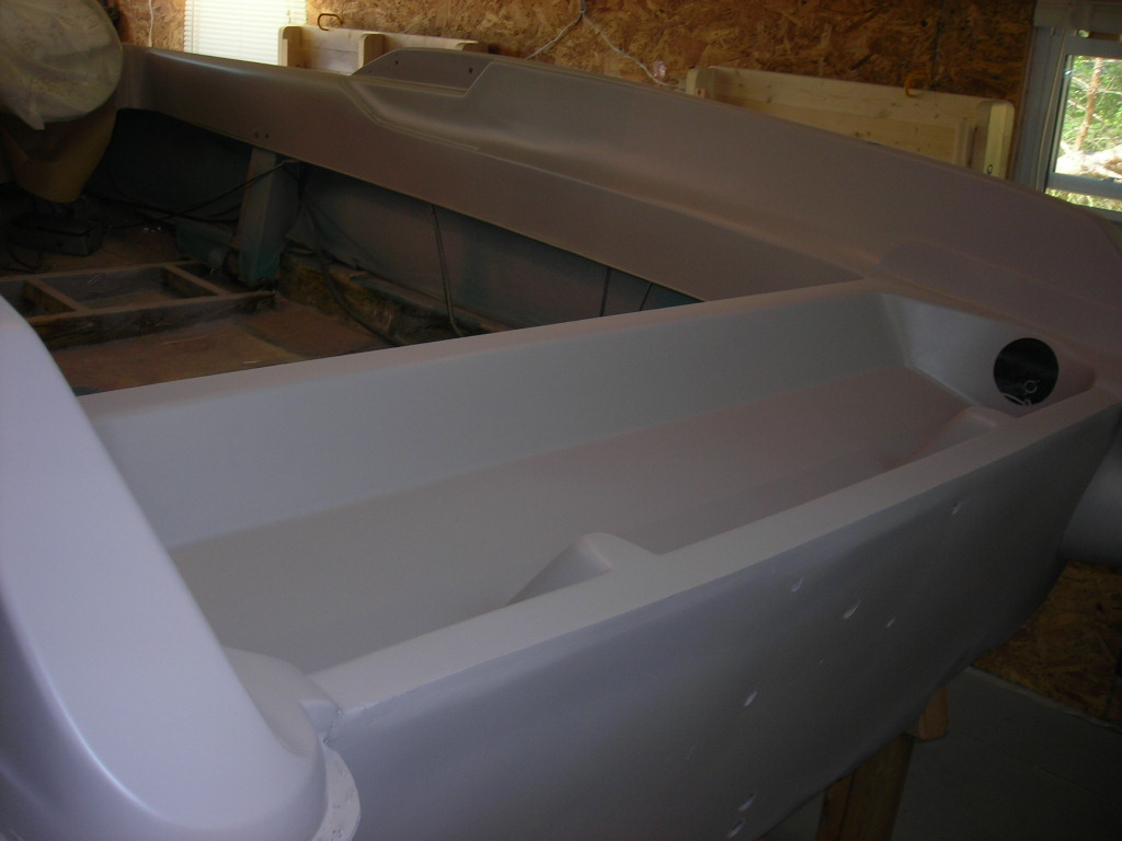

i finshed the white paint at 8:00pm,i tyred 3 differnt guns ,same problem i tryed everything ,then got my siphon gun and had it done in less then an hour,but i wasted too much paint trying to get the guns to spray right,so i guess im old school,i have to get more white ,i wet sanded it,im afraid it still wont look good after the clear.
tommorrow i hope to get the aqua teal and clear on with the siphon gun,the hvlps are going in the garbage.

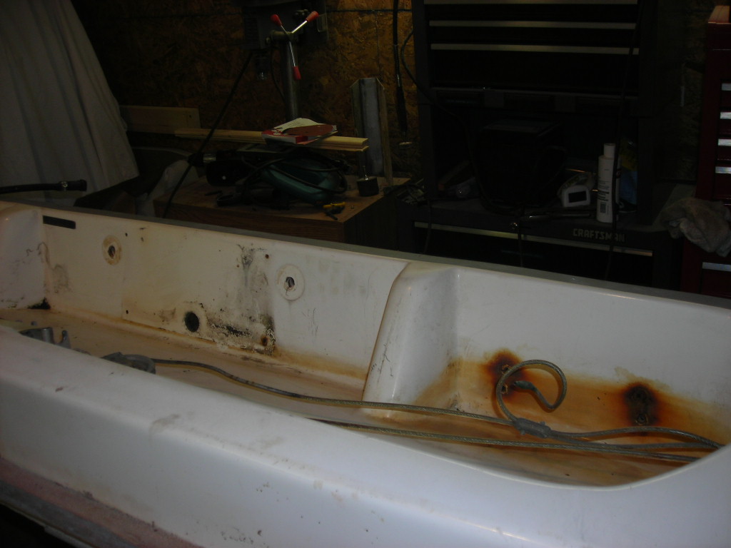

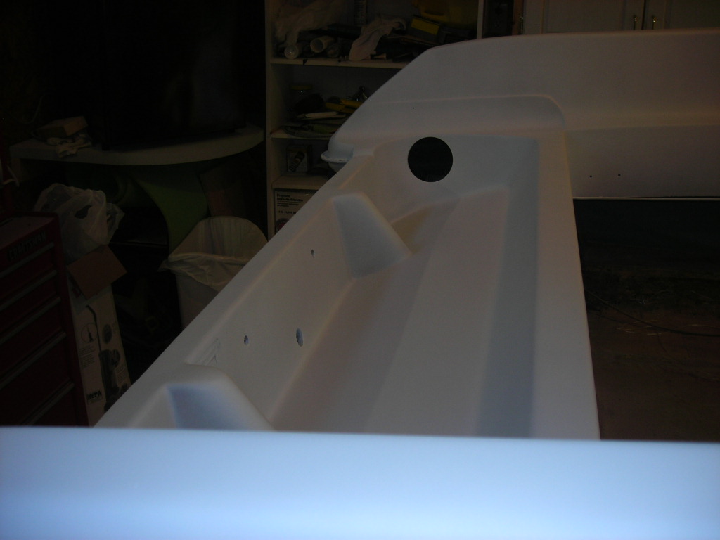

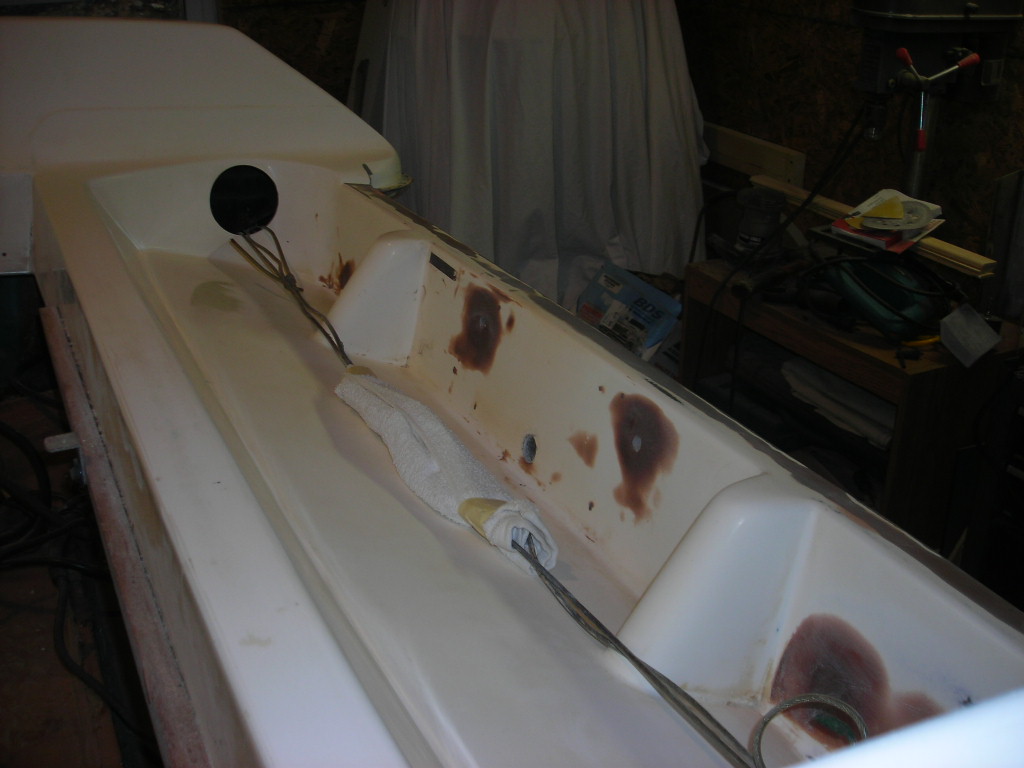

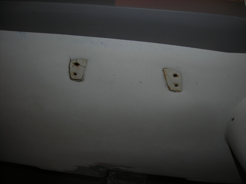

by the way here is a before and after shot of the spashwell,it had rust in it it took alot of sanding,and the transom was great except for where someone used the grab handles as tie downs.the wood was good but it indented the fiberglass and gouged the bottom because thats where the rachets banged and rubbed against it. john
