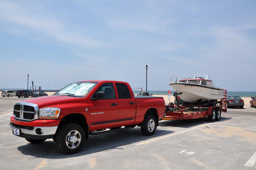

Like many of the other members here, we bought a 1960 Glasspar Seafair Sedan about two years ago that also had a very old trailer under it. Specifically, the trailer was a 1959 "Sentinel" with similar coil springs as yours has.
We live in eastern N.C. and had to go near Traverse City, Michigan
to pick up the boat. I asked the owner if he were towing the rig from Mich. to N.C. would he trust the trailer and he said; "NO!"
This trailer had the older style 10-12" trailer tires and I have had ALOT of trouble with them. So,....we decided to tow our 24'
"Kaufman" Flatbed from N.C. to Mich (and back) to get the boat and I am glad I did after seeing the trailer.
I had also contemplated keeping the old trailer, but issues getting the right bearings, those little tires and our desire to travel with the boat convinced me to buy a newer aluminum trailer.
Here is a picture of us towing our "new to us" Seafair Sedan back from Mich. on our flatbed:
