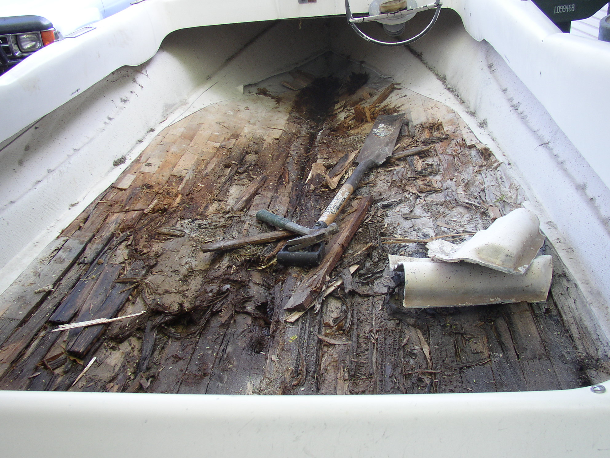

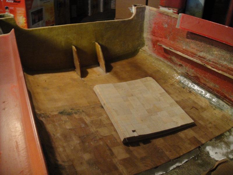

I started taking out the floor in my Red Fish and under the fiberglass cover is a solid wood floor. It appears to be mahogany and it is laid up in 2" strips about 16" to 6" in length, butted end to end and edge to edge and then covered with about 1/8" fiberglass. Only the tunnel in the center isn't wood. And every piece is as soft and soggy as balsa wood. I was thinking of using mahogany in 2" strips laid 2" or less apart. I would epoxy them in place and then use roving or heavy matting to cover them, also using epoxy. The space between the strips would allow the matting and epoxy to stick to the floor. This actually seems like it would be better than the original but I have never done this. Does anyone have an opinion on this plan? I am new to this and always open to a better idea.

Your boat has no subfloor or stringers right? Just the wood sandwiched between the main hull and a layer of glass? Most of the Redfish boats used a balsa core floor sandwiched in a layer of glass instead of a stringer and subfloor setup. I'm pretty sure if you try to go back with mahogany you're going to have a severe weight difference which may cause problems. Someone else will chime in soon I'm sure. BTW, what model is your redfish and can you post some pics?

Doug, thanks for the reply. It doesn't seem that 1x2" strips would actually make that much weight difference. I'm glad you said it was balsa because that's exactly what it feels like. I just didn't think it would be. I've never heard of that being used for anything except model airplanes. And to answer you question, no there are no stringers. I'll try to post a few photos and see how it goes.

Well I double posted and then only one picture came up. I'll try again. The boat is either a '59 or '60 and I'm thinking the latter. Mike.

Yup, that's a balsa core, alright!
It's common in boats, actually. I've dealt with lots of them in repairing sailboats. It's light and strong, but if (or should I say WHEN) water gets to it, It's over... Rot city.
You can replace the Balsa with more balsa, or I've also used foam- There are foams out there specifically made for that, If you google replacing balsa core with foam you'll find some answers. The foam will cost 2-3x as much, but never rots.
Mahogany would add a LOT of weight!

from the rotted floor pic it looks a lot like like a 17ft. offshore. look in research then redfish check out 1961 brochures. found out mine to be 1961 17ft offshore. bob
