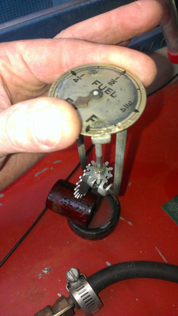

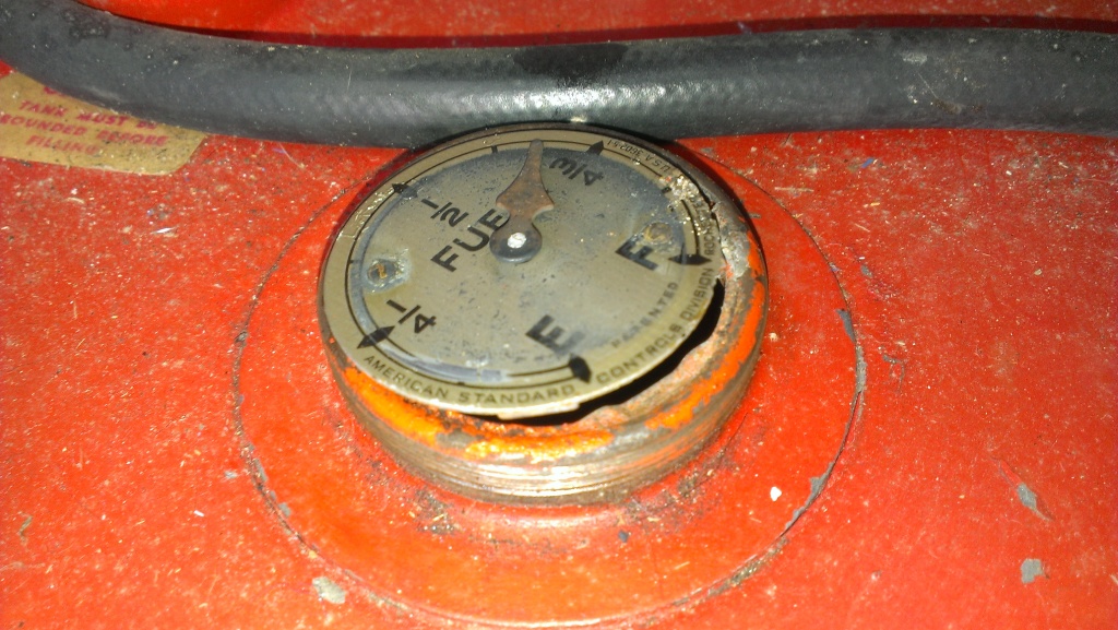

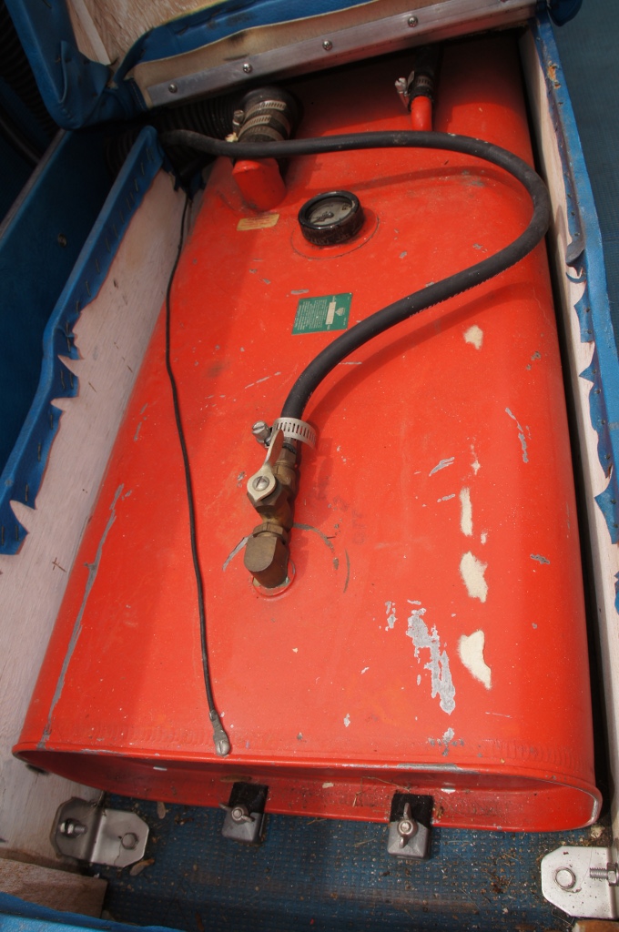

The fuel tank on my 68 MFG Chevron has gauge on the tank.

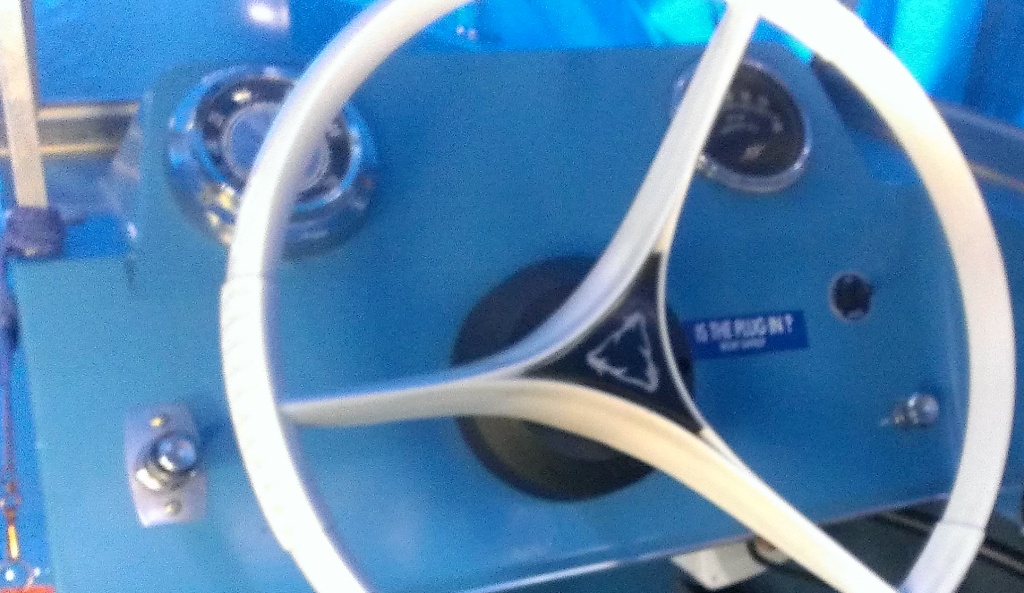

Is there a gauge i can put on the dash from that period? As you can see it just screws off. I was hoping to find something that would just screw on in place of the original for the sending unit, and a gauge for the dash to match the tach and speedo.

The tank is mounted. It's bolted to the floor under the starboard side seats and goes to a filler cap on the starboard side. I'll see if i can get a better picture of the entire tank.

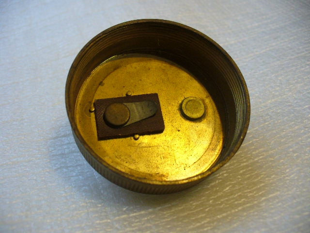

Hi,

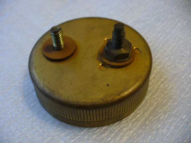

As suggested you can modify the fuel tank to accept a 5 screw sender, but I think that I would either modify the mounting flange of the new sender, or we have possibly the correct thread-on cap to which a new sender can be attached (see pictures). This thread-on cap is brass, and has an inside diameter of 1.9625 inches. The male threads of the fuel tank opening would be a little larger than this measurement I would think.
Regards,
Joe
www.fergusonpoolemarine.com

Joe,
This is along the lines of what i was thinking. Something i could screw on to the old tank where the old mechanical gauge connected. I'll measure the threads and get back to you.
Once i used that cap i would connect any new sender to it on the inside of the tank and then connect a matching gauge with the correct ohms?

Re:Fuel Gauge 13 years 4 months ago #77578
The flanged threaded piece on your tank the fuel gage is threaded to is called a bung. Yours is most likely soldered on to the tank. If the flange is the right size, that bung could be cut flush for a 5 screw type. It would be great to find a bung mount sending unit that would just screw on what you have, like the Joe posted but you would need the float to go with it.

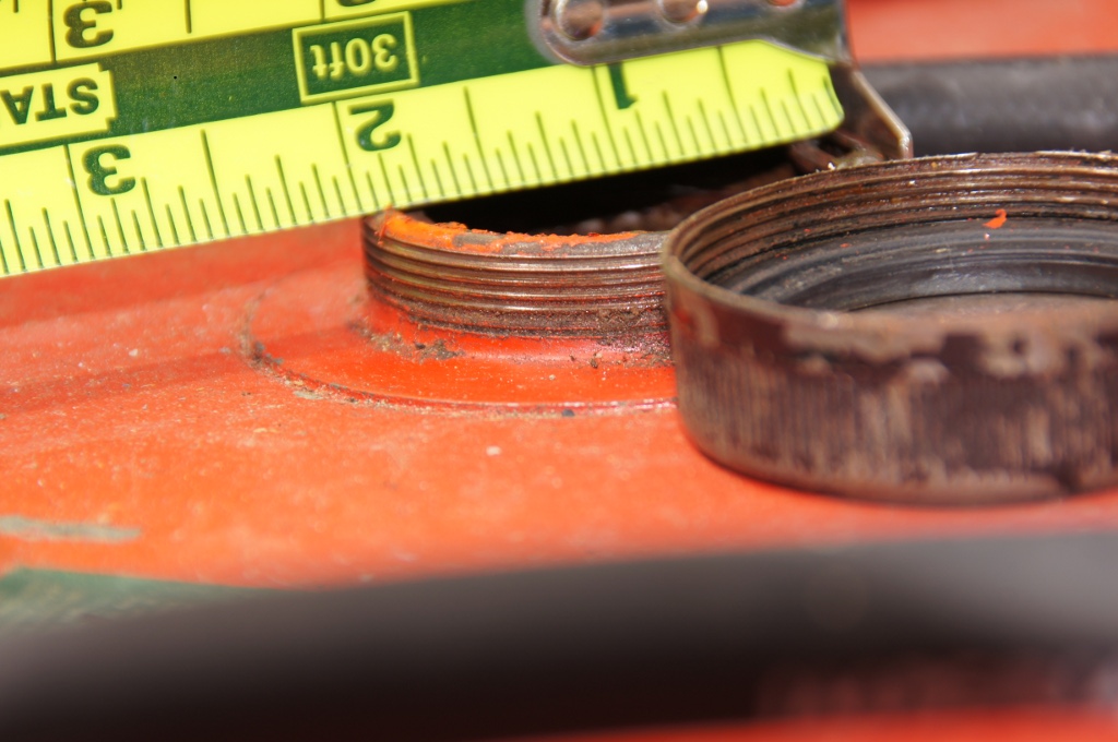

My tank is 36 inches long and 6 inches deep. I was told it's a 12 gallon tank.
The bung is ~ 2 inches. Would that fit the cap show by Ferguson_Poole?

That cap worked. Sorry it took 2 years to reply!
My real reason for posting is to see if anyone knows where I can get a similar under seat tank. Took the boat on vacation and would have liked to have more time between fill ups.

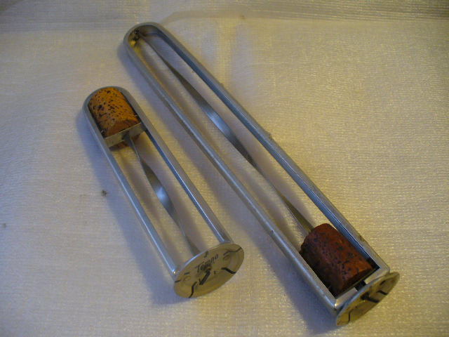

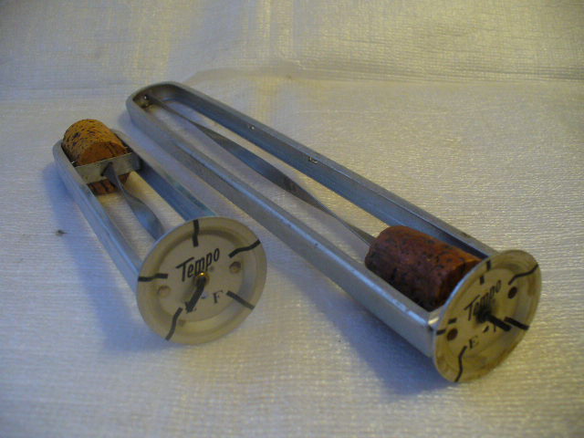

Fuel Gauge 7 years 9 months ago #138598
Happy New Year All!
Antoine, I hopefully was successfully sending you an e-mail. We do have two lengths of new old stock mechanical fuel gauge units for a bung type mounting, and depending on the fuel tank's depth.
Best,
Joe
