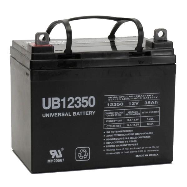

Buy a used Wheelchair battery.
Medical mobility companies that service electric wheelchairs replace the batteries on regular intervals - regardless of condition. They do this to prevent someone from being stuck on RR tracks etc., with a faulty battery.
Most sell these perfectly good batteries to battery recyclers for 5 bucks each. This is no joke.
I bought a used wheelchair battery 1 & 1/2 years ago from a battery place for 15 bucks. It was load tested and guaranteed for 30 days . Well, it's still going strong.
The battery is about the size of a large kid's lunchbox. It is sealed lead acid, so it doesn't outgass Hydrogen, and it can't spill in the boat. The plates are designed for rough service. I used it last week to jumpstart my V6 Dodge that had a completely flat battery. The little wheel chair battery hadn't been charged or used in 4 months.
How can you beat that for 15 bucks? As long as i can get them, I'll never buy another new battery for my outboard boats.

Well I'll be darned, never thought of that. I had a buddy in a wheelchair too! You're saving about what, $50 or $60 a battery and still getting a "deep cycle", I like it. What's the physical size and weight like Bruce? Comparable to regular, or smaller?
Re:Battery suggestions 16 years 5 months ago #7741
Roughly :
W = 7.5"
D = 5"
H = 6.5"
Weight is around 15 - 20 lbs
I bought stainless steel 1/4 bolts with stainless wingnuts for the posts. Hooks right up like a marine battery
