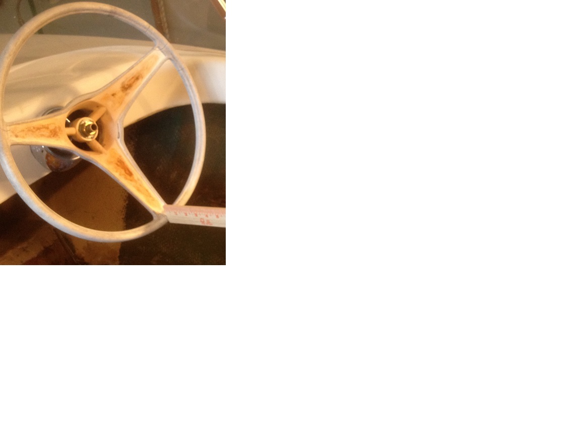

This is probably right up John's alley but I'll toss it out for anyone who refinished a wheel.
I have a plastic steering wheel that is currently really stained and discolored white. It's a rope design wheel with three spokes. One small crack in the plastic where the spoke meets the wheel part. What's the best way to prep the plastic? Sanding? Primer? Filler for the small crack? Enamel or lacquer?
Cal

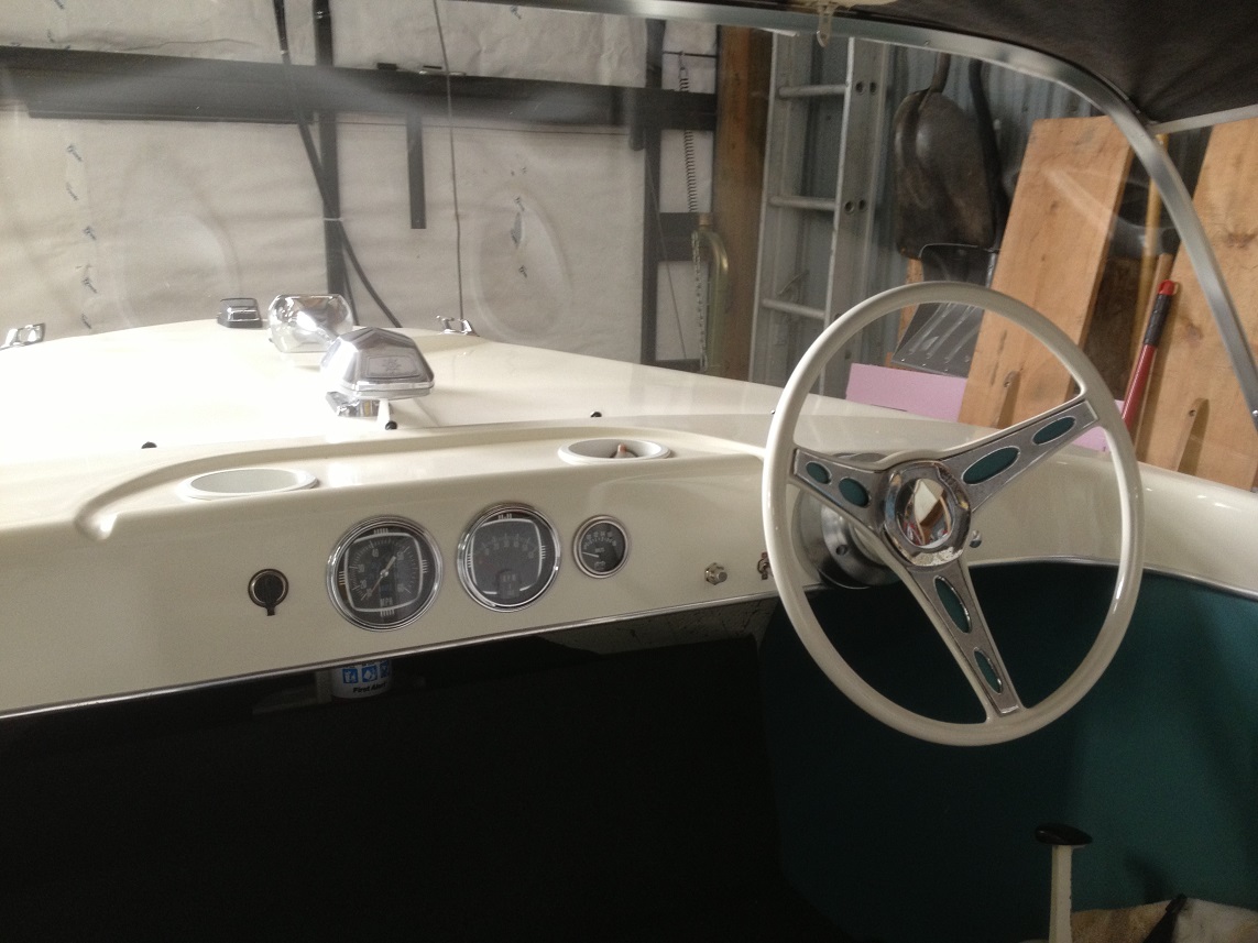

I just refinished one that came out rather good. I sanded it then patched all the cracks with epoxy mixed with a sandable filler from West marine. Then I sanded it smooth and painted it with Rust-Oleum Ultra Cover 2x primer. I used that primer because it bonds to plastic. I then painted with spraycan enamel for color. It turned out looking great, but I cannot say how durable it will prove to be as I have not used it yet.
before and after
