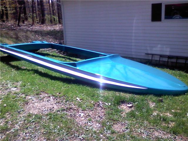

I painted mine with Summit Racing brand Paint 89.00 a gallon Activator 19.99 Reducer 9.99 a quart Primer 59.99 a gallon plus the activator. I used some high build primer 79.99. Then you gotta think about the fillers and all the sand paper I had a mountain of that used. I had to use some fiberglass cloth and resin. I used a gallon of clear too. I changed some body lines on mine, this ran up the cost of fillers and time. I would set back 500.00 to get started. I would paint it yourself it's so rewarding to see the end product and tell everyone I did this it just takes time can't rush perfection. Here is a pic of my top half I did self taught for tips here and friends.
