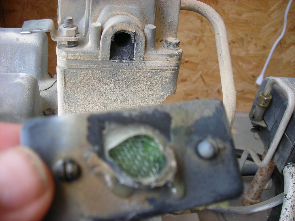

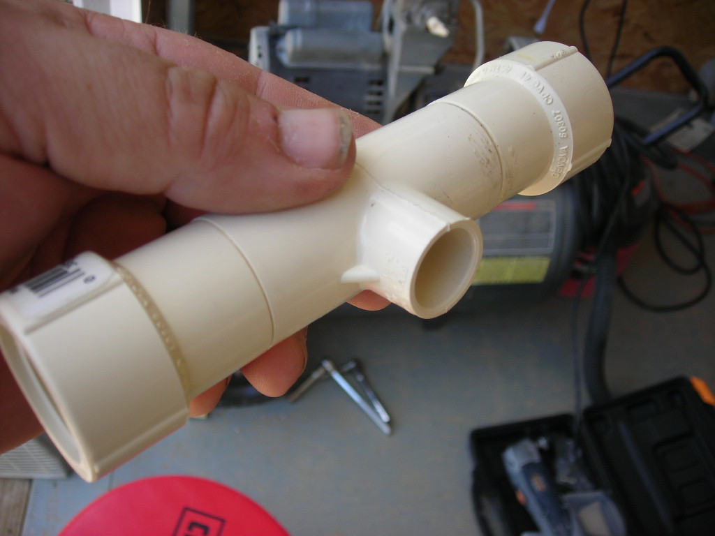

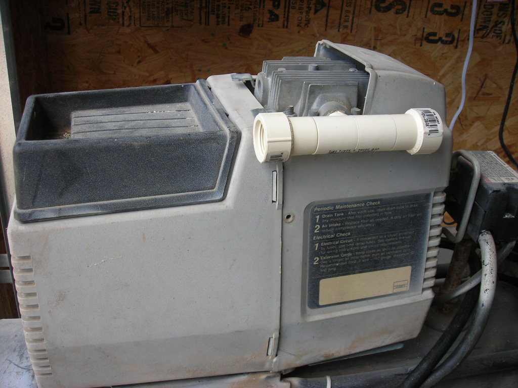

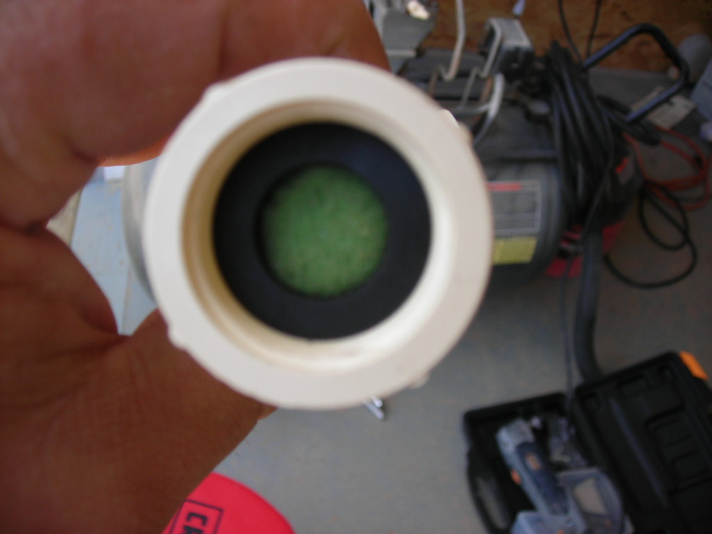

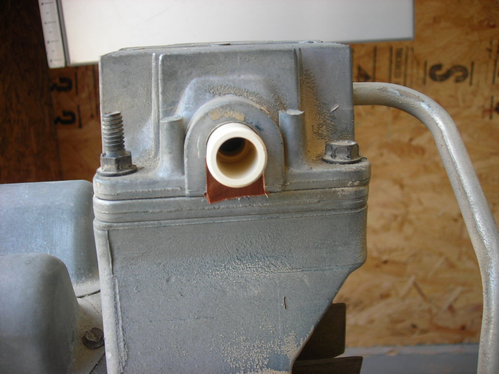

it will probably turn into a mac gruber moment,lol,i have to paint the sunray and for the 2nd time my air filter holder broke off and cant find another in time to paint the boat so i got a small piece of 1/2 inch pvc water line and a 1/2"x 3/4" adapter,with screw in 3/4 adapters,so far its working,but i had a macgruber moment when i didnt put screen behind the foam,it sucked it in ,but only to the 1/2"part,thank goodness,lol,it seems to be taking the heat ok for now,it should work,john

my computer went down,heres the rest of the pics.
