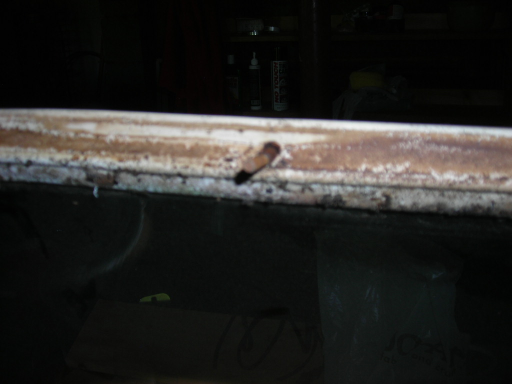

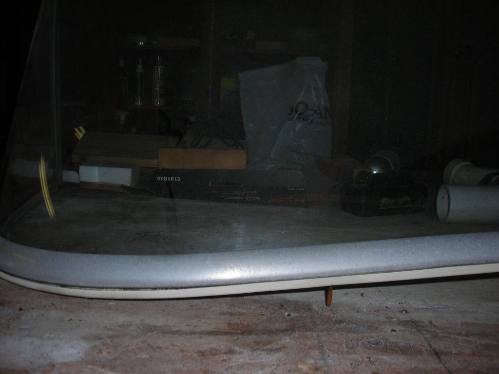

hi guys,i figured you guys would know what i need,i need the windsheild bolts for the 64 custom craft sunray,the bolts are still in the windsheild,i havent had time to take them out,but a few broke off when we removed the windsheild,they are stainless but the nuts were not,i cant tell what they look like yet but im running out of time ,i need to get this thing painted,does anyone have a few of them and if not do you have pics of what i need?
thanks in advance, john

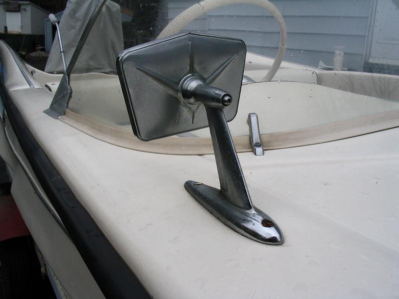

john, here are what mine look like.no idea where to get them though.

John,
are you talking about just the screws or the little brackets ?
like the ones Ron pictured?
here is a picture of the little brackets, i can go see if its still there.
can you tell me if you can get to them under the dash?

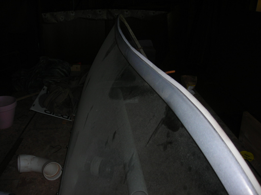

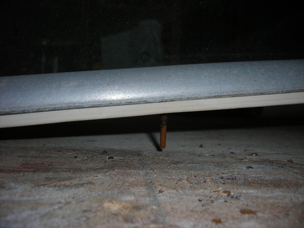

ron and ken thanks for the quick responce,but my windsheild is set up differently,it has a channel (the white strip at the bottom)that the bolts go through,there are no brackets,i guess i will have to take it all apart to see what they look like,im just runing out of time.
im just guessing but they probably have a square head so that they dont turn when you tighten the nuts on them.john

ok, sorry i misunderstood what you are looking for
probably just a plain T bolt like in moldings for cars.
if all else fails could just take a regular bolt and grind down the head to fit?

Those are t-bolts John. Brian Lawson just bought a bunch of them somewhere for the rub rail on double-wide, his 18' Power Cat. Man o man is that thing double wide! Whew!

John - Lowes doesn't them. You can buy them on line at www.rockler.com . I've been buying 5/16" x 1.5" Check your bolt, they have smaller. Also, you need to pull the lower gasket and check to see if it uses T-bolts. I WILL check my Manta Ray windshield tonight to see what that uses. Been so long that I took it off, and so many boats ago, I can't remember.

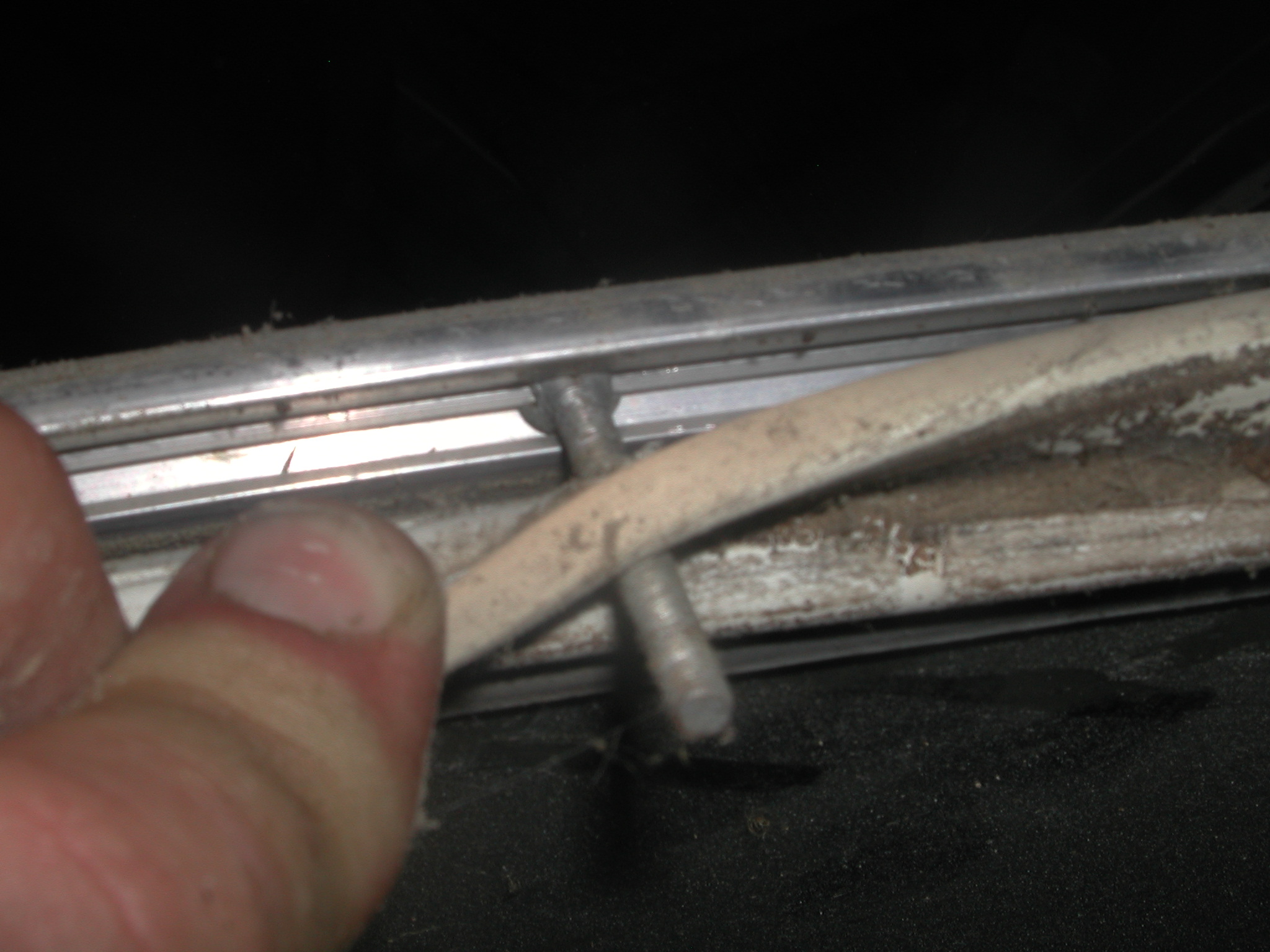

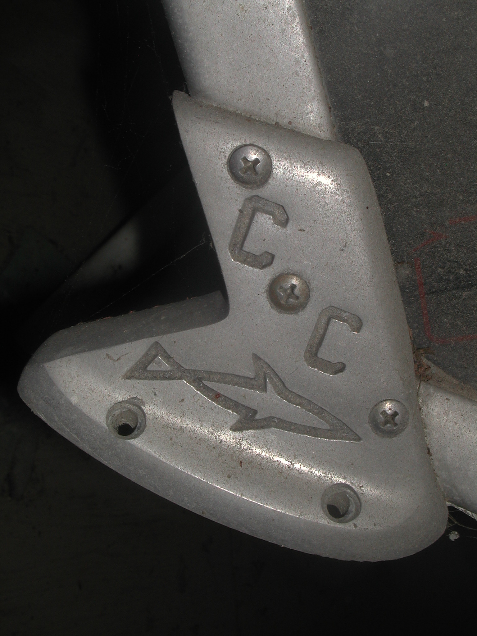

John - Attached are photos of my CC windshield that goes with the Manta Ray to Doug Young. Most definately you need T-bolts, but smaller than I've been buying for the Power Cat rub rail (5/16 x 1.5). I didn't back one out, but I'd guess smaller than 1/4" and maybe 1.5" long. I'd check www.rockler.com and buy a couple of sizes and return what you don't need.
