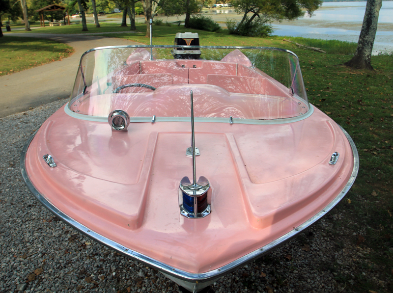

Great job - looks beautiful.
Is this an old Glastron?
I have a 1960 Glastron fireflite (my dad bought it new!), and the bow light is the same as in your photos. My bow light is broken - both lenses gone, and the lower metal part is broken. The lenses have to have a curve to them. I am thinking of starting with some clear acrylic and heating it to bend and then add some thinner colored "gels" for the red and green.
Any ideas on where to get that same bow light? Was it an exclusively Glastron part or was it more widely used? Ours does have the little mast for a banner. Some of your earlier photos do not have it, and the final one does. - ?

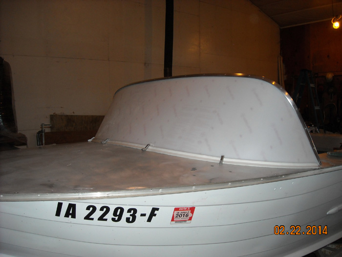

Here's my windshield I just got done for my '60 Starcraft Jupiter. It took me about 2 days. Just went slow. I used a grinder with flap disc to remove extra material on the corners. I still need to paint the bow so will leave the protective plastic on till it's time to go out on the water. Thanks to Andrew for his great instructions.
