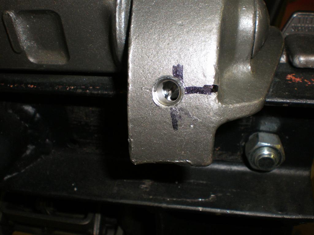

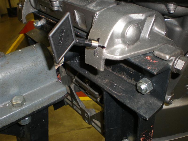

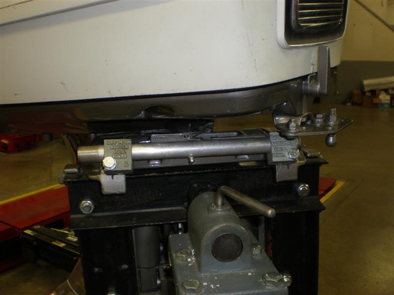

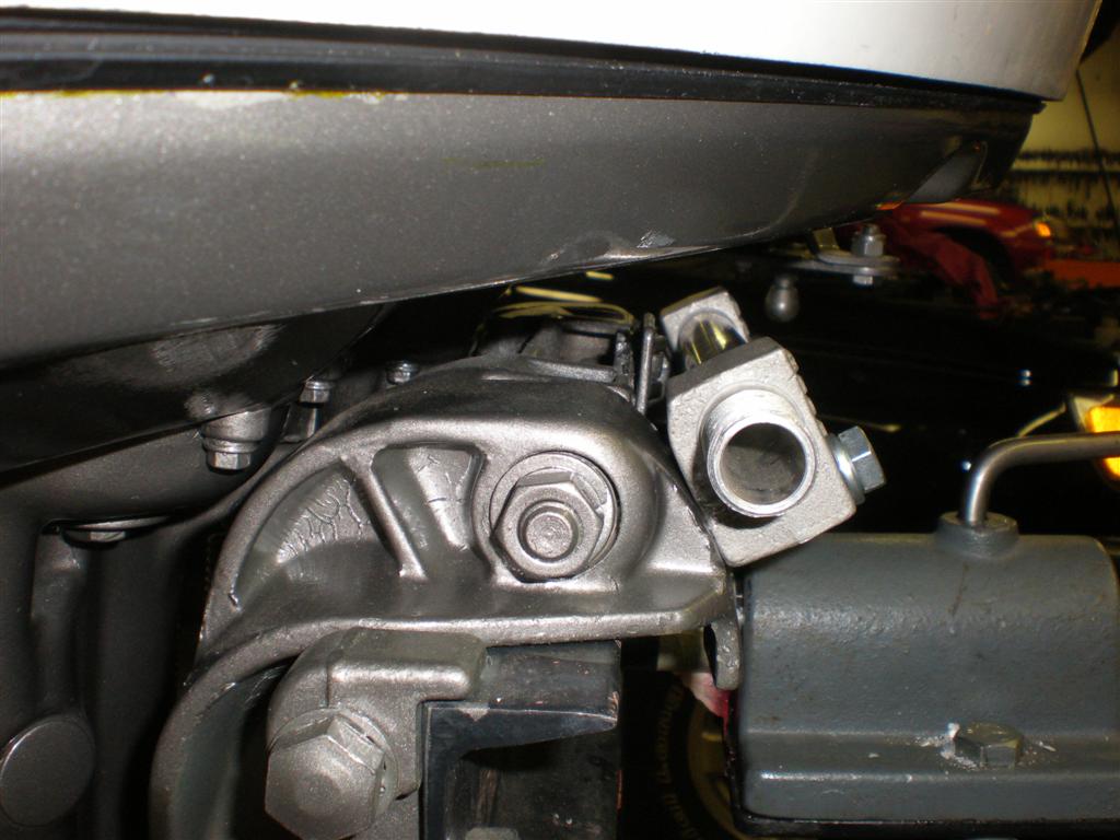

Adapting a tilt tube to an older OMC outboard. The tilt tube and bracket are commonly available and used for adding an extra or dual cable to a motor.I bought mine off eBay for $20.00 it originally attached with u hook clamps. You could use a generic tilt tube and make the brackets out of aluminum.
