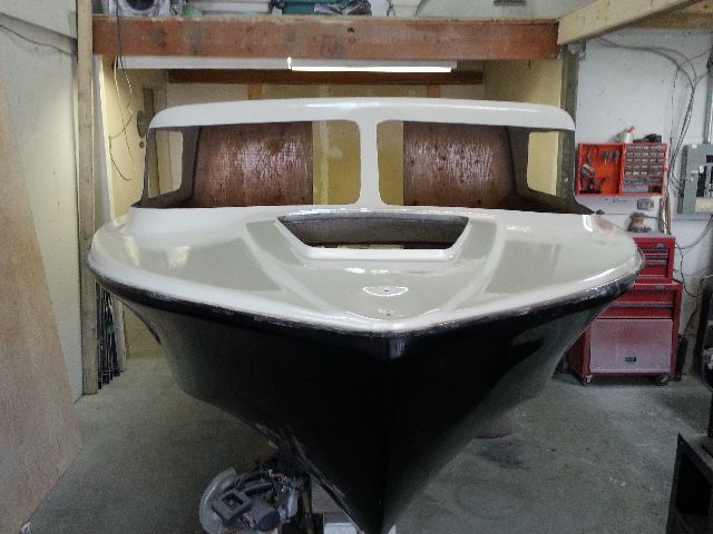

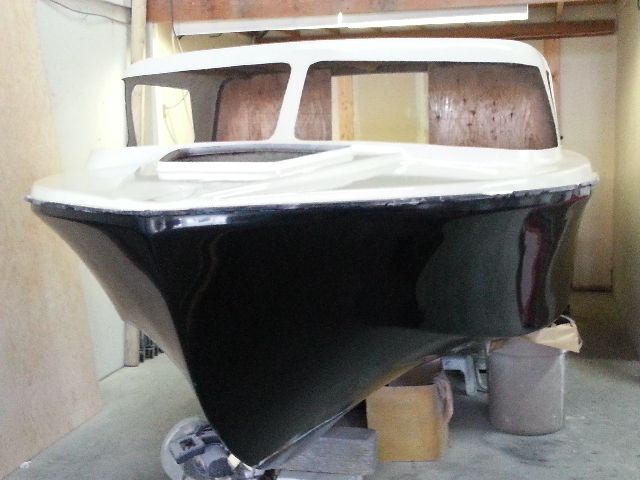

Well I got the top side painted , just have to sand and polish.

Looking great! Can't wait to see it on the water! I'm restoring a 65 Dorsett Catalina myself. hope to get it finished by April! Where are you located at? All the best, Monte

No the hull doesn't have balsa core just glass.But I am reinforce it with couple more layers of fiberglass as I am going along.I also going to fill under the floor with foam I know some don,t like it but I have use it and love it.She is a long way from being done but I am keeping her,so as much work I put in her I will love her more.

She's looking great! On suggestion would be to make sure there's a way for water to get by the foam and back to the drain in the transom.

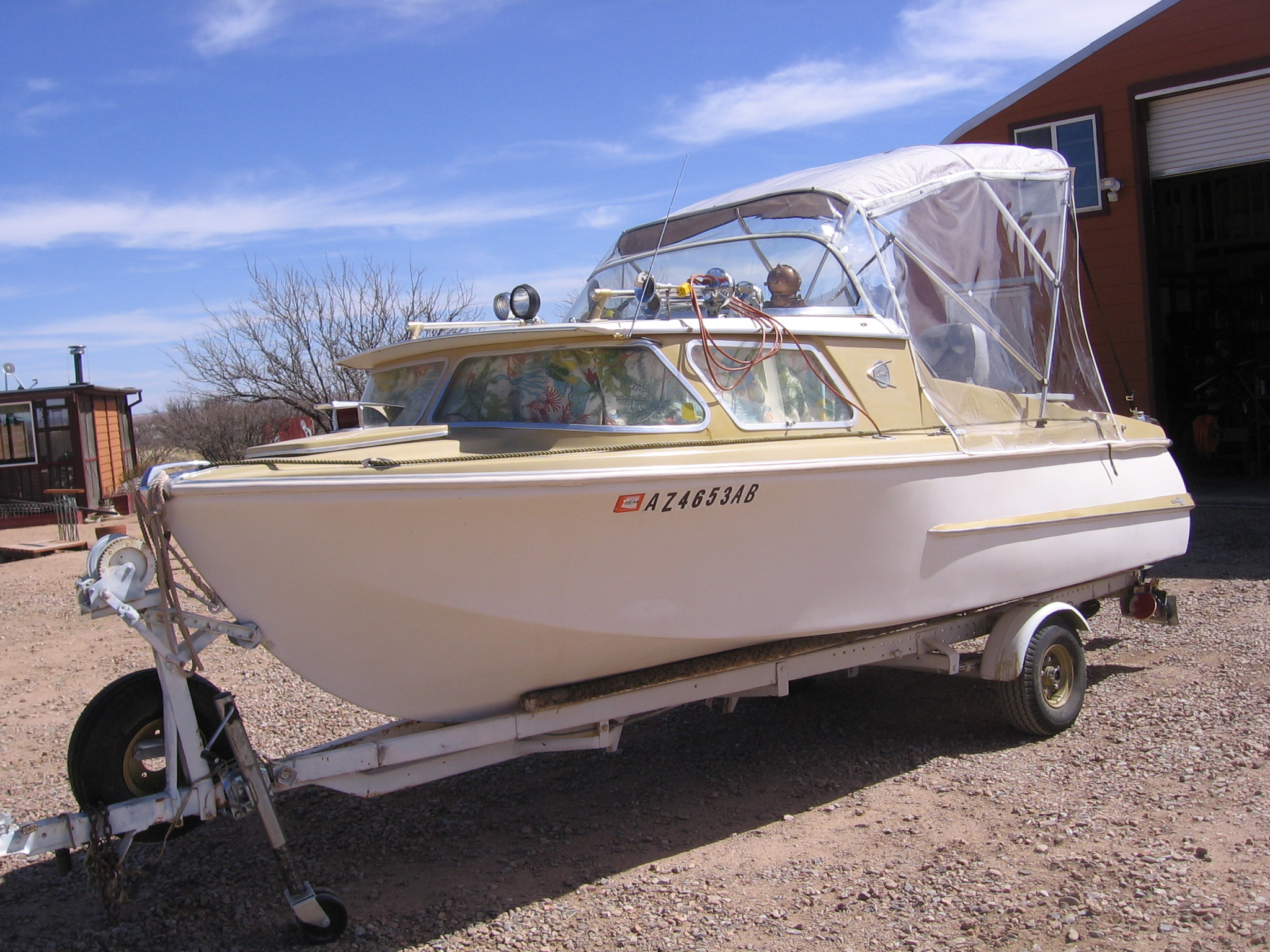

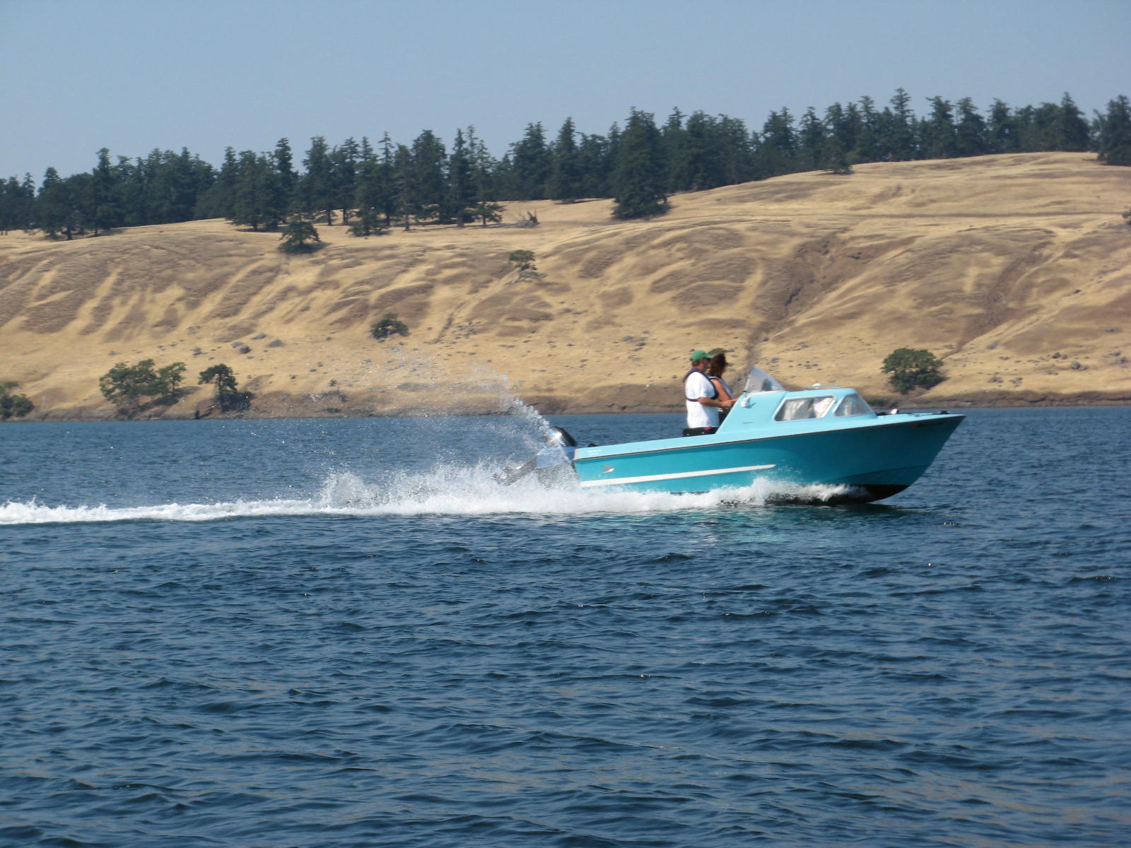

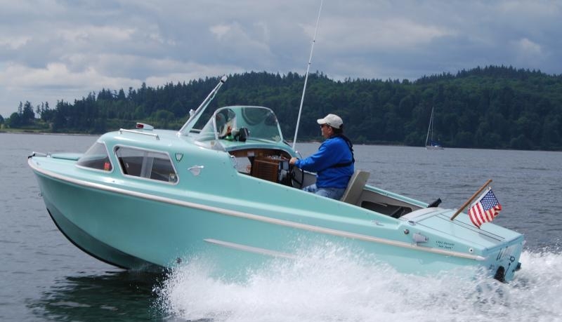

Dyna Plane hulls do ride better in choppy water - I have had both. I like the looks of the Dorsett during the Raymond Loewy era 1959 1963 best. They have the best lines - jmtc
The first pictures are my 1964 Catalina with an 85 H.P. "FRANKENMERC"

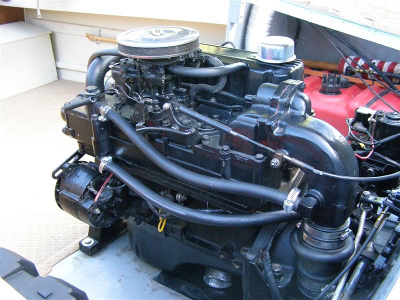

next is my 1962 San Juan - factory inboard 130h.p. Mercruiser " Iron Duke"
Commander - looking good - any new progress pictures ?? Sure liked the wood work you did on your San Juan "Trailer Queen "
