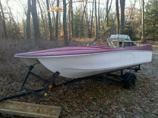

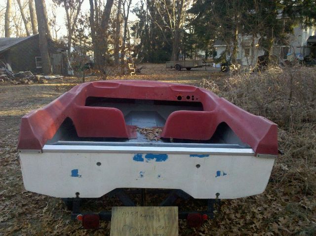

Starting to get a plan together to get this restoration going in 13'
What I'm thinking of starting with 1st are twin 64' 650's. I need direction on how these motors need to be set up. Also trying to figure out the twin control set up. Would like to see pics of other completed boats for possible ideas.
