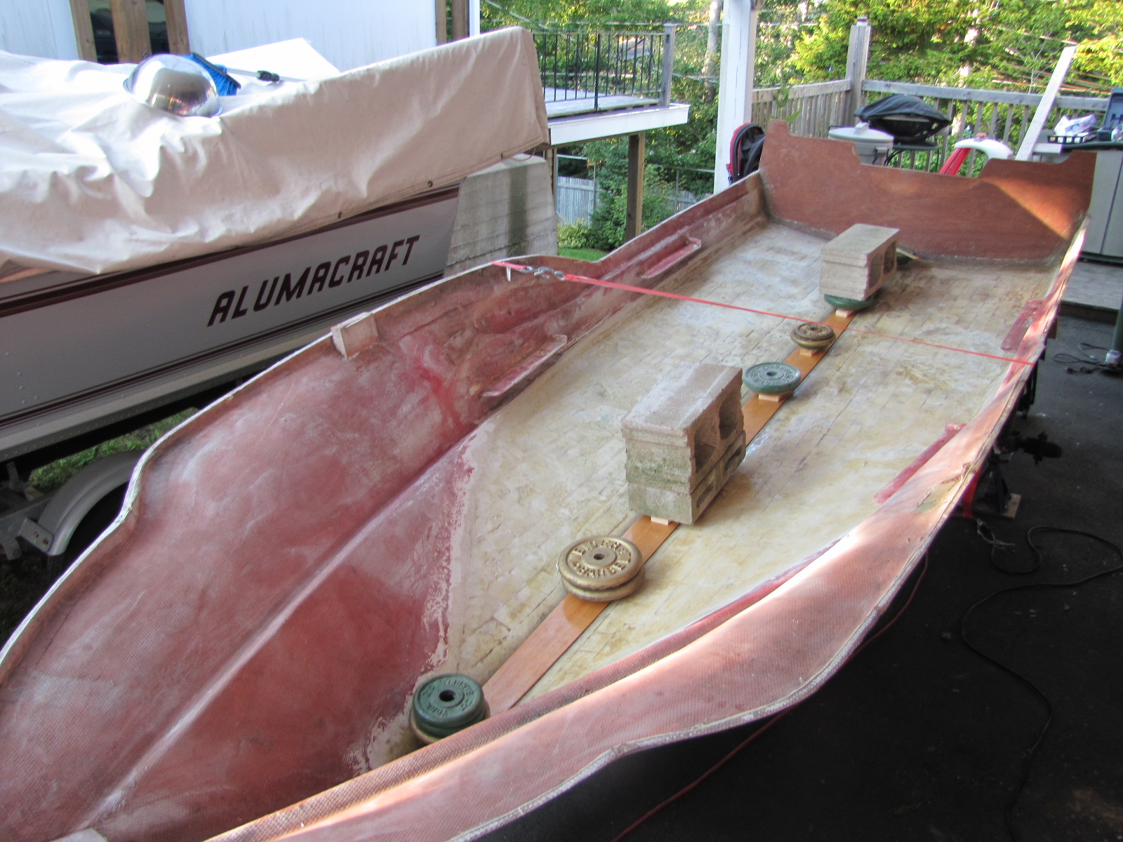

For all you glass experts out there. I have a new keel strip and transom installed in my Redfish Capri. It is now covered and in my carport for the winter. I noticed recently that a small amount of water got in and froze over the new glass near the transom area (still only matt there).
My question is this: Where the water was, the resin has taken a cloudy white appearance. I am sure that no water actually got through to the wood below, but am just curious why the cured poly resin has taken a chalky appearance where the water was. Any thoughts?
