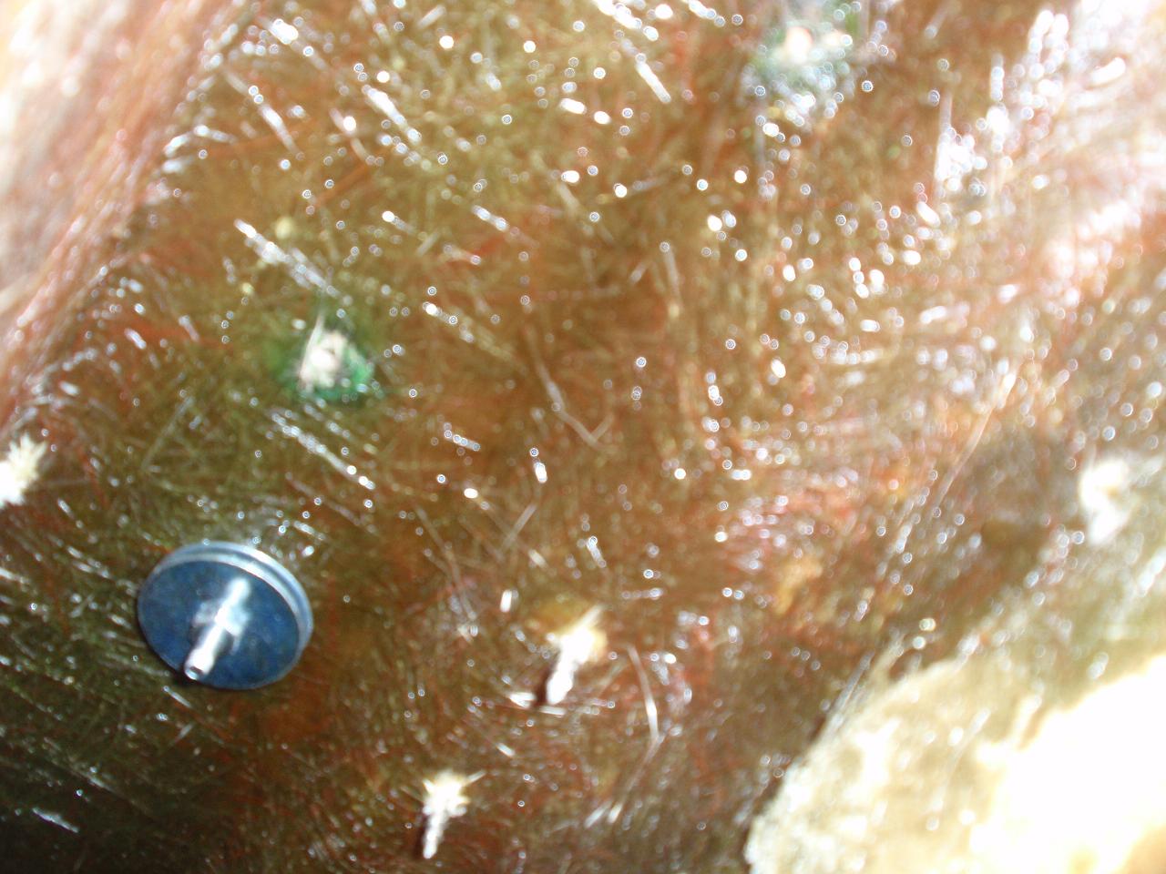

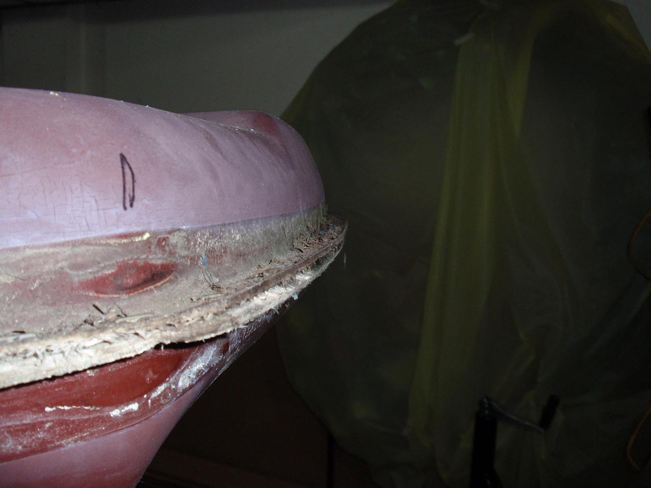

There is a third way the two halves are put together. On the Shell Lake project I am currently working on the upper and lower were sandwhiched with a 1"lip and then stapled and that covered up with one ugly thick bummp rail. In order to accomplish what I have for my project I trimmed the lip off essentially making it a butt joint, glassed the seam from the inside and then used 5200 slow cure on the outside mahogany and that whole configuration is through bolted (and plugged) with fender washers on the inside.
This is the sandwhich seam before trimming.
Here are pics of the inside and outside after trimming the lip off and glassing the inside butt and adding the through bolts and fender washers.
