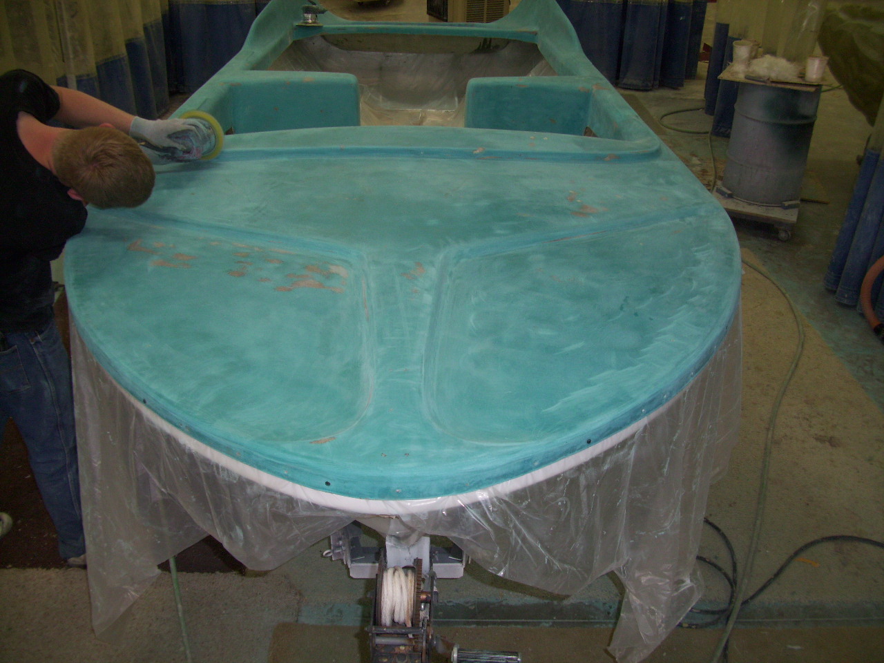

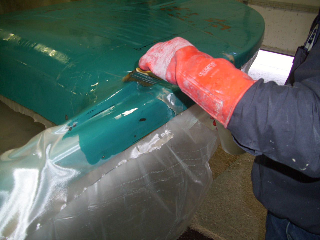

One way to go is to sand it down to remove the loose - soft - degraded gelcoat, then lay light - 1.5oz - fiberglass cloth over it onto which you then brush a coat of resin. This provides a second skin that resists future cracking and crazing. You then apply a heavy filler primer such as Duratec which you sand down and repeat till you have the surface you want.

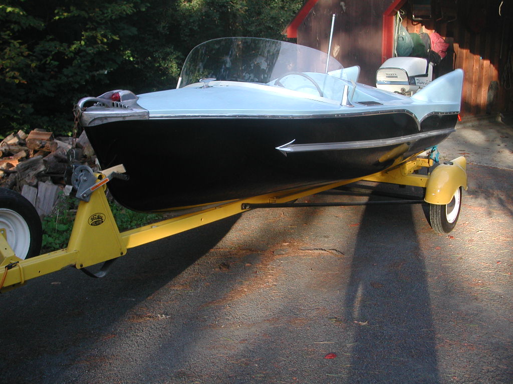

Crosby....nice boat!!

Thanks Crosby!

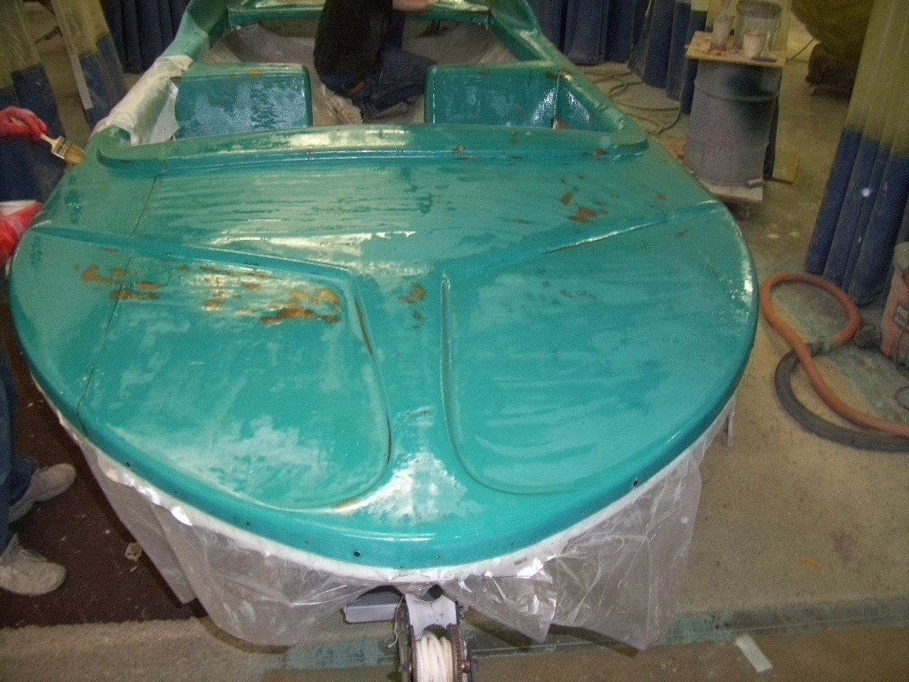

Looks like you did a nice job of laying that cloth down...
