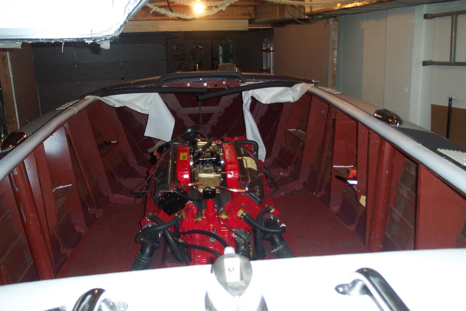

Me thinks we're talking apples en oranges here. I'm under the impression that you're replacing the fiberglass floor and sealing it so no water can get in. On my woodie (avatar) I have several vents with a blower in the bilge to clear out fuel vapors.
Satx is correct, you can blow a pretty good hole in the water with a vapor mishap but in this case the floor would be filled with floatation and then sealed. Any fuel spillage from your portable tanks would be on top of the floor near your drain plug, right?
Hope you don't mind that I copied your pic from the gallery for reference. She looks like a beauty and a fantastic job!

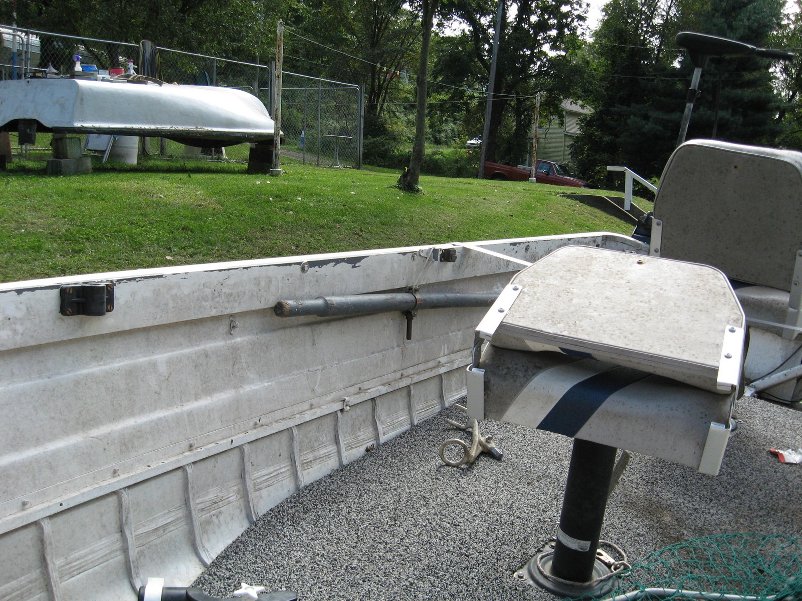

If you look at this picture while I was restoring the Sabre you can see the metal vent pipes on the sides, follow the chrome intakes down.
Re:Advice needed on venting sealed bilge 13 years 6 months ago #72074
Sabre, you hit the nail on the head there with what is most likely the best vent setup yet.Sealed floor and venting. The best of both worlds. Skip.

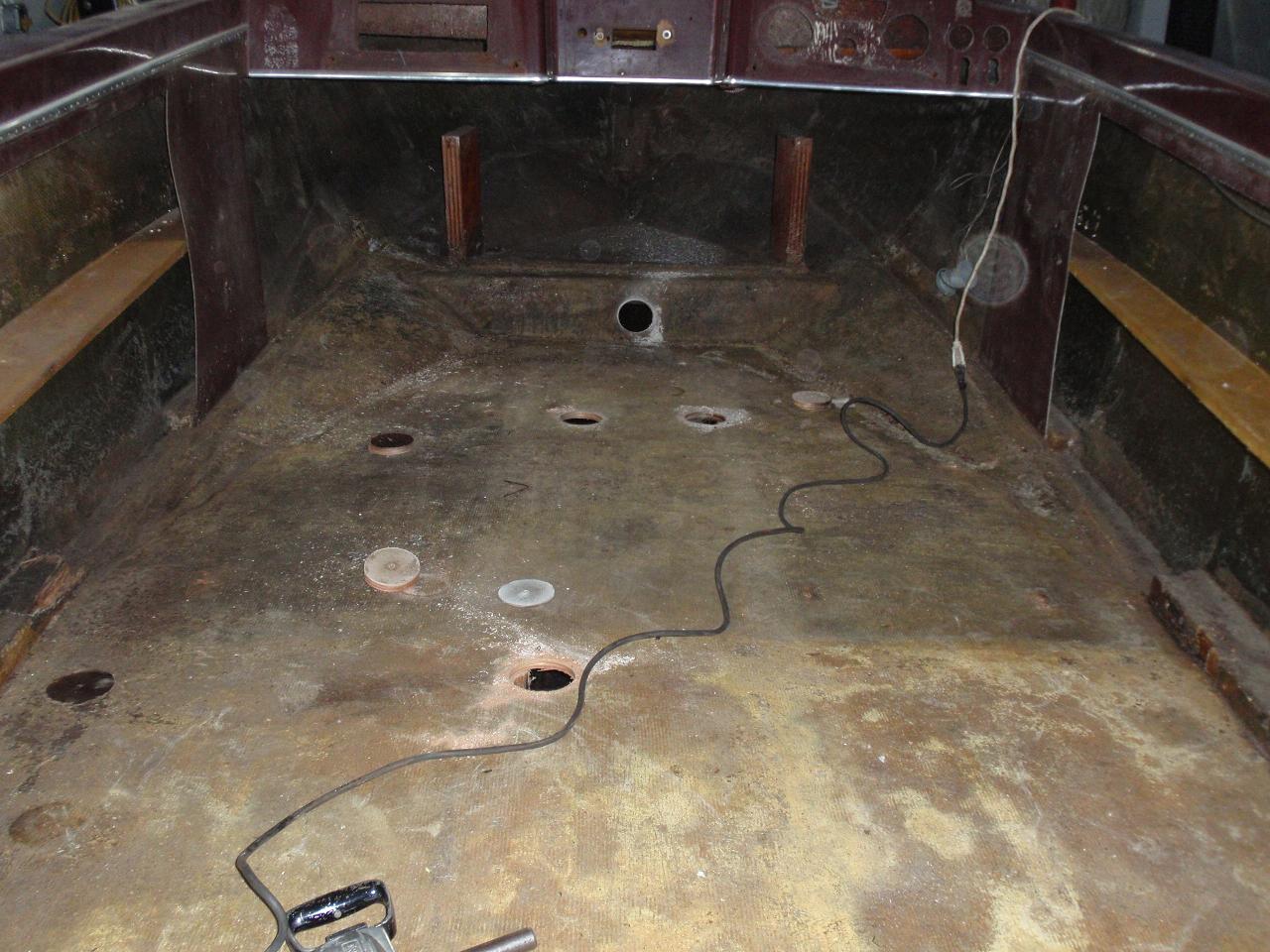

So I'll wade into the fray. I have done boats a few different ways, two of which are similar to what you are asking about. As a disclaimer I am a big fan of ventilation under the floor and not a big fan of foam but all that said anything done right is OK. Most of the issues we see with old boats are due to workmanship, poor design or poor treatment of the boat. All can be corrected during restoration and during ownership. In general I try to stay true to originality so that limits what I do vs. what I prefer to do.
First off though one thing that has not been brought up is that you cannot totally seal your floor. If there is an air space anywhere this air heats and cools which would raise and lower the static pressure in the area below the floor. This will bulge out and suck in your hull, so in my opinion you need to ventthis space somewhere. Two of my restorations each where originally done with "sealed floors" an MFG Edinboro and a Glasspar G-3. It should be noted despite being "sealed" they each had a drain plug to "drain" the area under the sealed floors. They also both had a small tube, about 3/8 inch diameter up towards the bow that would let the pressure equalize as temperture changed. The tubes where sealed to the floor at the bow and the tube raun up to about gunnel height.
What I did when I restored each was a little different I did the Glasspar G-3 first it was 63 so it had the fiberglass corrogated stringers with no foam and a 1/4 plywood sheet for a floor bonded on top of that. I eliminated the drain plug below the floor, kept the vent tube in the bow and put a 6 inch screw in inspection plate into the floor near the bow on the raised shelf under the front deck. The raised shelf was created because it extended from the foot rest top wo it was sort of a triangular raised area under the front deck. That vent tube vented below this raised area but all the under floor areas were connected.
Were the tube and the inspection plate are up high and towards the front and under the deck I am not worried about significant water entry through these areas. I unscrew the inspection plate tipping the boat bow down and look for any signs of water entry and leave it off to let this area "vent" in case of moisture build up (or possible gas leaking through a crack). This is a 15 year old resto and I have seen no signs of water etc. During winter storage I just leave the inspection plate off. So I guess it's not really sealed but does a good job of preventing water intrusion and gives me a way to keep an eye on things and vent it once in a while.
The MFG was similar except the corrogated stringers where alternately foamed so there were air channels from the under stern area to under the bow area, honestly I'd be happier if it wasn't foamed as mentioned foam will absorb water if allowed, particularly the foam used of this vintage. (yours should be closed cell and a better material) I am well aware of possible advantages of foam and it does make the boat quiet. When I did the transom I was able to check the foam and it was dry, this boat was particularly well treated, the transom rotted out through poor sealing of the motor bolts and unsealed transom top. On this boat I left the vent tube and the underfloor drain plug in place and I added the same inspection plate to the similar foot rest raised area under the deck. I can keep an eye on things and provide ventilating from time to tim. 4 years on this one all is OK.
I am meticulous about any floor penetrations being sealed. I did molded in cleats like yours for the tanks and the battery to minimize fastners.
Another area overlooked is the drain tube, this area is frequently rotted on older boats because water can wick between the tube and the hole it is pressed into, this prevents water from getting in the boat but unseen water can wick into the plywood.Sealants don't work well becasue the tight fit wipe it off during instal. I have a much larger hole in the wood so I cna use thickened epoxy to fill it making a plug of epoxy which I drill a wee bit ovesize and then bond in the tube, this eliminates any wicking to the wood in this area. I do the same for the motor bolt holes and stern eyes. For these I make the hole a wee bigger than the thread diameter and use 5200 to seal it to the epoxy plug.

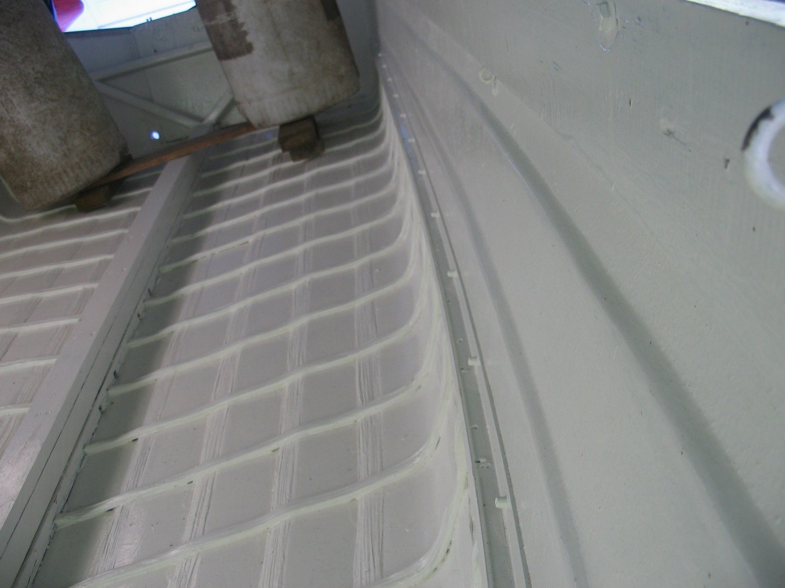

Randy, great discussion. You answered a puzzeling question I had since I started working on my 63 Shell Lake. In the bow area peak on the raised area there is a small tube molded into that area that sticks up about 3" and the bilge cavity is void, no foam. Maybe that's why the bilge and stringers/floor are not rotted out. A little soft around the floor drain plug that I am cutting out to replace. Thanks for the enlightenment.
Cal
You can see the raised area I am refering to, sounds exactly like yours.
