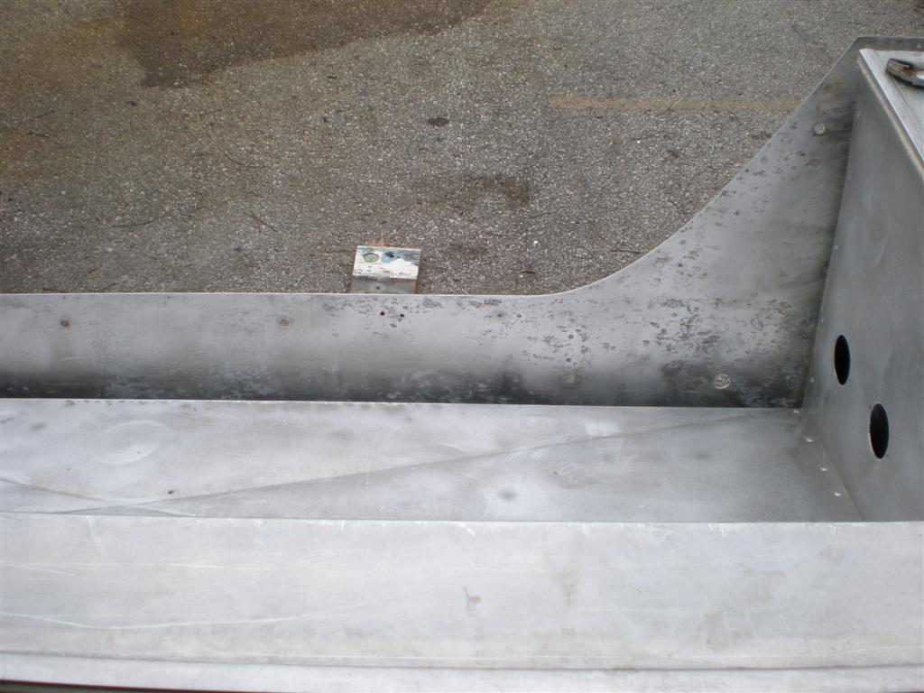

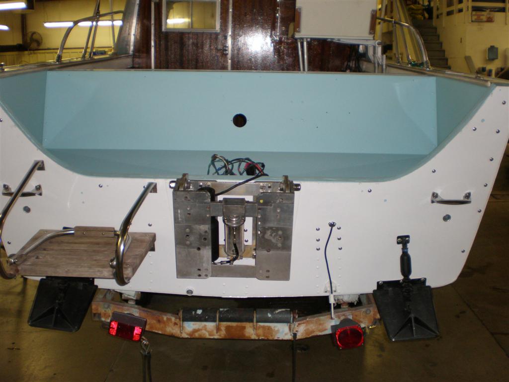

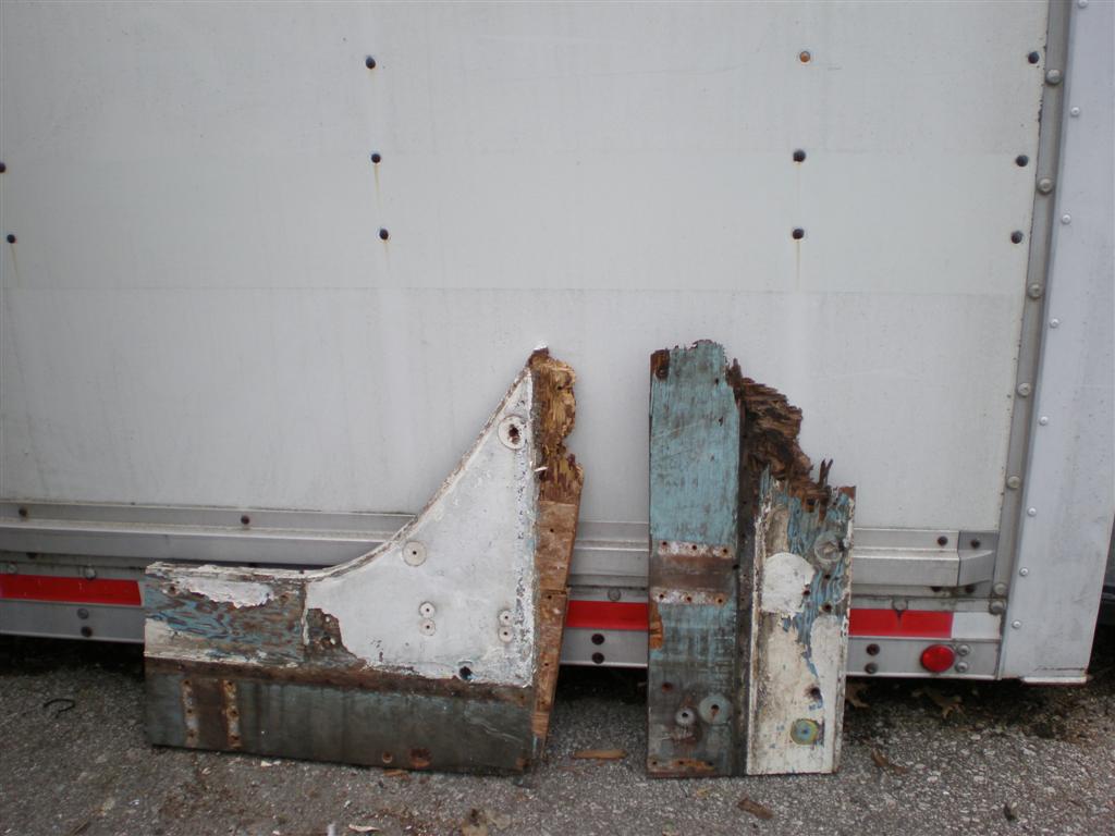

Last spring I replaced the transom in my 1963 Starcraft, the transom I pulled out was the original kind of rotten but still doing it’s job. I added a tilt and trim plate and installed a tilt tube on the 66 Evinrude 100S so I could use modern cable steering. The bare aluminum on the boat was cleaned with Alumiprep and then treated with Alodine then primed with a two part aircraft epoxy primer and then painted with urethane paint. The transom wood was glued together with Gorilla glue (the stuff foams up really bad and you only have about a 15 min working window) then I coated the wood with resin and painted it with urethane paint. There is over 100 screws and bolts holding the transom on.

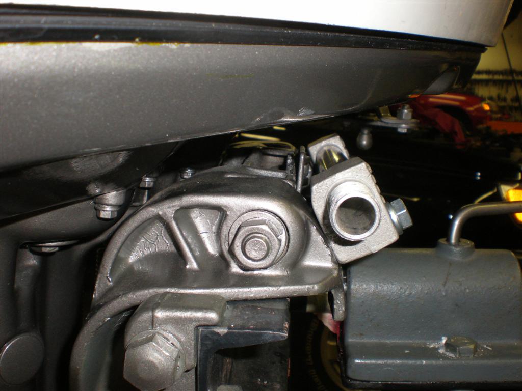

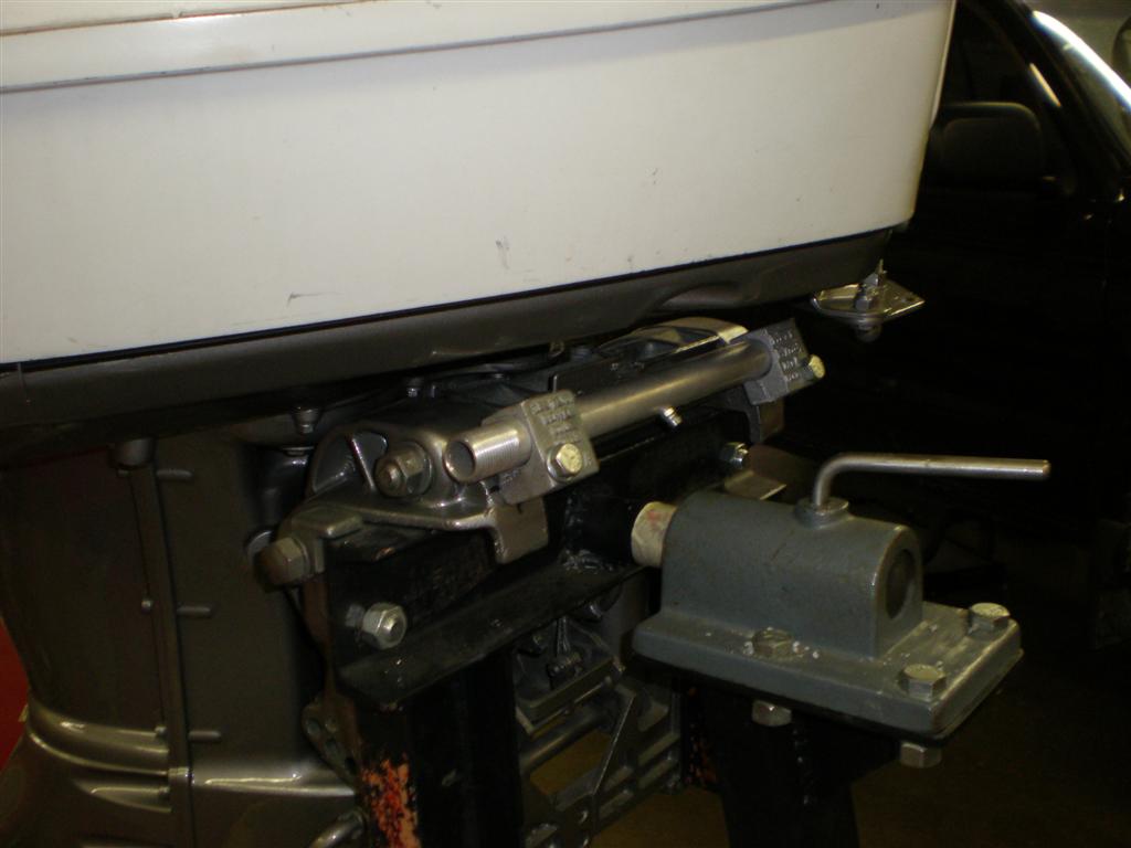

Welcome back Pat! Really looks good. I would love to see some closeups of the tilt tube setup!

The tilt tube works reslly well.I drilled the Evinrudes transom brackets and then inserted Heli-Coils.
I will post some better pictures that I have on another computer.
