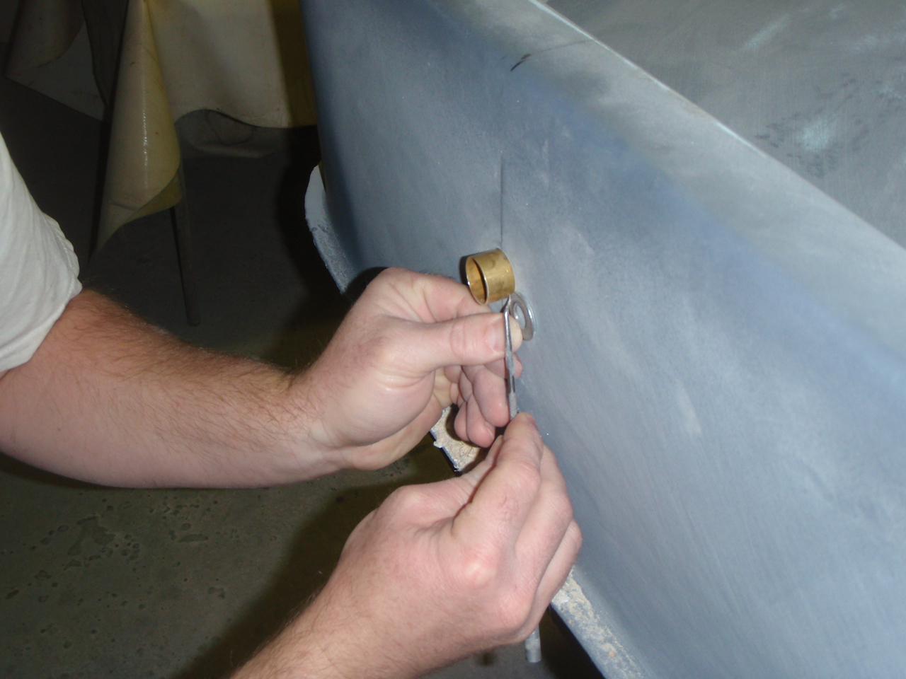

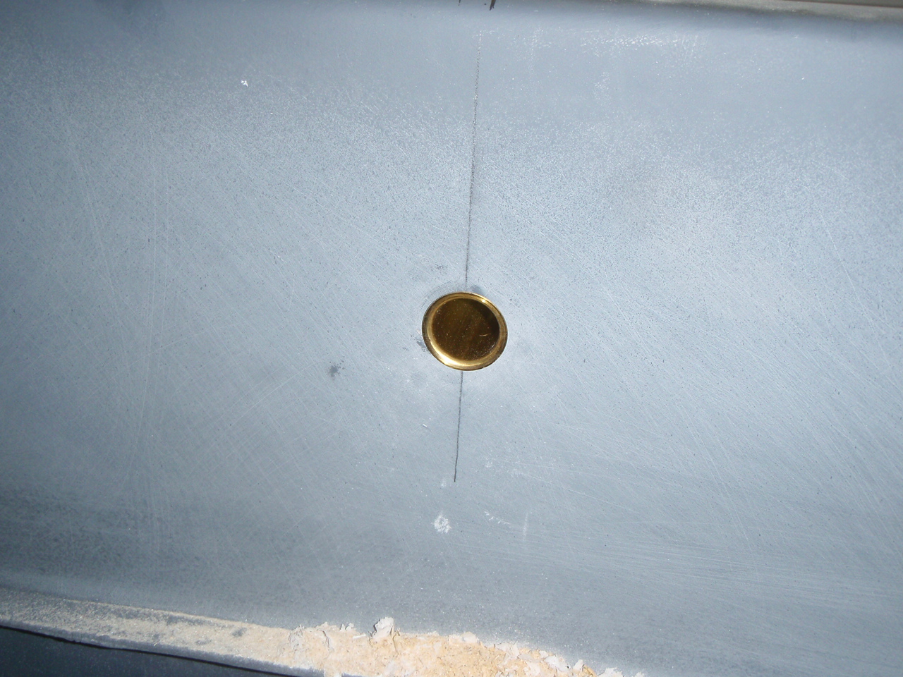

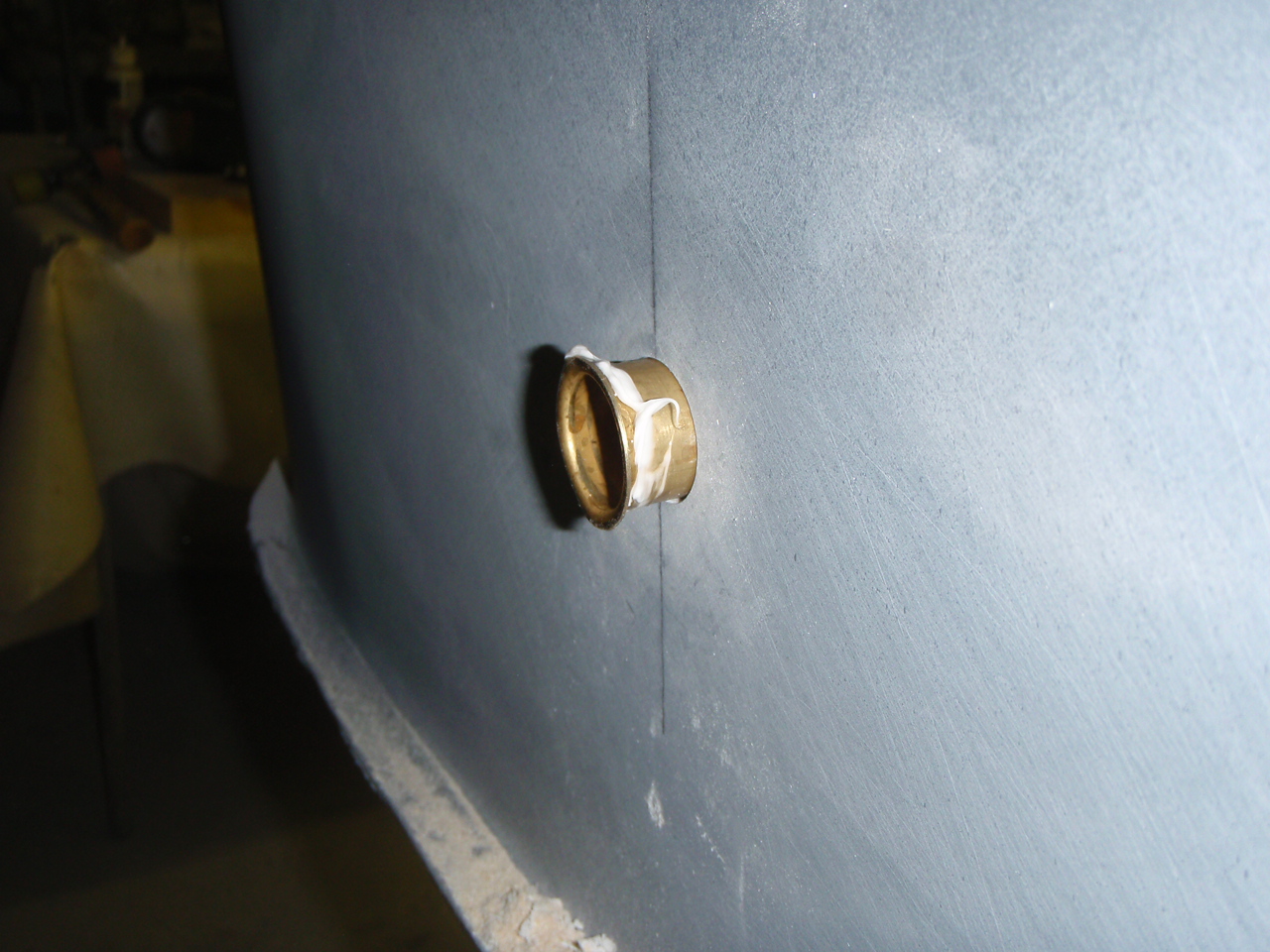

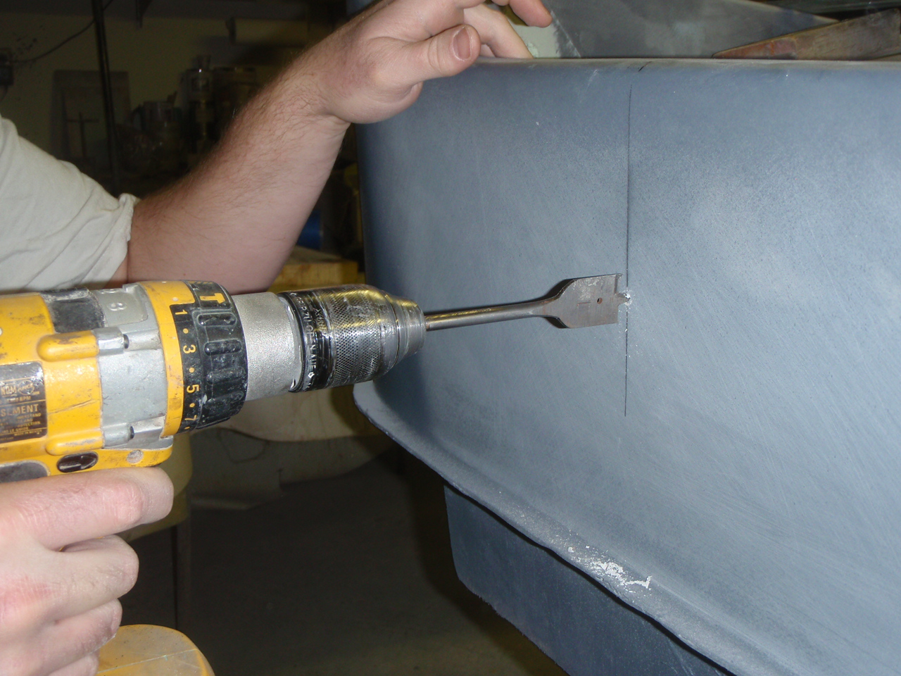

Here is what has worked for me many times. A one inch drill bit is the size you need. Can be a hole saw or any thing that cuts one inch. Drill a practice hole in a 2/4. Fit needs to be close not tight. The 5200 will take up the slack. The most important part is to cut it the right length on the tube. I drill the hole put the tube in use a quarter or washer and mark it a little fatter so it is an eight of an inch long. You can cut it off by slipping a dow rod in it or some thing close. I use a plumbers cut off wheel (like the one they use to cut copper pipe with) If you have one that will adjust out to one inch. When you put it in for the final time use plenty of 5200 to much is better that not enought.
A few pictures.
Oh drill from the outside in and becarefull when you start to exit on the inside. It is easy to blow out body work or chip the glass on the inside.
Good Luck D
