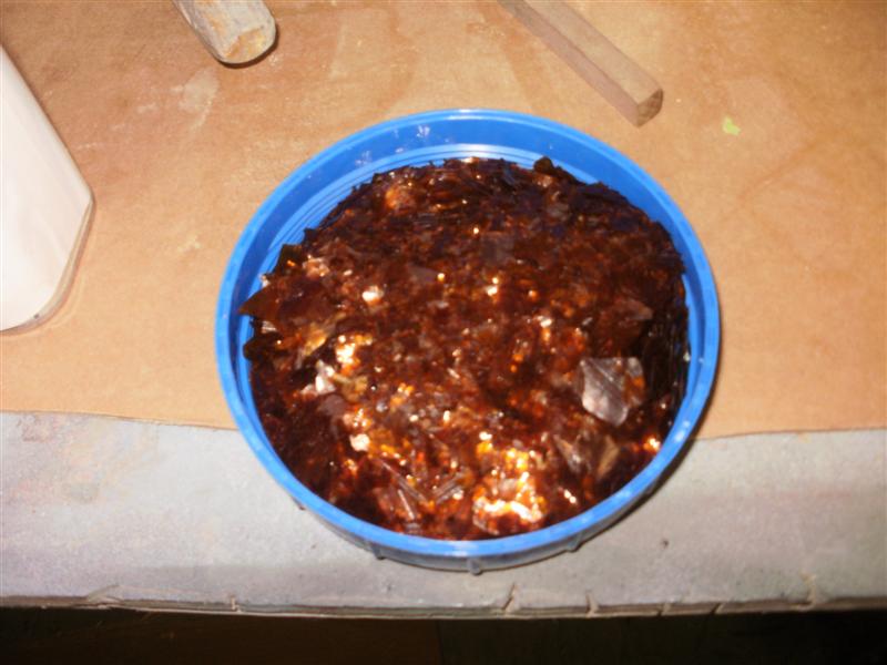

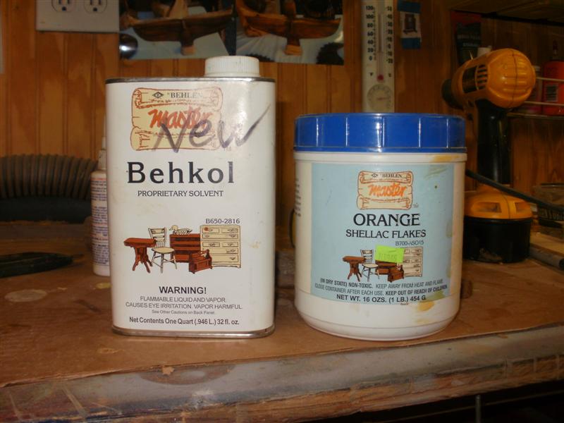

Its hard to imagine that anybody would use true Shellac on a fiberglass boat but I guess stranger things have happened. If it is true Shellac the proprietary solvent is Behkol which is an alcohol product. Denatured alcohol will work but it is very slow. Behkol will cut it quick but it is very toxic and make sure you wear a mask. I have used shellac on Mission furniture but never on a boat .
