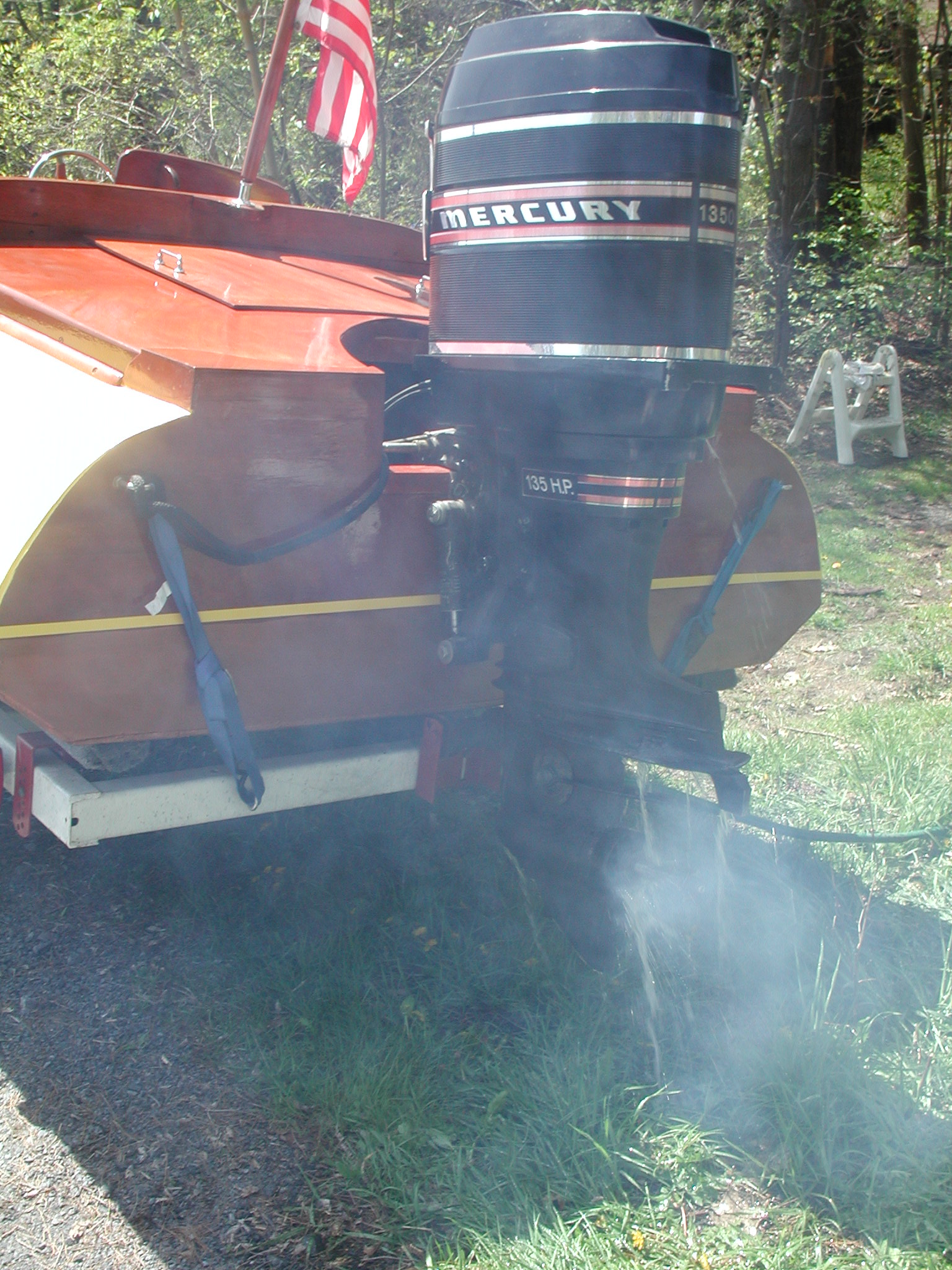

I have had some trouble with the LU on my Merc, and I had my son's mechanic (my son is the service writer at a boat dealership) reseal it. Since I put it back on I could not get it in to reverse. So tonight I decided to take it back off and see what I could do.
Neutral and forward worked fine but the cable just couldn't go back far enough to get reverse. If I took the cable off and pushed the slide lever back as far as it would go it would drop in. So, after many trials to get the splines to move over a tooth to get what I needed, I seem to have discovered that I had put the cables in the control box wrong, I.E. it seemed as if the one with the slightly longer end (who new?) was on the throttle and the shorter one was on the shifter.
So into the control box I went to swap them back, knowing the wiring was shot from the last time I was in there, and also knowing I had been telling myself I needed to rewire. So I cut back the cable in to some fresh(er) wire and resoldered everything.(About 2 hours) I put the cables in the opposite postions, and seemed to have forward, neutral and reverse with the motor not running.
Time to fire it up on the hose, I pulled the floor jack out from under the LU and hooked up the hose and it fired, at about 4500 rpm.....quick shut off (really quick) and remembered I hadn't readjusted the throttle cable, walked back to the motor and the LU was sitting with the skeg on the ground and the driveshaft barely still in the mid. I forgot to put some nuts back in to hold it on.....
Now, adjust the cable and reinstall the LU (no damage, thankfully...the Lord watches out for fools...), start it up and no water from the weep hole!
NOW WHAT???? Well it seems as if a mud dauber had begun to build a nest in the weep hole tube....so get a piece of wire and scrape out the mud, now I have water...but I STILL have to push the throttle WAY back to BARELY get in to reverse, and in neutral it is grinding as if it too far forward towards forward gear. If I pull it back slightly toward reverse, it stops grinding...
