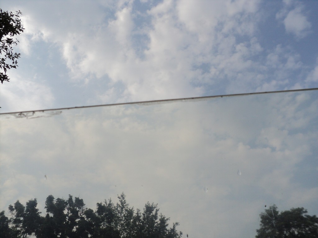

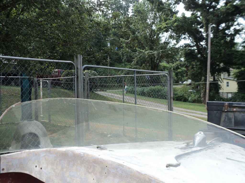

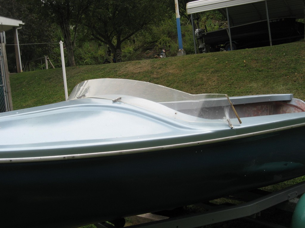

You can buy kits that are made for that. I never used them. I have taken a fine rubbing compound to plastic windshields not not boat windshield and it did take scratches out. I cut my windshield down last summer for my Winner. I took regular car wax to it and have done it three times so far ,hand rubbing it good and it is amazing how much has come out. This is what it looked like before and I have no pics after yet.
