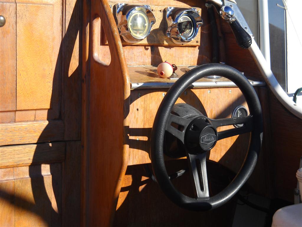

Got that pesky wheel off today. It got ugly but it ended well. I cut a lot of the plastic off with a Dremel, then used my bench grinder on my 2 hook puller to get some clearance between the puller hooks and the plastic housing between wheel and dash panel. The wheel finally came off, although it fought valiantly to the bitter end. For now, I installed (loosely) the old wheel off my beloved 86 Galaxie that fell victim to a hard frost two winters ago. It's a big improvement. I have my eye on a nice 13.5" destroyer wheel. Maybe an early Christmas this year...? Here's the Galaxie wheel, doesn't look too bad.
