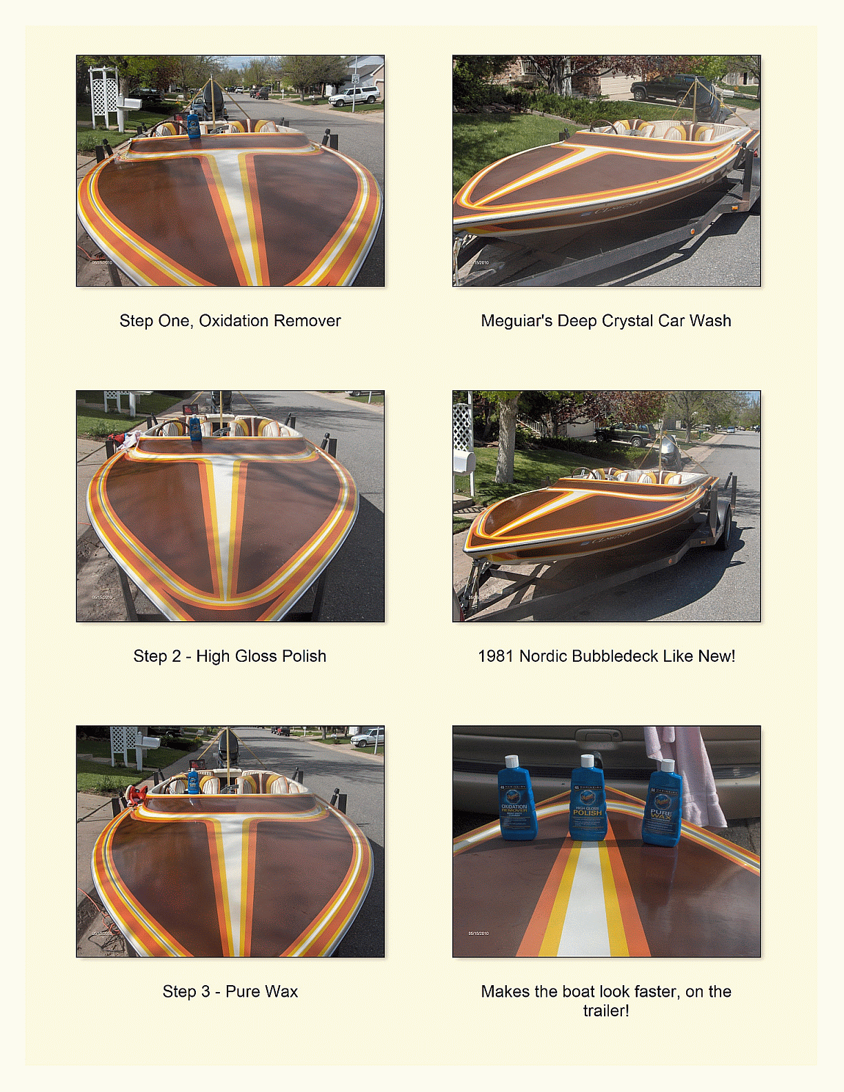

I finally got my newly purchased 18' Nordic Bubbledeck with a 1975 Mercury Inline-6 home, and after scrubbing away the protective layers of dirt, I got down to business with Meguiar's Fiberglass Restoration kit, a three bottle set of deoxidizer, polish, and wax. Along with a brand new Black and Decker 6" orbital polisher, I spent a day doing all the top surfaces. I took photos not only before and after but how half the bow looked after each step in the process.
I still have a lot more to do, but thought this would be helpful to others curious to see if these products did a good job.

B) The buffer was the only reasonably priced one I could find. I bought it at Lowes for $25, and I bought a couple extra foam pads and polishing pads.
I used a separate foam pad for step 1 and 2, and the lambswool for the wax application, and old terrycloth towels for wiping off each of the steps. (Deoxidizer and polish had to be wiped off wet, and the wax wiped off after it had dried to a haze.)
The on/off switch is a bit retarded as its behind a rubber seal, and you can hit on or off accidentally. (comical scene with me covered in wax flung off the pad deleted)
It is not super powerful, but worked well for the application. I watched a few how-to video clips on Youtube before starting.

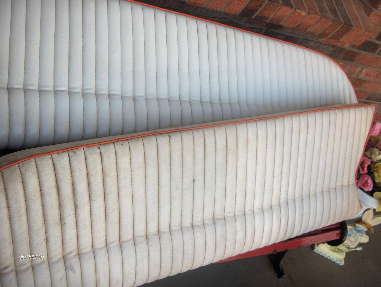

We used Starbrite or some simular brand to clean the vinyl, it was a concentrated cleaner that had to be mixed with water. Here is an example before/after shot on the cushions.
