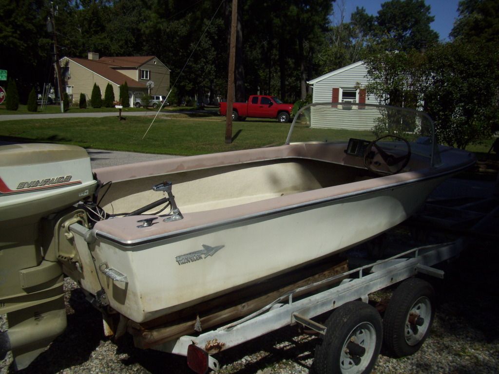

Just got my 196? Traveler home and found some good and bad
Good
metal, trim and rub rail
Bad
Hole in bottom, was sitting on a trailer that was to big and sat to long
worn fiberglasson deck
Motor was frozen solid with rust in the carb
Controls are rusted away internally
Gelcoat is Horrible
The Windshield is in OK condition, not great but usable
NOW WHERE TO START?????

First thing I'd do is get the outboard off and see if you can get it unstuck. Soak the piston with PB Blaster and leave it sit awhile. Now I'd tear the boat down after I got it off that trailer. Flip it over and start on the bottom. You may want to split the top and bottom. Save them stainless screws, they are damn expensive. Don't think it will be done in a wek. Take your time. It will come along.
Re:Ark Traveler..Just got Home found Good and Bad**** 14 years 2 weeks ago #69698
Robert gave you good advice. If the motor doesn't loosen up, junk it and move on. If the transom and floor are in good shape, you are not that bad off and it is probably not worth taking the deck off. Is the gelcoat problem on the deck only or on the hull as well? You are a lot closer to being wet that the last thing that followed me home.

Both are pretty bad, they are cracked and there is a hole under the port stern(see pic)
Re:Ark Traveler..Just got Home found Good and Bad**** 14 years 2 weeks ago #69706
Looks like you picked yourself a winter project. Nothing is impossible just take it one step at a time and you can do it.

I am making room in my garage for the winter and I am curious how far to take down the gelcoat. Looking at my gelcoat in its current condition are there any recommendations?
Re:Ark Traveler..Just got Home found Good and Bad**** 14 years 2 weeks ago #69982
Hey rip did your boat sit full of water? That hole looks like it was poked up through. Maybe had somw wheight in it. I fixed one similar. Someone threw something into the boat. I cut out the bad glass and put two layers over the hole. I filled the hole with Duraglass from the inside and I am going to put a few more layers of mat inside. The outside is done. The rear corner closest has the repair.
Re:Ark Traveler..Just got Home found Good and Bad**** 14 years 2 weeks ago #69994
First thing I would do is find a cheap fixer upper trailer of the right size. Then sell that one. That one is worth a little money and too big.
Engine looks like a 72' or a 74'. Yes, if it comes unstuck it may be useable. Graphics look too good. Carb should be aluminun and shouldn't have rusted, unless you are talking about the screws.

Robert,I am not sure if water sat in it I would assume thats correct, it was also on a roller trailer that was to big for the boat.
as for the trailer that its on now, it goes with my 20ft center console fishing boat that is lift kept year round. I have a few small boat trailers, one for a jet ski that i will probably put it on to move it around the house.
I am excited to "strip it then flip it" and start sanding just wondering how far to sand it down, and tecniques for fixing the hole.
Re:Ark Traveler..Just got Home found Good and Bad**** 14 years 1 week ago #70045
I would not even bother trying to unstick the motor unless you're planning on tearing it down for a rebuild. Even if you did unstick it, it is likely that the lifespan of the motor could be measured in minutes due to pitting of bearing surfaces inside. A teardown may show that it is as simple as replacing one rusted bearing, or it may show the internals are riddled with rust and not salvageable. Won't know until you do it.
Alternatively, if you like the early '70s look, that cowling will snap onto many years of Johnson and Evinrude 2-cylinder loopers well into the 1980s, which gets you away from the old style ignition and electric shift.

Chine, that is probably what I will do. Right now I am more focused on the hull. I should be able to find a motor around here relativly easily since i am in SE Virginia, Chesapeake bay/OBX/Virginia Beach area. Although I like the idea of using the cowling on later model OMC. I really want to get the hull seaworthy.
Re:Ark Traveler..Just got Home found Good and Bad**** 14 years 1 week ago #70097
To your question on the gel coat, that will have to come off down to the good mat underneath. Some like to put a whole new later of mat over the old, that's your call based on condition and thickness of existing mat.
Transom and floor are seldom in good shape on a boat that old, especially if it was stored outside. Tap test should tell you all you need to know.
