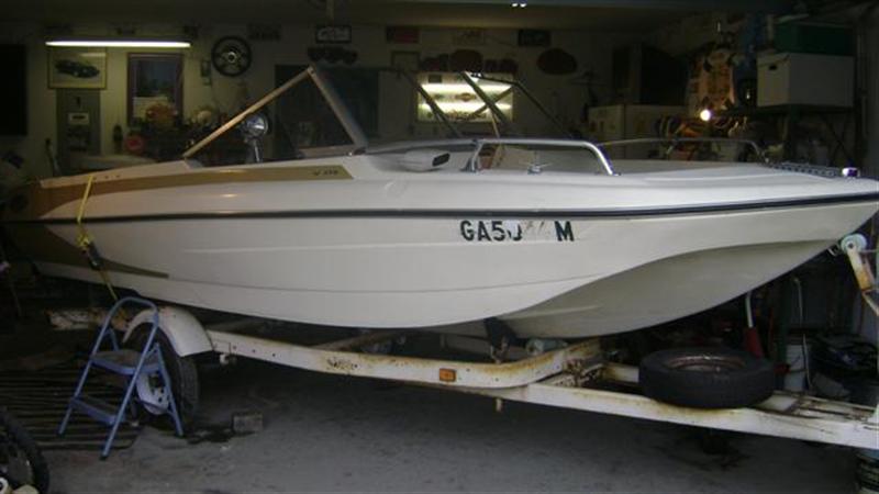

Anybody have any suggestions on how to remove old boat registration numbers and decals from fiberglass without scratching the gel-coat?

Finally got them all off, what a mess! The heat gun did the trick on the outer vinyl, or whatever that was. The letters/numbers were the ones with the reflective background coating around the digits making it a full rectangle. Several appeared to be re-glued on, with monkey snot, that was the nasty part!
One of the guys at work had a can of "goof off" he gave me, so I tried it and that stuff works pretty good too. I think a little buffing will bring back the finish I'm looking for, before applying the new numbers, gotta let my fingers rest a few days before proceeding, however.
SAFETY NOTE: Be very careful not to get your fingers in front of the heat gun when peeling stickers! :S

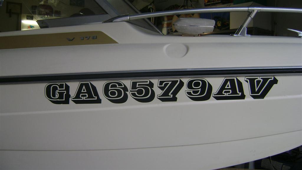

Just thought I'd share the pic of the new registration numbers on the Glastron.
Really tired now, gotta go rest awhile....
Re:Removing old registration #'s and decals 16 years 8 months ago #1883
By golly Mark, no one will miss those numbers! Looks really nice.

Frank, I told the guy who made the numbers for me that I wanted them 3" high to meet regs. He did, but the shadow added another 3/4 inch or so. They look kinda big, but I guess they'll grow on me. If not, they should be much easier to remove and redo next time around. :laugh:
