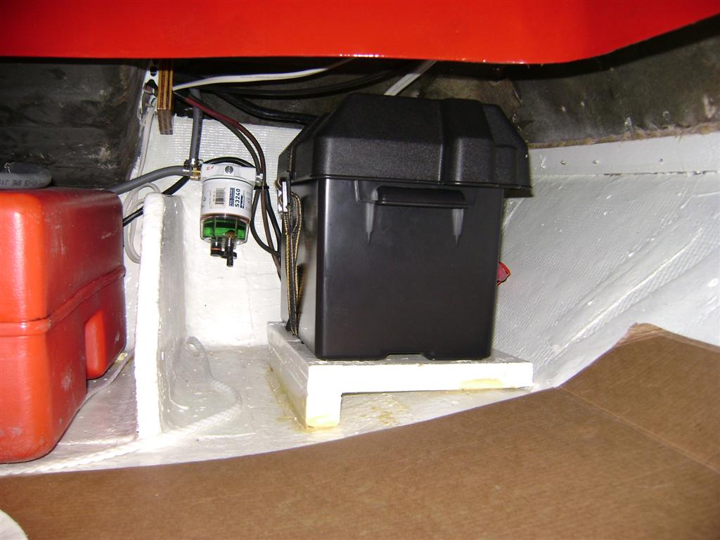

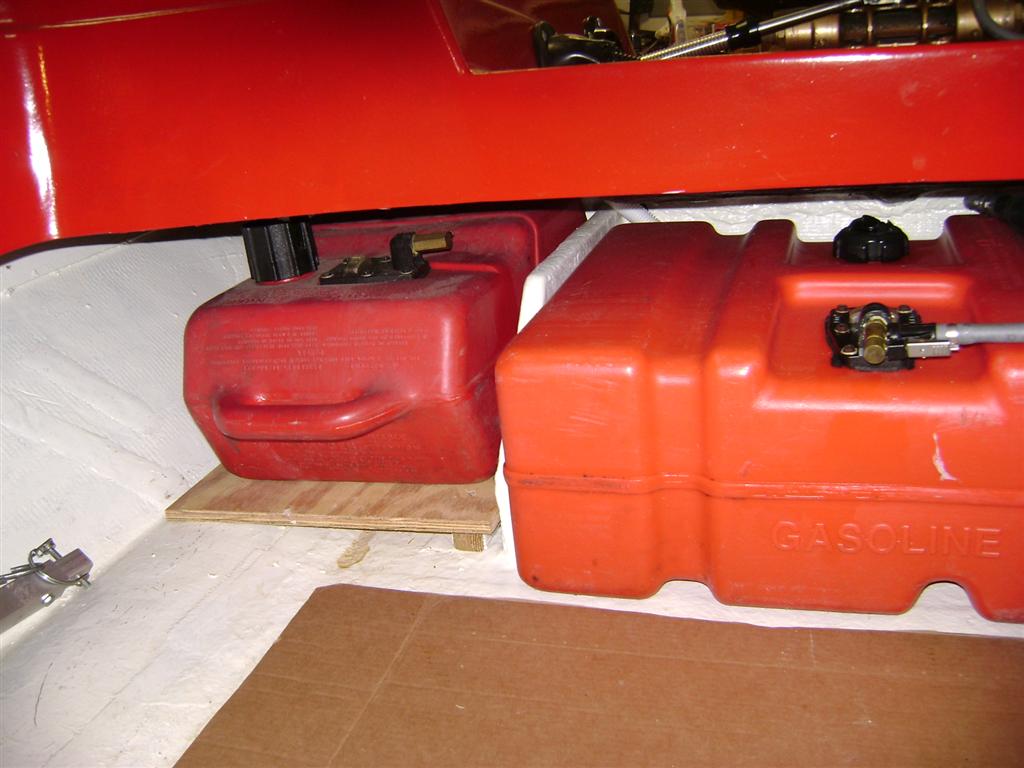

If you plan ahead, and I know you do Todd, you can make the braces dual purpose too! (ie: use them to help hold everything in place as well as strengthening the transom!) (Really I just got lucky and the 12gal tank fits between the outer stringers, which is where the knee braces attach.)
