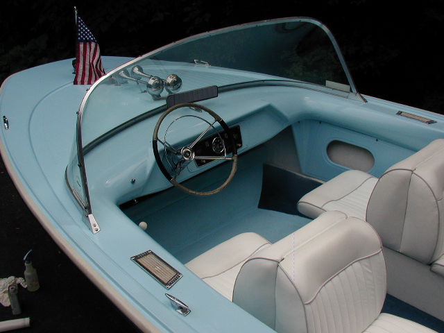

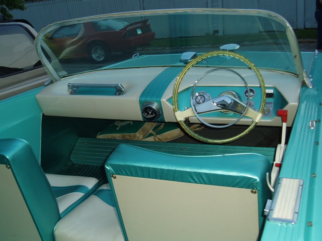

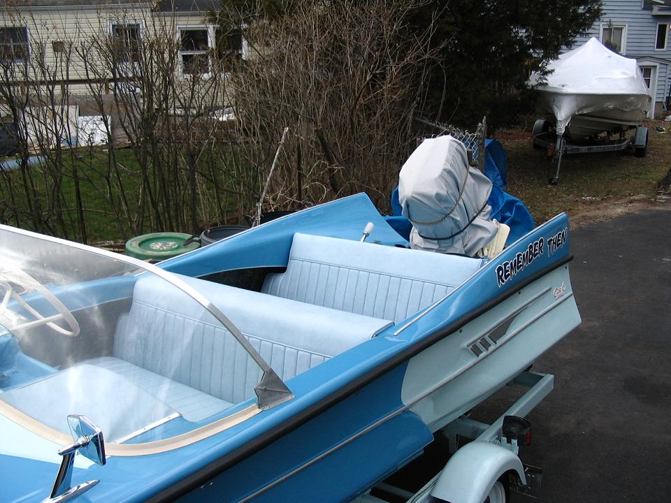

There's not much of my handy work on this one. This is the original interior on my 64 Aqua Ray. The seats are foam on a sprung wood frame. The dash is upholstered (or padded). The floor has a vinyl sheet covering. I can give you more pictures or details if you like. Right now the seats, etc are removed and I am replacing part of the floor.

awful pretty. wish i had that interior. ron

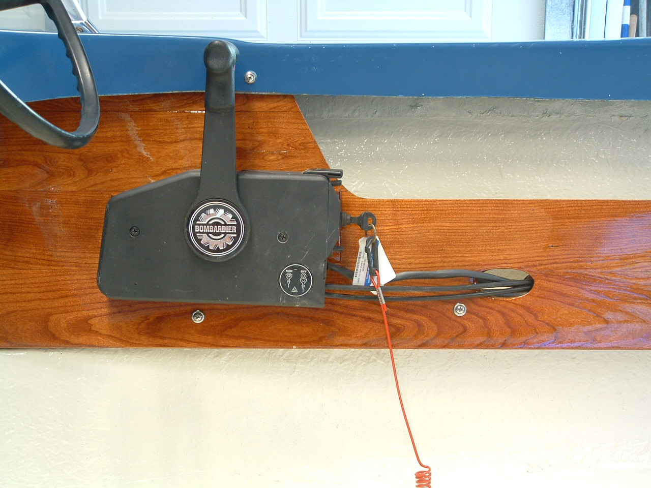

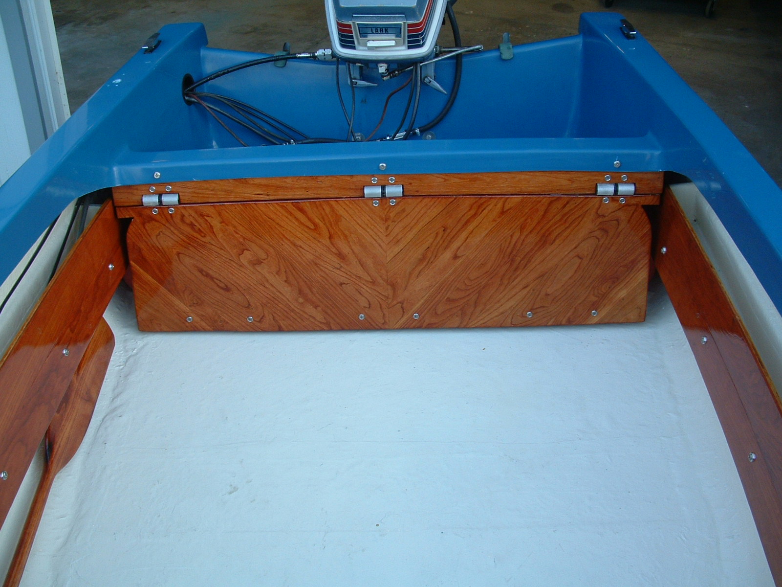

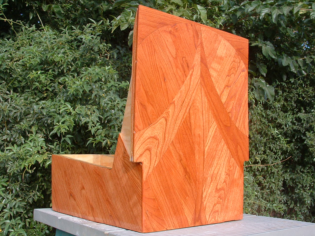

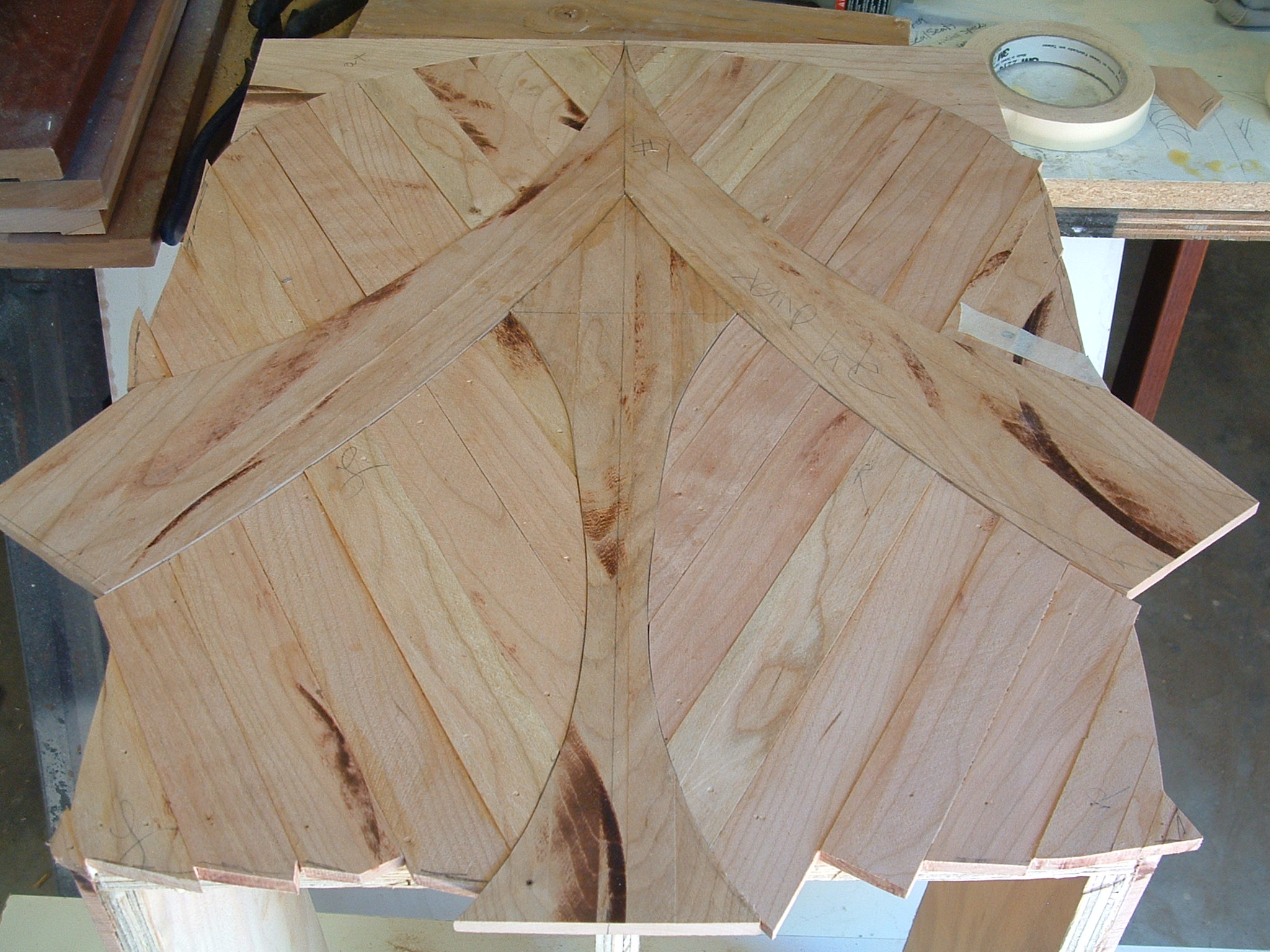

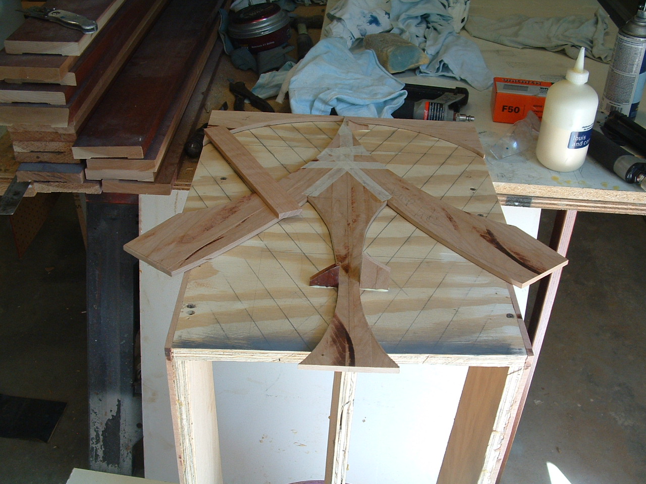

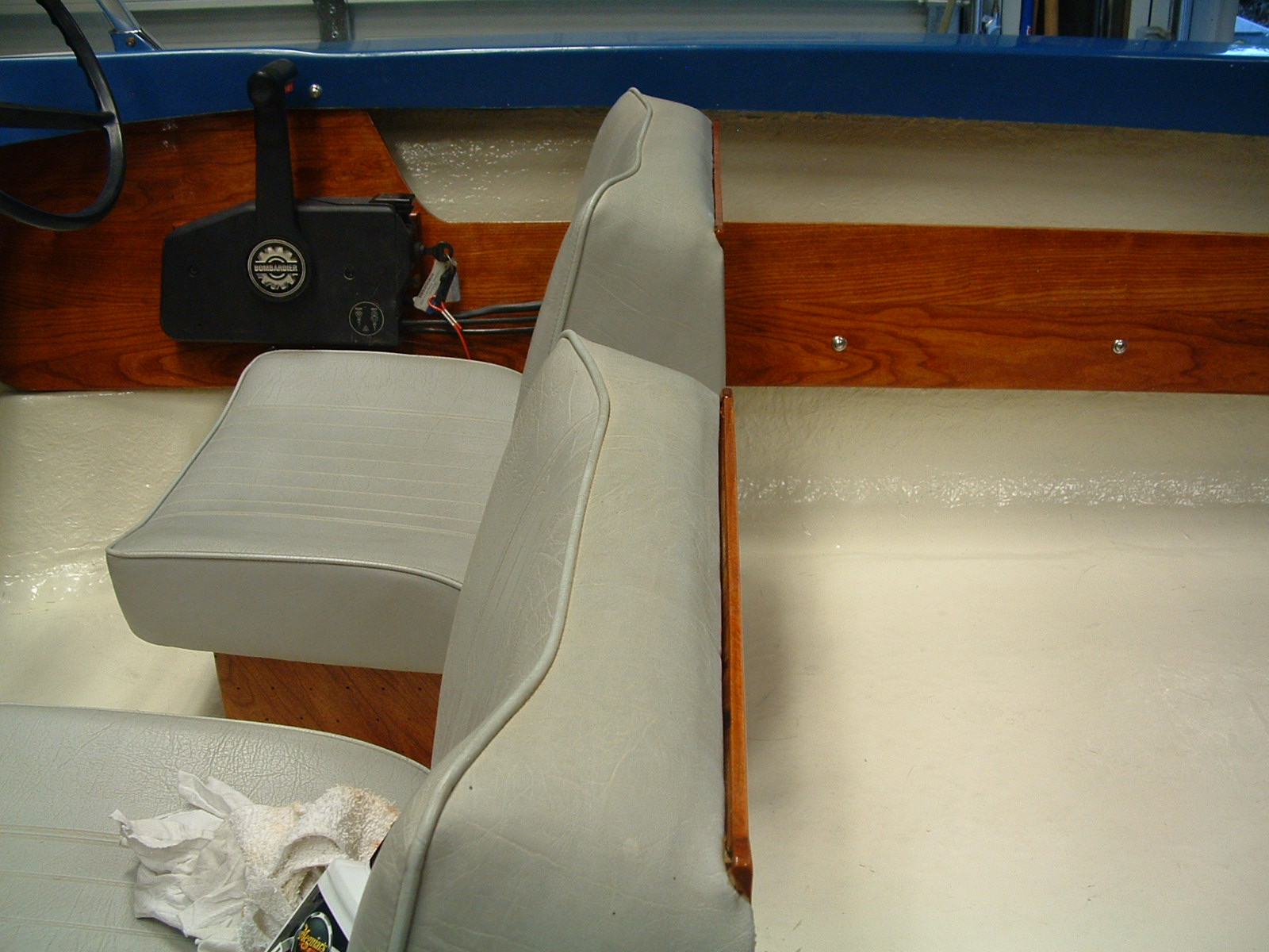

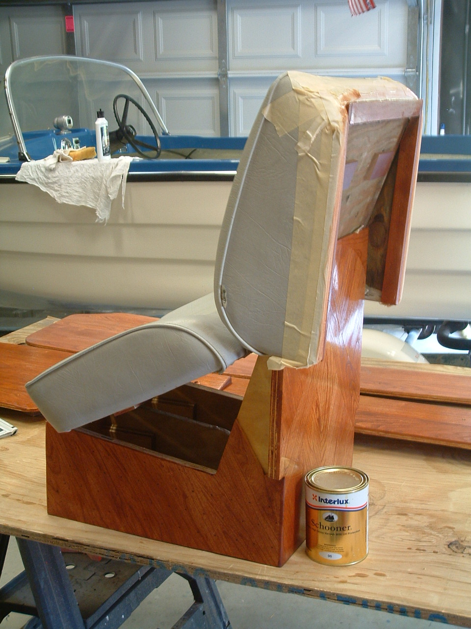

I used the original side panels as templates and used exterior 5/16 ply and glued 5/16" cherry on top, routed and varnished. Custom seats and splash well cover, Mike PS....MAYBE too many pics huh?, LOL
Not at all, Mike. We never get tired of looking at quality craftsmanship around here! ;)

Wow, I've tried my hand at woodworking. What you've done there is amazing!

Careful Mike...you might upset the "purists"... :P lol
The pictures of that SeaSwirl do not do it justice...its REALLLY nice!!

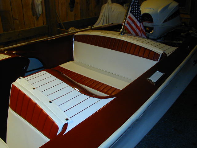

This is the interior of the 1958 Crosby Capri. I was able to find, thanks to this site, photos of the original 58 Capri interior, and brought it to the upholstery shop and told them to "make it look like this". You can see the original in the FG Crosby section.

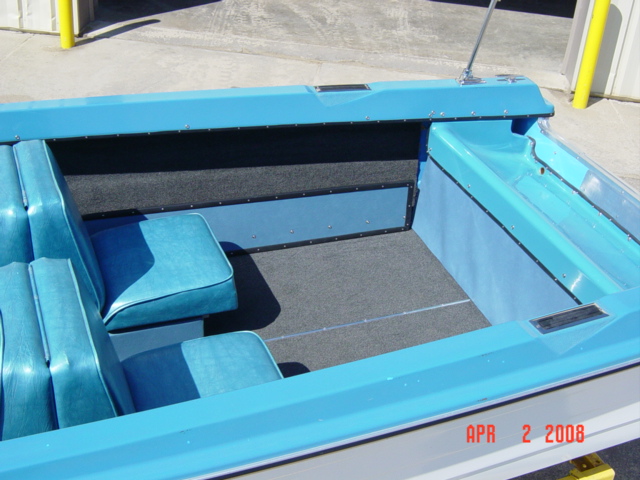

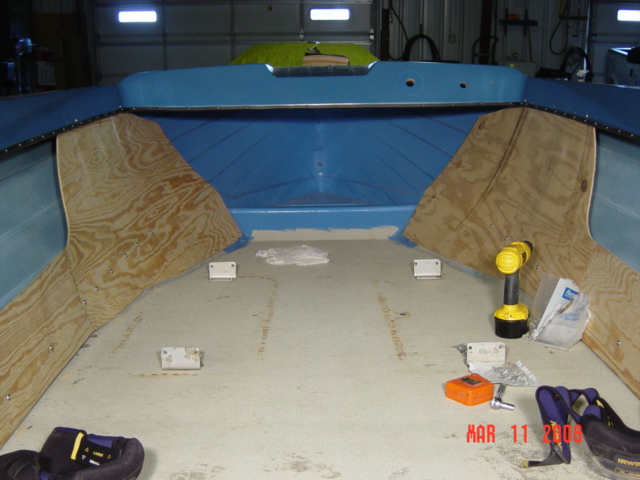

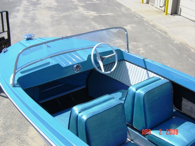

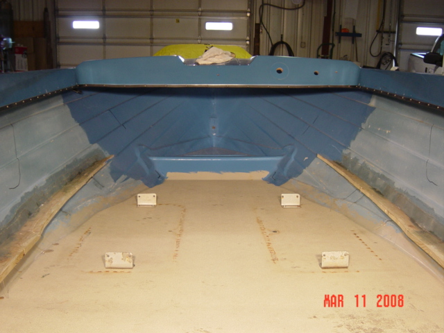

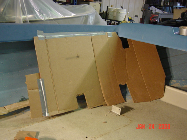

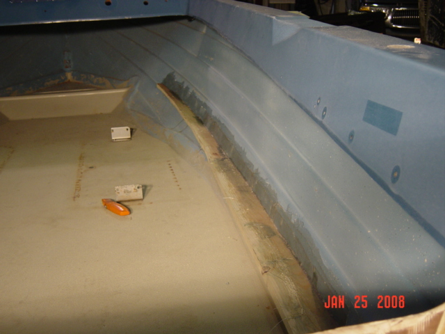

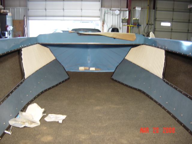

1966 MFG Side Panels. This boat had no side panels when new.

Re:Show Me Your Boat Interior 16 years 5 months ago #6830
GD...
That is exactly what I was hoping for. Great job. :)
My boat has no interior side panels and what you have done is what I was thinking of.
Again, thanks.

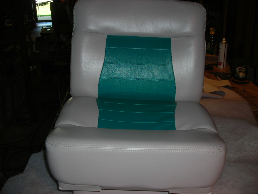

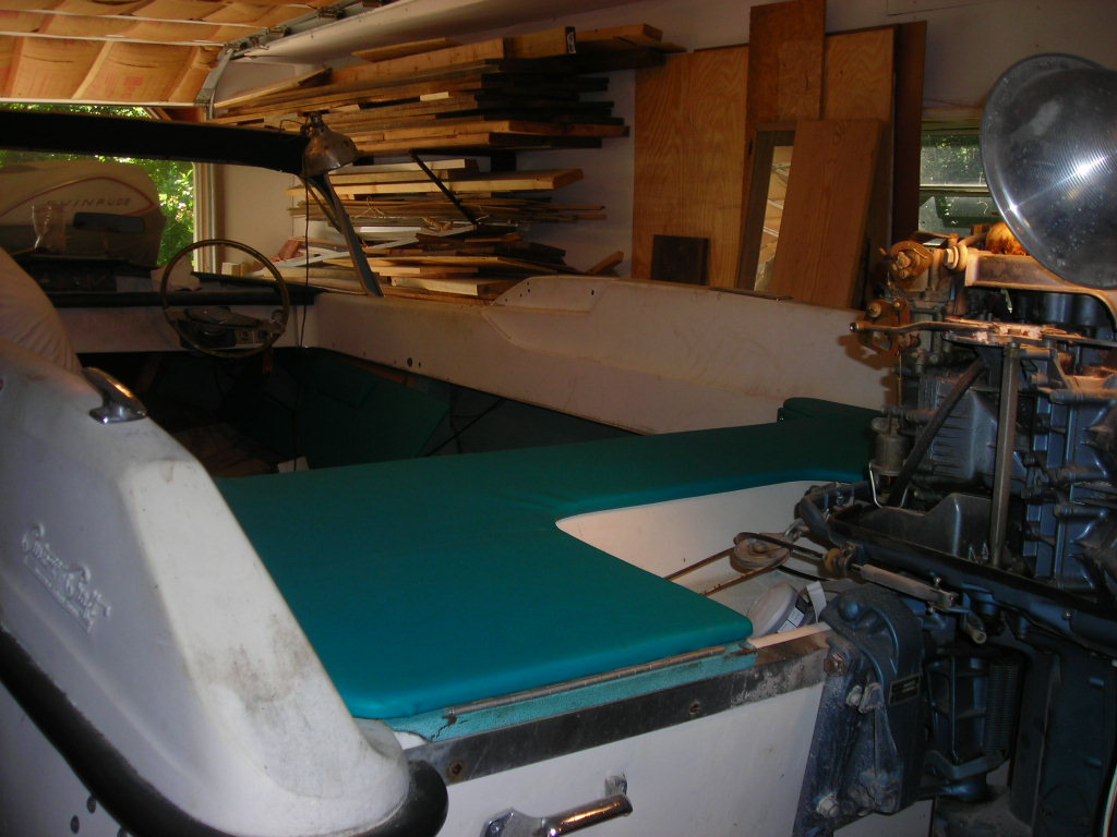

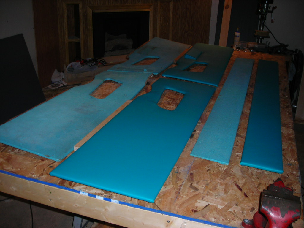

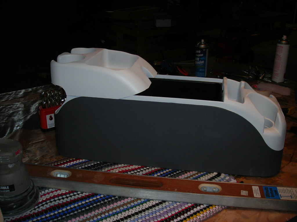

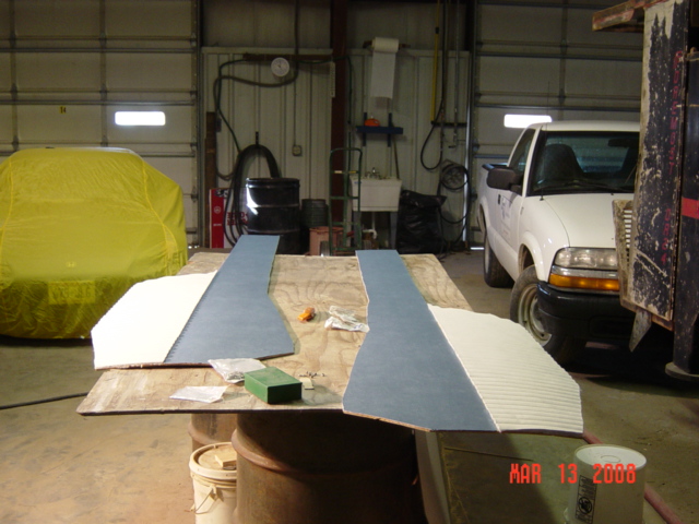

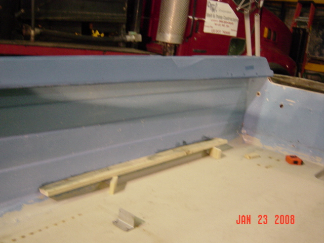

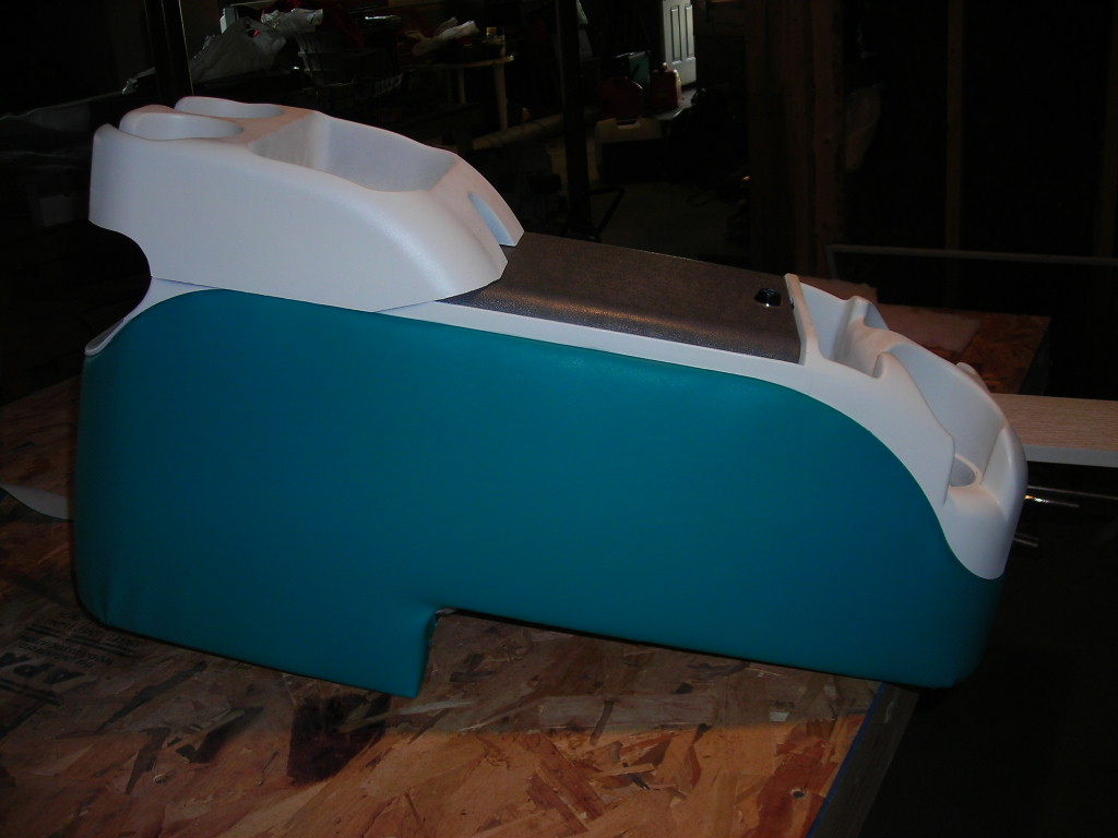

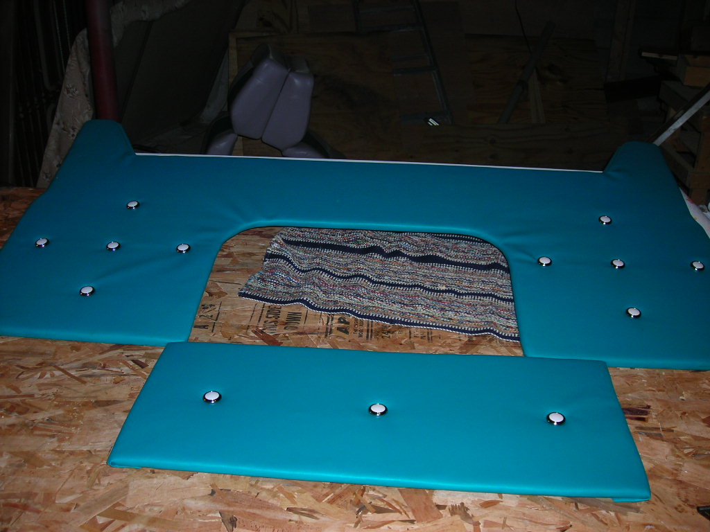

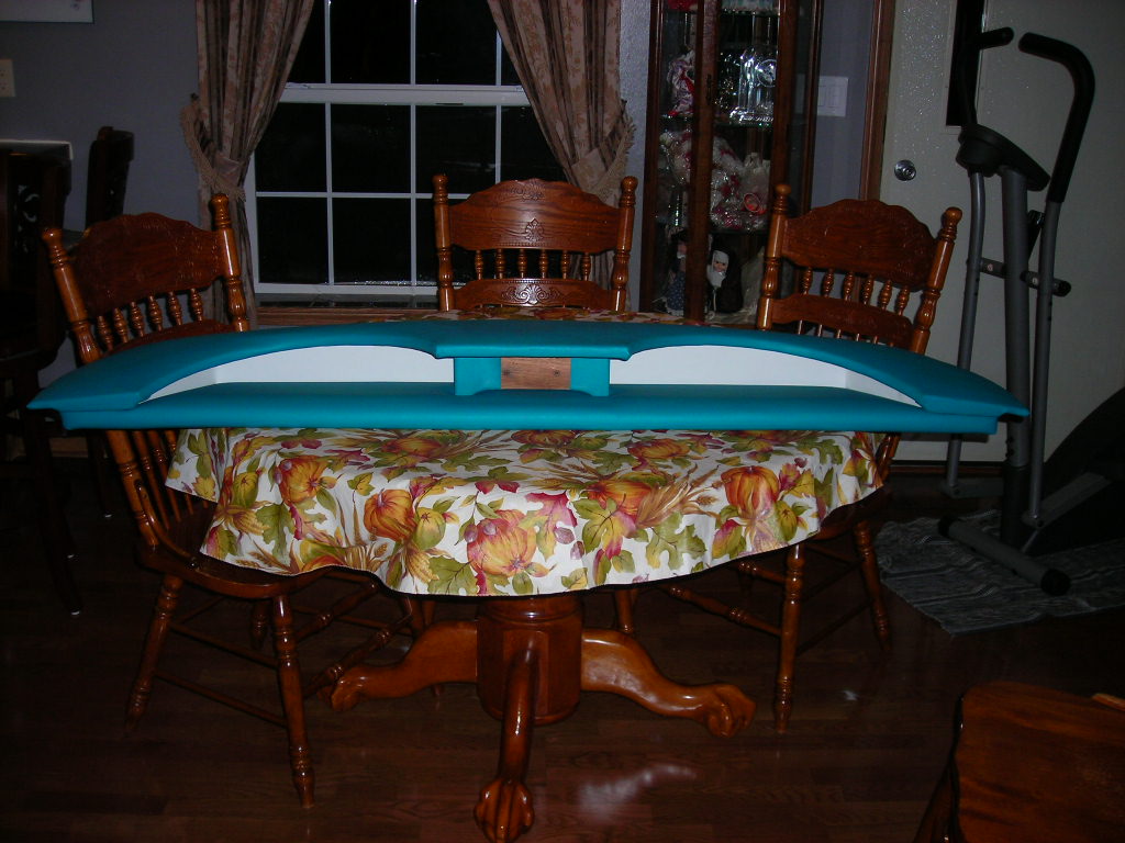

my interior for the 64 custom craft sunray is all in pieces,im still making them,i used the old ones to make patterens,except for the console,i bought it and painted and upholstered it.the original seats were totaled,so we had to get new ones,and got matching yinyl,to make the rest of the interior.next i have to take out some some small wrinkles in the splashwell cover.

Very Nice!
