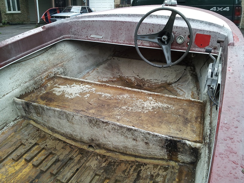

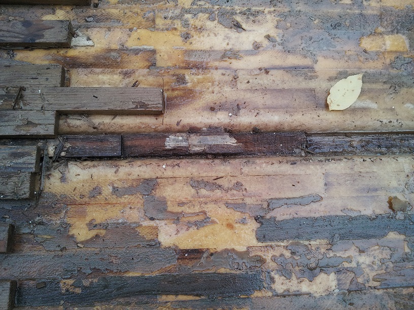

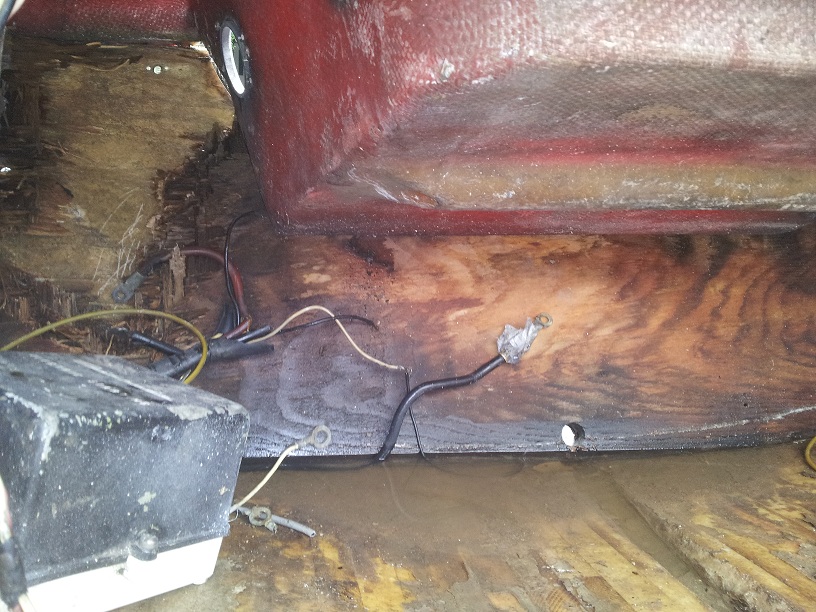

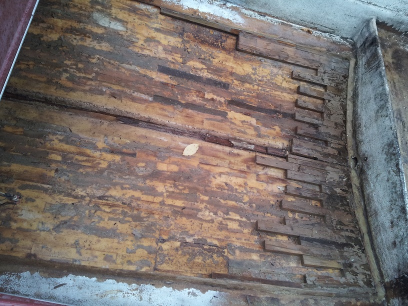

Here are the pictures i took

WoW are you going to redo that floor. I bet it looked great.
Re:1963? Crestliner Canadian Mustang Deluxe Refit 13 years 9 months ago #66507
The floor had already been cut open and poorly glassed back together.
It was all wet inside and a number of the balsa were rotten or soft.
and the transom is full of rot just like mulch.
so im going to attempt to fix it just have to dry the hull out. and try and fix whats messed up.

I too have a Canadian Crestliner Mustang with the Jenga block balsa floor.
Mine however is a 1968 but with the front and back facing seats not a bench like yours.
I was lucky enough to find it 100% original with the original interior still in place, in restorable condition, original 40 HP Evinrude motor and factory trailer.
The floor however is rotten and needs to be replaced.
I'm also in the process of splitting the hull because I'm not 100% confident of the transom.
I've restored cars as a hobby almost all my life and decided to approach restoring my Crestliner in the same way.
I may have sourced the Balsa Jenga block floors.
Have you tried Noah's Marine Supply in Toronto?
They list a 1" thick Balsa core laminated to a 24" x 48" fiberglass mat. It looks like the Jenga block floor like you and I have.
Check out their website.
It looks like a boat restorers paradise.
