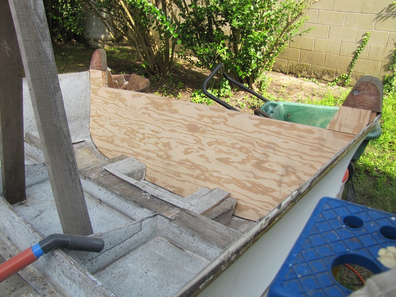

Despite the dew point of 76 yesterday, I got the new transom pieces cut and fitted for the Glastron. Not perfect, but everything bears where it is supposed to. Glued the small pieces for the fins yesterday and plan on epoxying the two transom pieces this week.

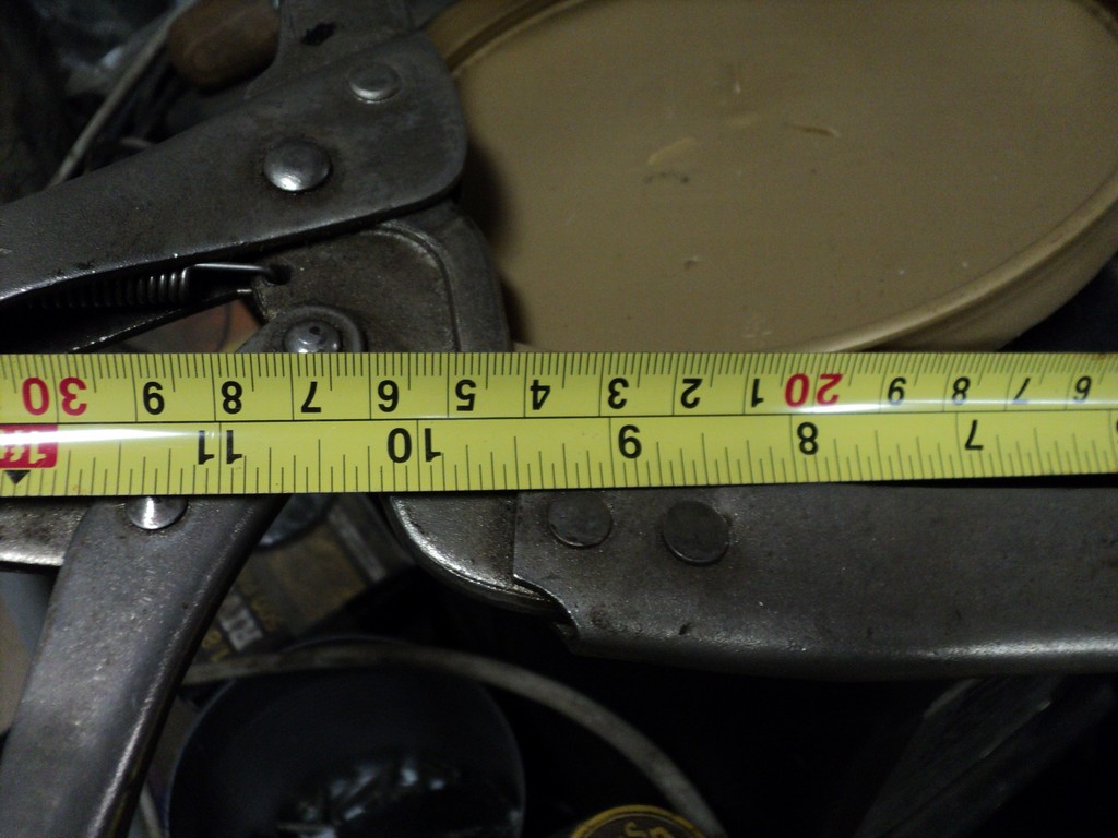

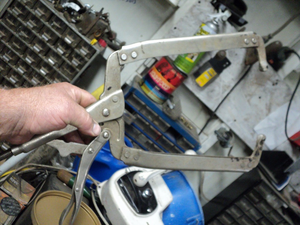

I'm thinking I would brush it with resin and clamp it in place. I have a pair of those long Vice-Grip clamp that has a throat of about a foot or more. I'd beg, borrow a few pair or get some cheapies from Harbor freight. Well mine have a much deeper and longer jaws. www.harborfreight.com/hand-tools/clamps/11-inch-swivel-pad-lock-grip-pliers-39535.html OK Mine have a depth of 10 inch. These a cheapies and I'm not sure where I got them. I used them on my transom. It was not bad but needed some glue injected from the top and held in place.

I was thinking about trying to building something using some using woodworkers handscrew clamps (on sale at Harbor Freight). Also thought of pre-drilling the drain hole and using a large bolt with washers.

Transom drain hole, splashwell hole, motor mount bolt holes, stern eye mount holes (if you're putting any on) would all be good candidates if you know where they're going to be located. Doing it this way will also enable you to coat the inside of these holes with resin as well, sealing them against future water infiltration. (Just use smaller bolts than whatever is going in the hole finally, and coat your "clamping bolts" with vaseline so you can get them out!)
