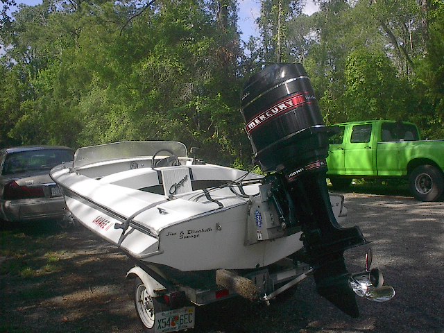

Re: AirGuide Speed-o-meter ? 14 years 4 months ago #63977
Pitot attachment even with the bottom of boat on the lower transom, with your hose attached to it. Buy one at most marine stores. Very simple-two small screws and attach the tube to it as well as to the back of the speedometer.s Here is a good picture of it (black tube down right hand side of trasom!) The pitot drags in the water, and water pressure going up it causes the speed to register on the dial!!!
Jim Savage
