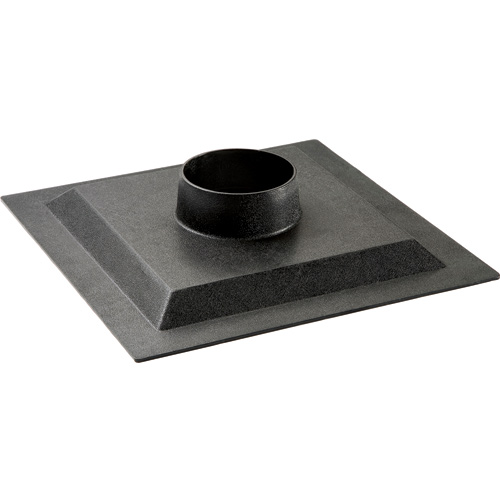

Those look like "hoods" from a dust collector system.
Re: 1972 Sea Ray 190 restore: engien room ventilation 14 years 4 months ago #63162
