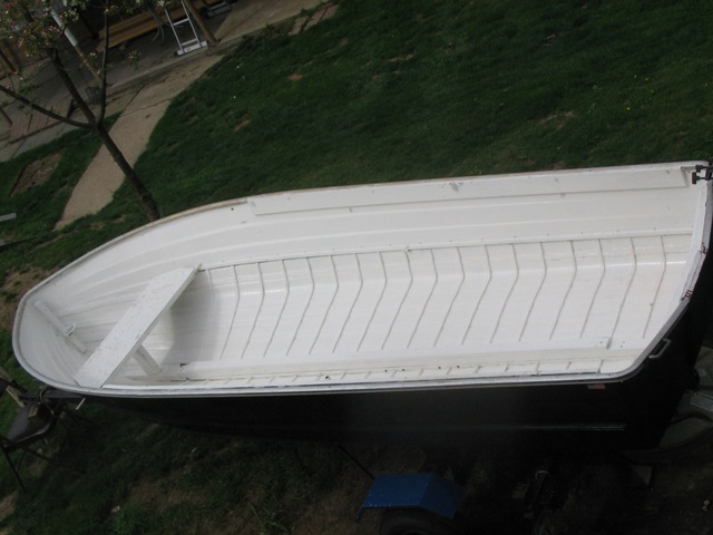

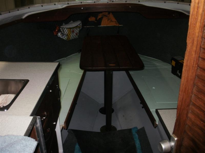

just for scale here are a couple of $13 dollar Rustoleum paint jobs the first one is the interior of my 1972 Glastron GT160 and the second one is a 16 foot fiberglass canoe i rebuilt .

Thanks for posting the pictures. The paint looks great. I am glad I will be breaking up the white with my carpet. Can't imagine being in a boat that has an all white interior. Order the paint yesterday on Amazon 2qts white, 1 qt primer, free shipping=$51.
