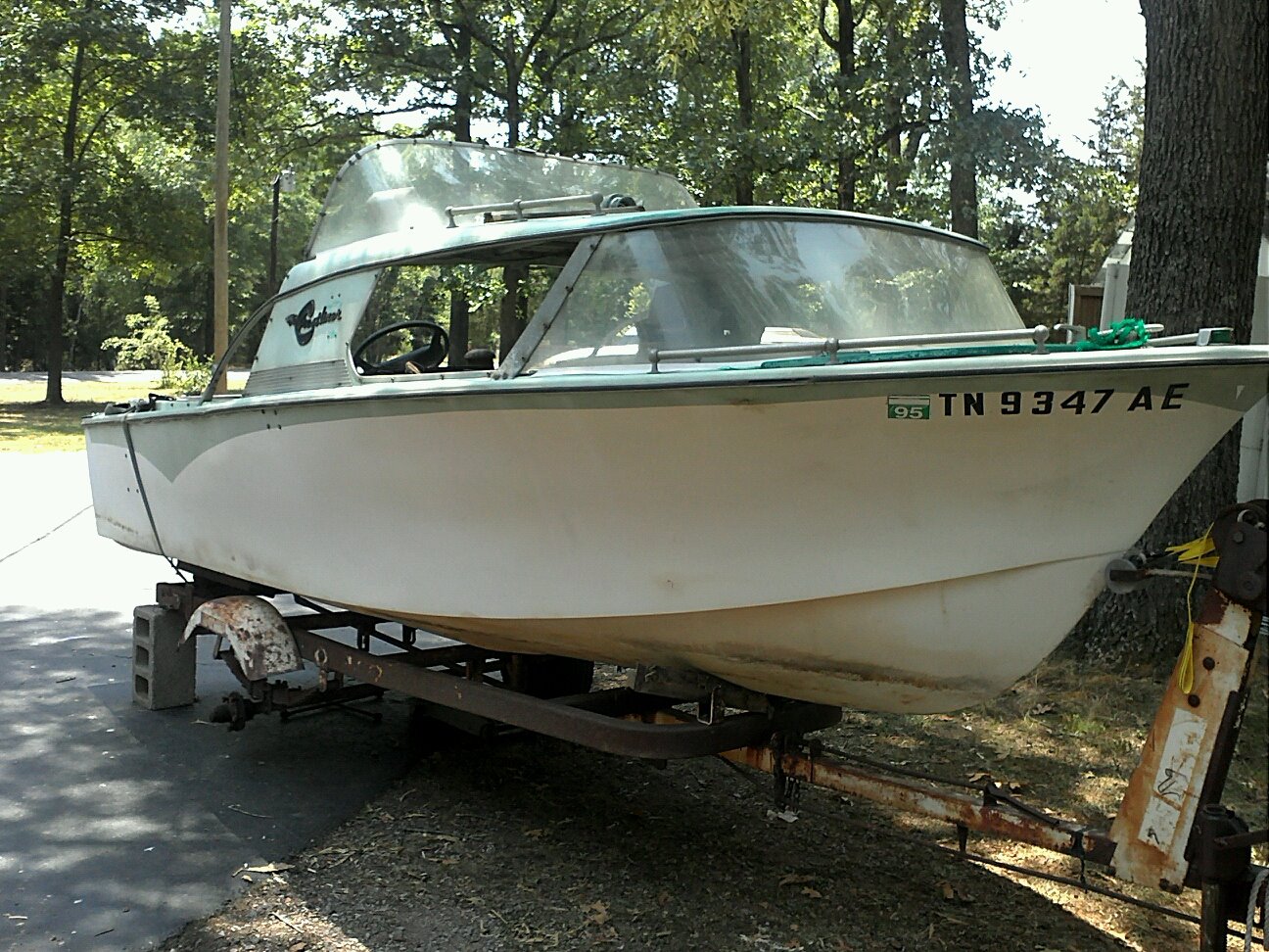

Hi guys,
I am about to get started on my next restoration project... its a cool boat that isnt in bad shape. It will replace my '59 Avalon as my Puget Sound fishing and cruising boat. I have a relatively new 50 hp Etec and some good equipment from the Avalon that will fit this baby out. The transom is solid, it apparently has fiberglass stringers. Needs mostly a fresh floor and the whole surface cleaned up (stress cracks repaired, holes filled and faired) and painted with some good two part paint. The lower plexiglass windshield is there but needs a new one formed.
All the trim is present, though the rub-rail was damaged on the stbd side to the extent that it cannot be used. Its a very narrow rub rail at 3/4" wide. I can find solid stainless rub rail, but I would like to find something close with a rubber insert. Can anyone suggest a source?
Thanks! ;)

Nice looking boat - that will be a beauty when you get it done !!

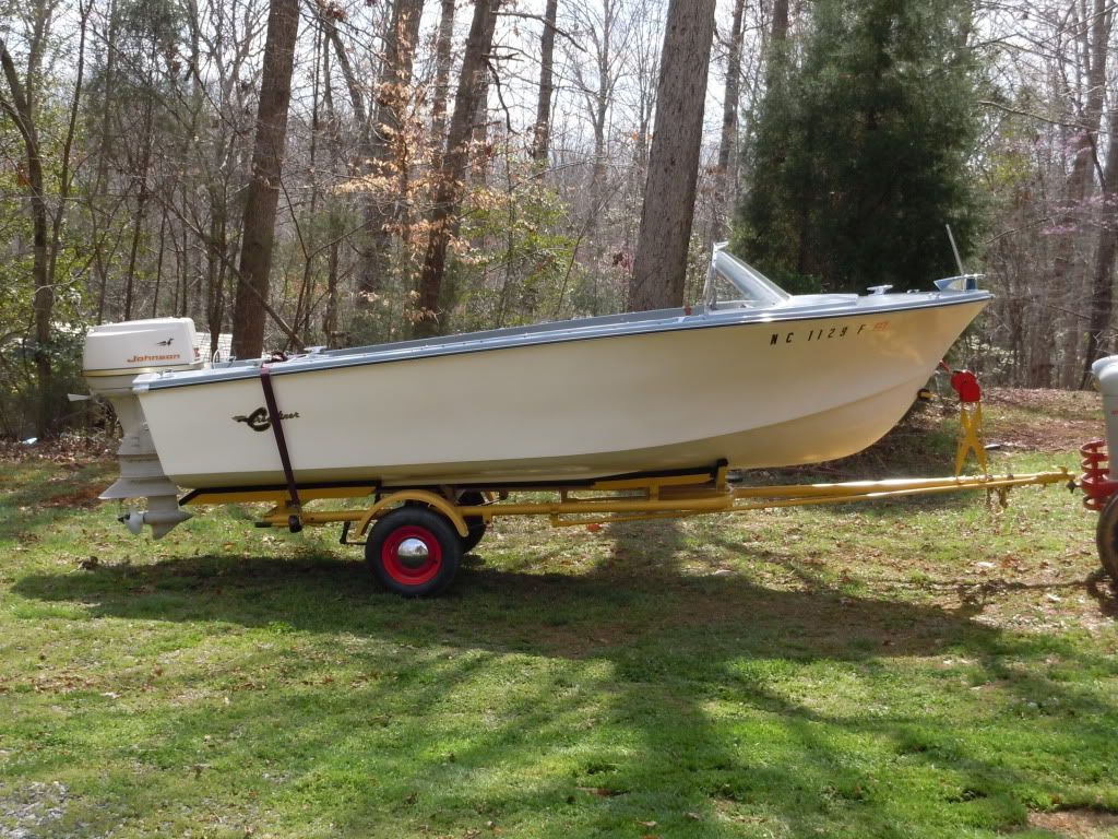

Dean, I think that boat is the same hull as my 62 Crestliner del rio. Good to know the rubrail insert will be available. Thanks for your effort.

Yep, that hull looks the same... Nice boat Jim! They said the per foot cost of the insert will be $2.50.
