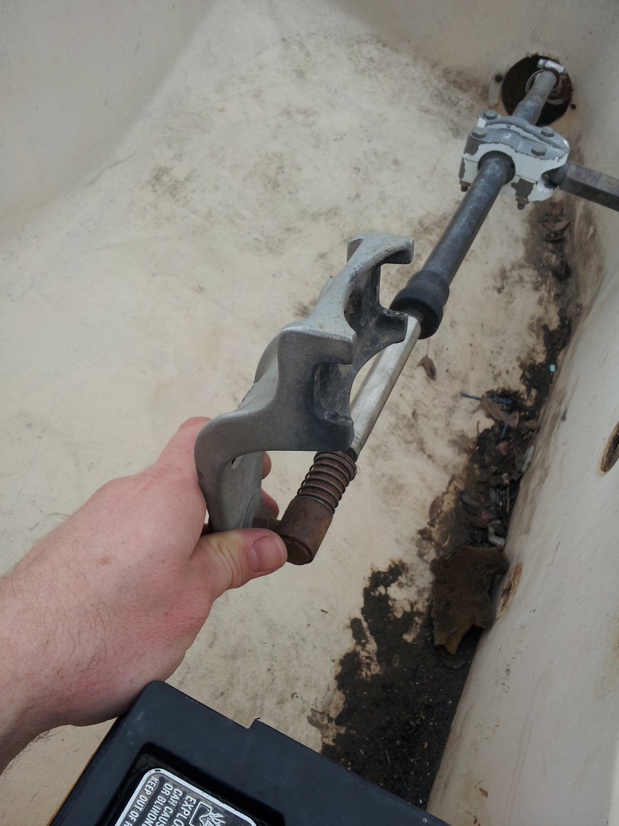

Here are the pics.
How do i hook this....
To this....
It seems like it will bind up when motor turns....
Thanks for any replies!

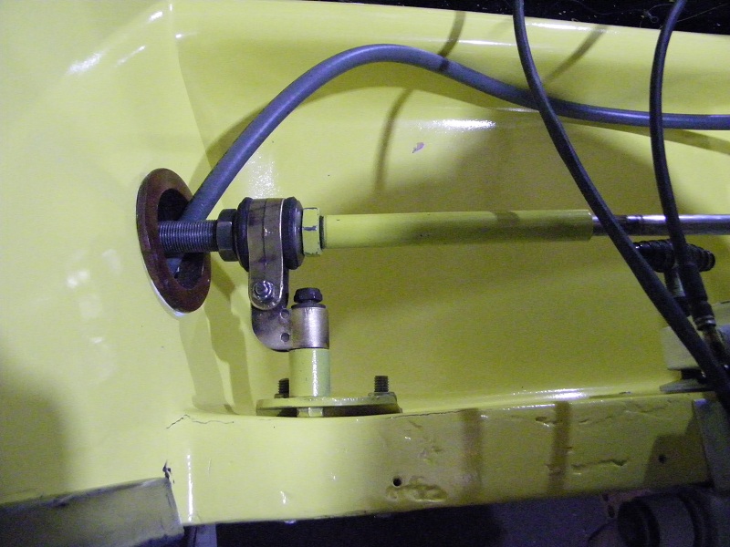

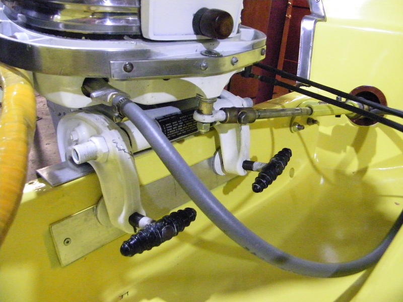

Re:pulley and cable steering conversion 14 years 5 months ago #61688

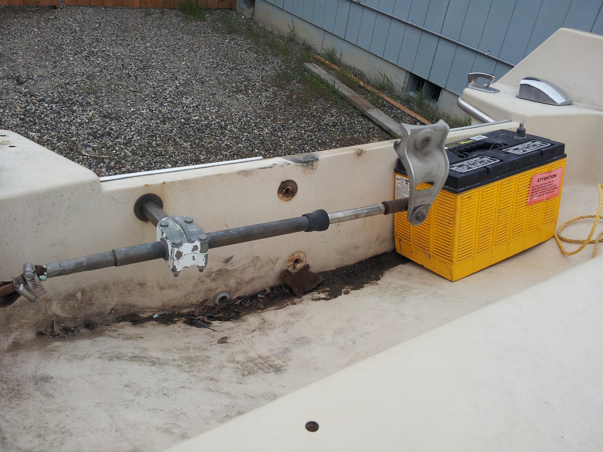

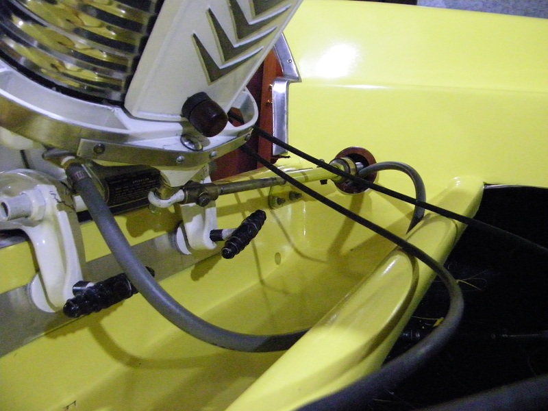

Have to go on some assumptions here that the cable is the right length etc. Here are some pictures of the setup I converted from a pulley/cable. Although it on a Merc the principle is the same except your hookup will be horizontal vs my verticle. The attachment that goes on the motor is like a gimbal, the bolt goes through a round bearing shape (the white stud on the motor) that rotates and moves with the motor when turning and raising. The brass barrel thingy connected to that stud is a two piecer that connects the setup and allows the motor to move freely while still being connected to the stationary shaft. I believe I have an older swivel stud on a shelf somewhere if you are interested.
How to attach to your transom. excuse my transom, I'm still rebuilding.
A close-up of how it is attached to the motor.
I'm sure no to setups are the same but I hope this gives you some ideas. If you're missing parts there is probably someone here that can help you out.
Good luck,
Cal
With the motor tipped up the swivel allows for rotation while the steerins shaft is in one place.

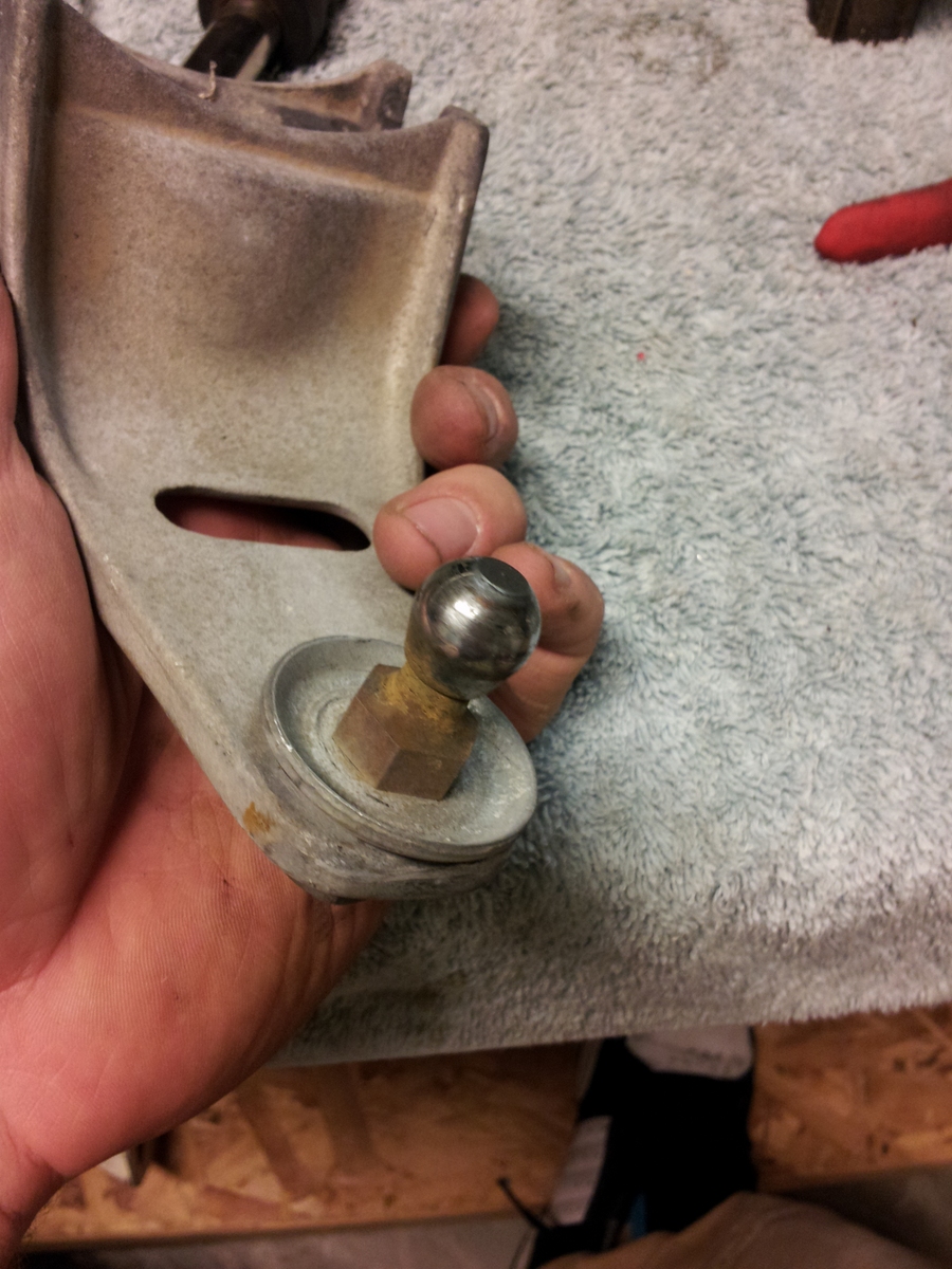

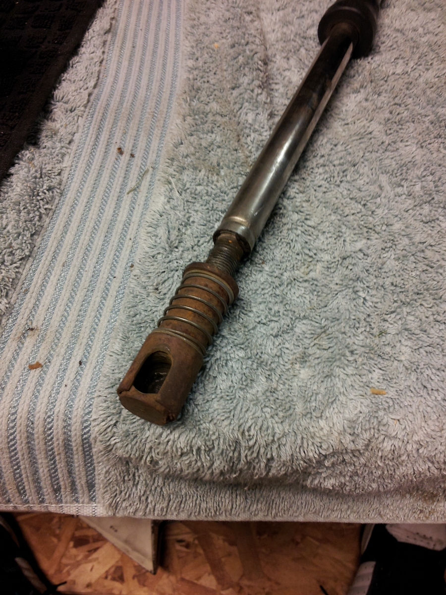

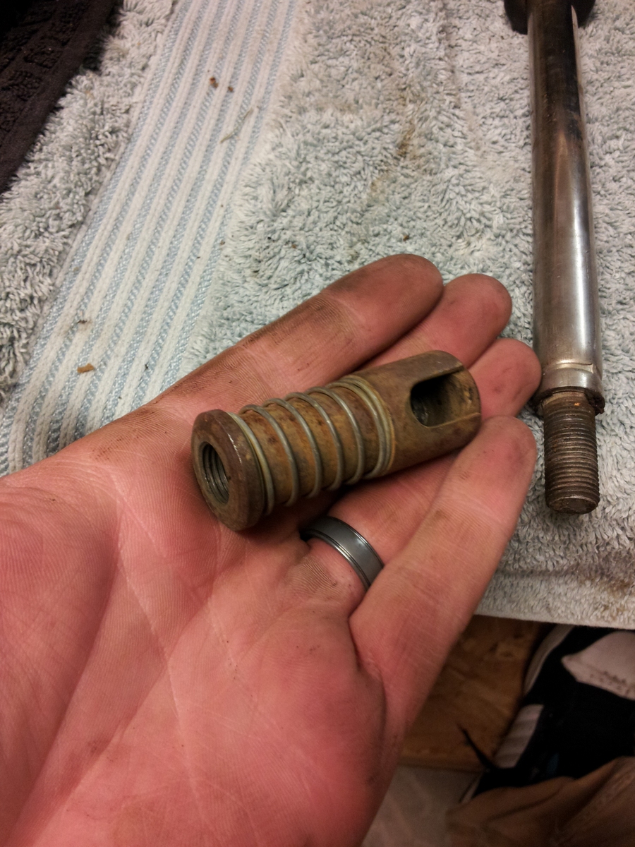

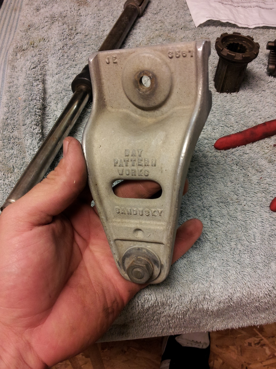

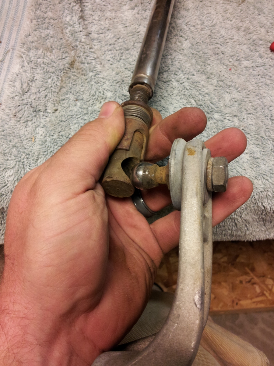

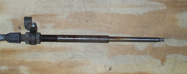

Took a closer look and snapped several pics.
here's the end of the cable:
Here's the adapter that goes on the end of the cable:
it threads on like this:
close up of the bracket:
other side:
and the ball where it attaches to the adapter:
it clips into the adapter like so:
all together:
sorry to load up on pics, but i wanted to give as much detail as possible. the ball joint allows for flexibility when you tilt the motor and turn it from side to side. hope these pics help.
