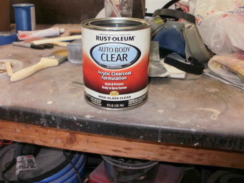

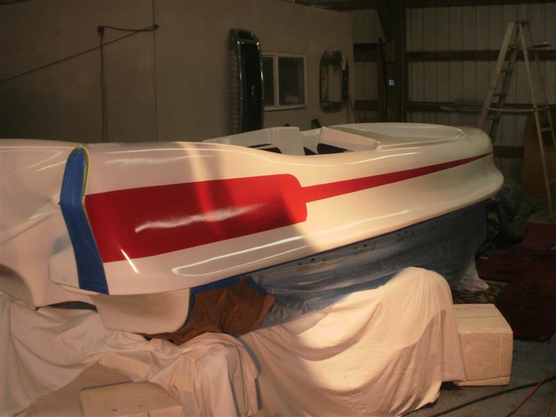

I used Rustolium paint on my Falls Flyer and used "Valspar " Hardener I bought off Amazon.com Thinned with Acetone and hardener.
Worked great and I also sprayed Rustolium Clear coat over it all . You have to use the Hardener or the clear coat will blister the base .This is my flyer with Primer - Gloss White and 2 QTS of clear a Qt. of Metallac Clear than two more Qts of clear on top of that . Did not have to add anything to the Clear coat.

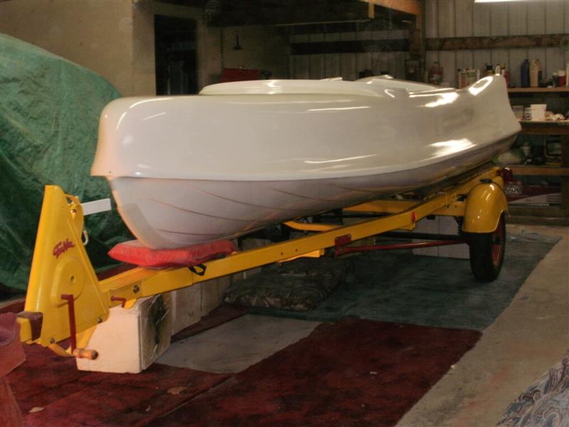

I painted my trailer with the regular Rustolium metal primer and their regular Sunburst yellow for the trailer - no hardener I like the Rustolium because it also comes in Rattle cans for touch up and small pieces
I would have used the hardener on the trailer but did not know about it at the time ! It makes it nice and hard - O'well that trailer will probably get wet about 6 times a summer .

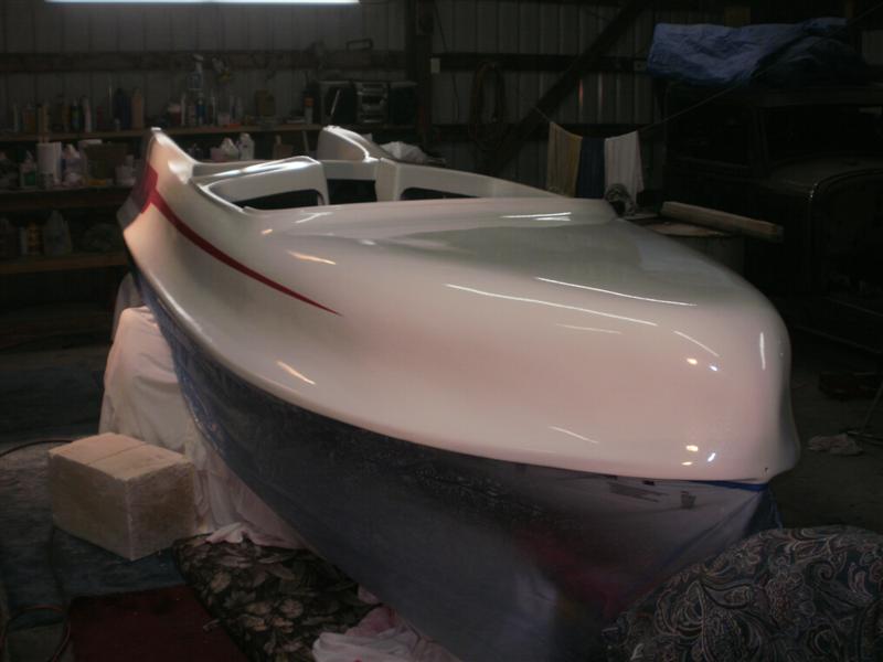

i don't know about the rest of the members/readers BUT i think that the finish on that Falls Flyer is BEAUTIFUL. - i'll have to look at that brand for the SternCraft.
Re:Rustoleum Paint question 13 years 11 months ago #61636
  • Thank you received: 5
Absolutely gorgeous Satx, I agree! Just one question Rick, did you take the paint gun out of Melanie's hand this time? (Just kidding, you know I had to give you a hard time about that!) :)
I don't know about that other hardener Bob, but I feel sure it's very similar. The Valspar stuff is great, good shine/shortens drying time/ and it is tough stuff. (And they claim it works with any oil based enamel.)
