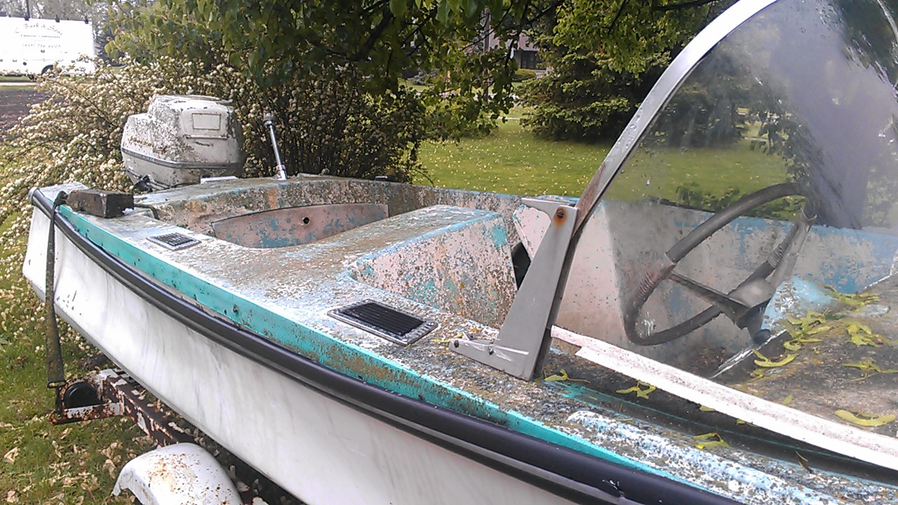

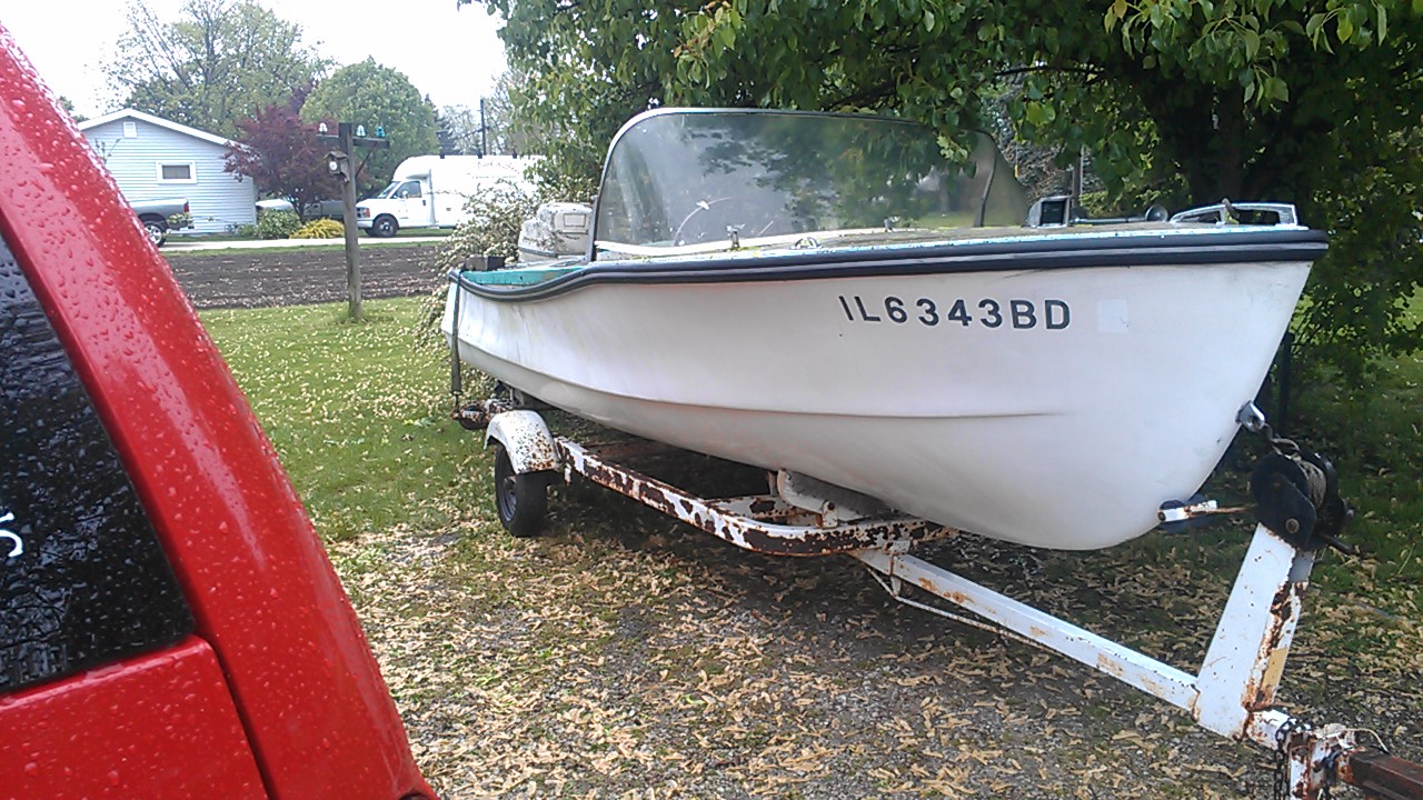

Hello everyone today i was given a 1950s era fiberglass boat for a little sweat equity. going by the numbers on the motor it is a 1959 johnson super seahorse 50 hp cant find anyway to find the maker of the boat on the dash it says capri and is really cool formed 1 piece interior. looks to seat 5 maybe. has hidden compartment where battery and fuel tankes get stored. anyone knows who made this boat

Re:PLEASE HELP 14 years 6 months ago #60198
A few Photos will help a lot

Re:PLEASE HELP 14 years 6 months ago #60199
here ya go
Re:PLEASE HELP 14 years 6 months ago #60200
here ya go
Re:PLEASE HELP 14 years 6 months ago #60201
and another
Re:PLEASE HELP 14 years 6 months ago #60202
1 more

Crosby maybe?

Does that boat have a long nose, or it that just the angle that the shot was taken...If it is the long nose I like. Can you run the IL#. We can run the TXs here in TX , and find the maker and year...Along with the last owner address etc.

I just did some looking around on iboats and saw a guy that is restoring a 1959 crosby capri. and some of the post i read said they came with a johnson motor when i ran the serial number on my motor came up a 1959 what is the chance i have a factory motor on this boat and would ther be any worth to the boat and is it worth it to get it in running condition. real cute boat and from what i can see really solid no cracks or breaks

Without a doubt - it's a Crosby Capri. Nice boat. Almost all outboard boat manufactures did not supply boats with motor packages factory installed. Boats were usually delivered to the dealer with no accessories of any kind. A lot didn't even have hardware or steering installed. Most were made to allow the helm to be on either the port or starboard side of the boat - depending on the buyers preference. Dealers were ofthen responsible for equipping boats with cleats, lights, steering, motors and throttles, and instruments.

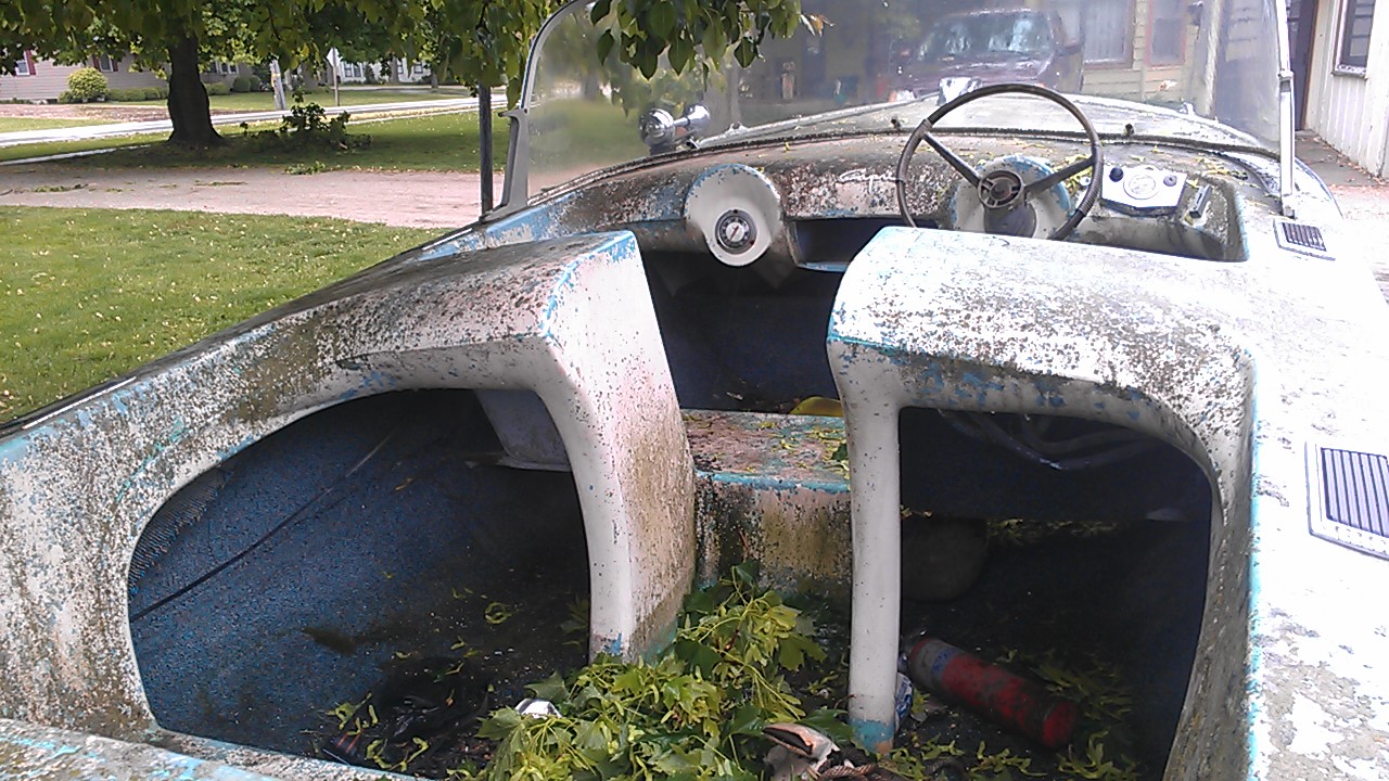

Nice interior shot. At least it looks like it don't leak and it should buff out real good. It should turn out to be a sharp looking boat when your done.Skip.

From what i have been told the boat has been sitting outside since 1991. everythin you see on the top is like a mold or a moss and comes off with a scrape of a fingernial i dont think im gunna even have to hit it with sand papper a good scrubbing might do it. no key so i will have to replace egnigition switch an all fuel lines. i did pull on pull start and its not froze up ( good) new to the outboard thing any ideas on what i should do with motor before i try to start. any and all help would be greatly appriciated

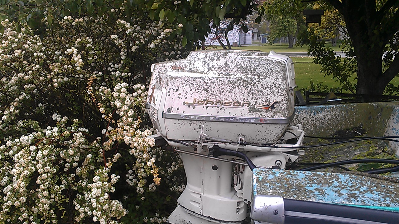

You can download a copy of the service manual from my web page-
www.agott.com/glassboat/manuals.html
Under Johnson, you'll want the 58-13 V-4 document.
They are pretty simple motors to work on, i've got two of the Evinrude v-4's, which are pretty much identical... Real gas hogs, though- They are called fat 50's for a reason :)

absolutely worth grabbing and doing whatever it takes for a full restore. Bring it to a self car wash and clean it good with the pressure washer. That will blow all the stuff off of it.

The easy way to get that crap off the boat is to set the sprinkler on it over night, or leave it out on a rainy day. Once the moss is soft and saturated with water it will come off with a plastic scrub brush or power washer. (the brush will do a better job) Keep it wet though, or it dries back on real solid.

Well for the Fat Fifty you'll definitely need to replace the impellor in the lower unit along with the gear oil. You'll probably need to rebuild the fuel pump and the carbs. Get new spark plugs and replace the fuel lines with new from the auto parts store. Bring in an old piece and they can match up the size with new ethenol resistant stuff. Marineengine.com carries alot of parts. They also have the parts diagram breakdown for that motor. Go there and enter your serial number. Once you get the parts numbers for what you need you can google it and see who really has the best prices. NAPA carries Sierra brand parts for those motors. I also have a 59' Evinrude Fat Fifty and it's a great motor. Very easy to work on, lots of torque but yep it does suck down the gas!

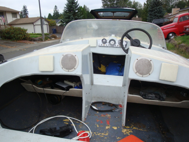

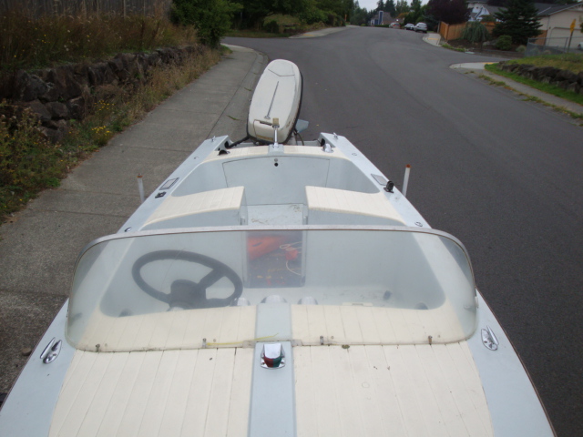

Hey nice find!It's just like mine! I have a 1960 crosby capri with a 40hp electric seahorse. my avatar pic is of it. If the motor is not worth fixing and it has a generator i would be more than happy to take it off your hands...:):) here are couple pics of mine.
