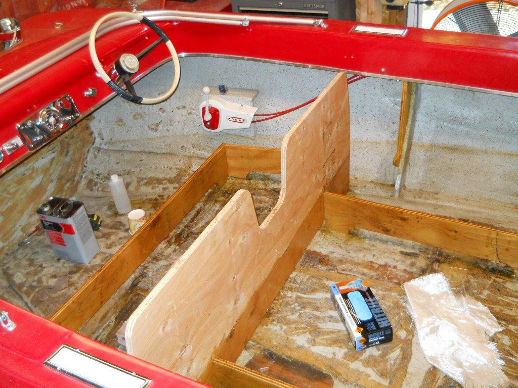

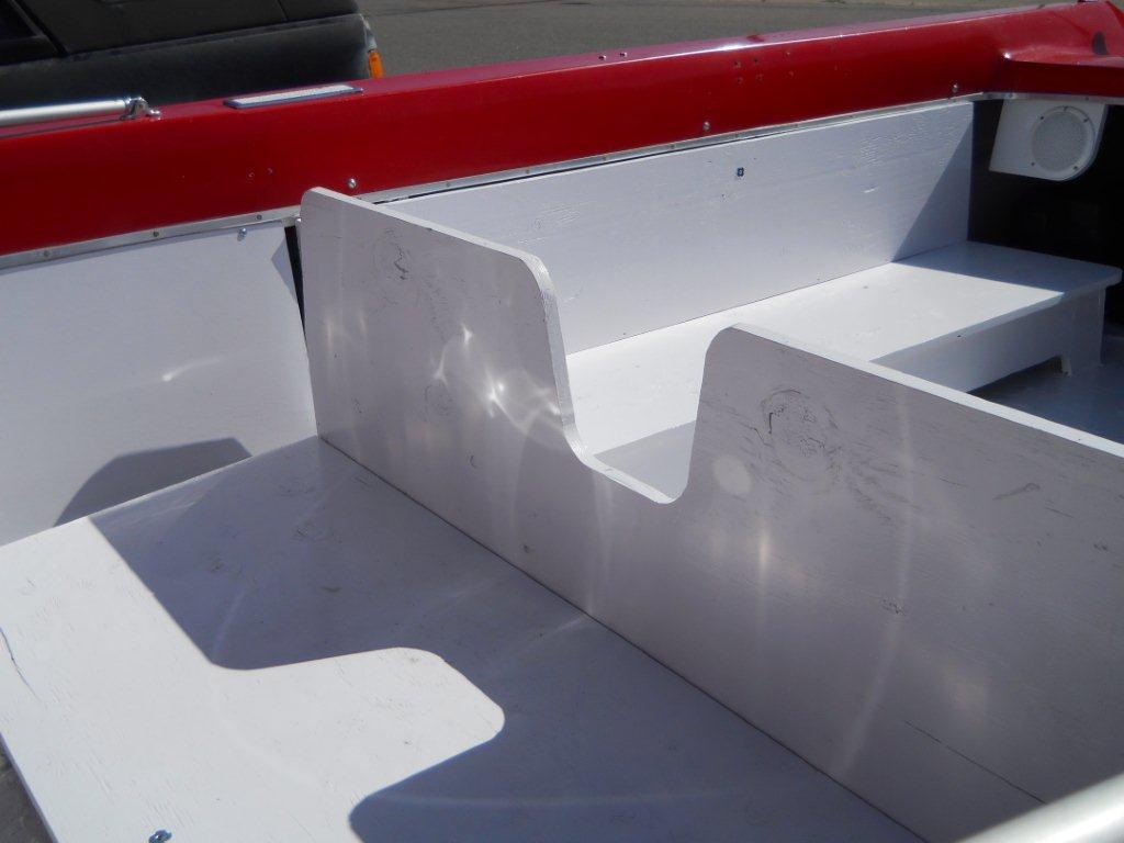

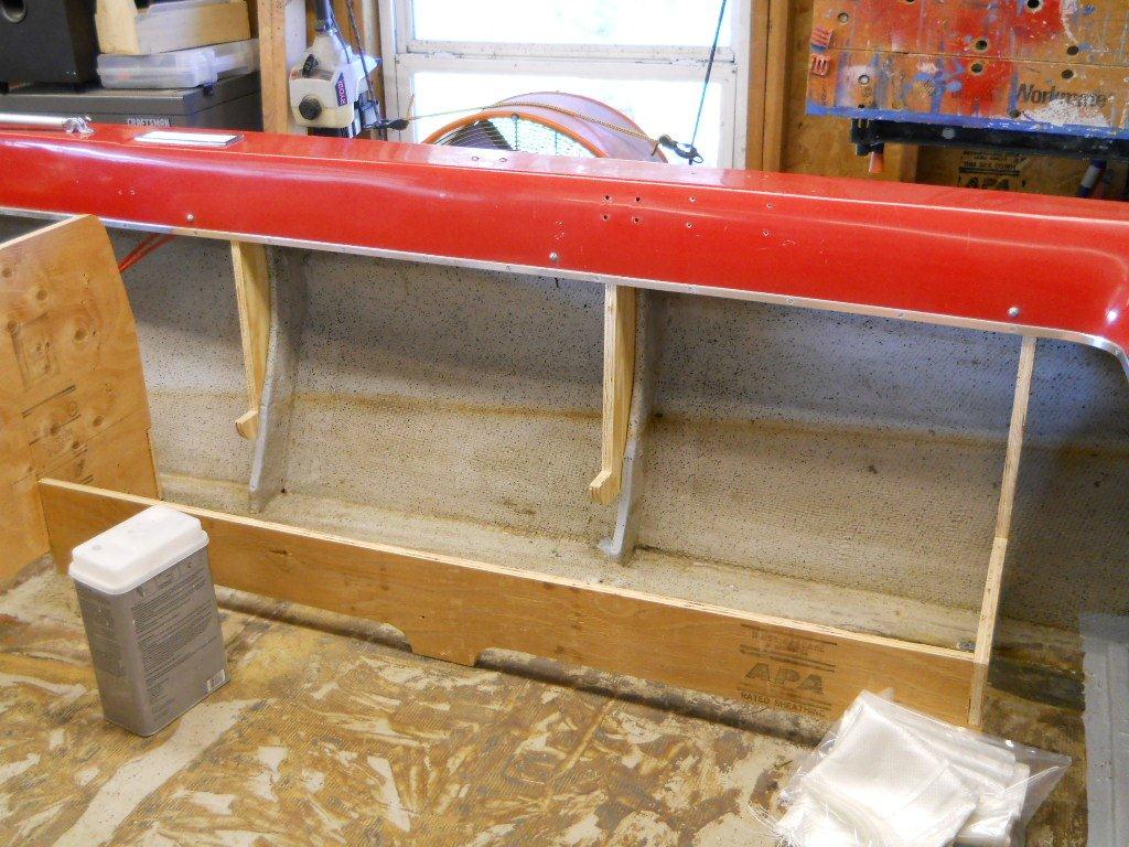

I started to build my seats, and glass them in ,next step is upholstery .
Re:Seating Layout 14 years 6 months ago #59556
Fantm58, nice! Are you going to put a support for the back? It looks like you have room on each side for a gusset. There is an upholstery class that is taught by a vacuum repair center that also sells sewing machines. The one I want is about $200.00. It will sew thru leather and thick upholstery. There is a 2 week seminar that their offering and I'm signed up. I'm anxious to see what color your going to make the seats and backs. Red and white? Something that happened to me. I made something like that for my '59 Merlin. After a while, those little feet that you have cut out, will start to dig into the hull. I put pads, 6"x6" under them, to even out the load. 1/2" or 3/4" is fine. Good photos, by the way.

Thanks
I would love to get am heavy duty sewing machine !
my wifes singer struggles a bit under load ??
I was thinking white seats with red inserts, waterfall pleats.
also I am making kick panels for the front area to conseal
my spaekers, and clean up the installation.
the feet are screwed in and glassed in, they feel pretty secure ?
but I think I understand what you are saying, i will keep an
eye on it.
as far as the seats. I am using 3/4" ply-wood for the base and backs
on all 3 seats, they will be removable for storage !

I looked at the picture a little longer. You have supports on the bulkhead uprights where it looks like a seat bottom will rest. So the people in the back will sit sideways. It looks like there was a lot of cleanup that you did to get to this point. Alot of boats and cars had that same theme in the fifties, two-toned. Weren't those the days.

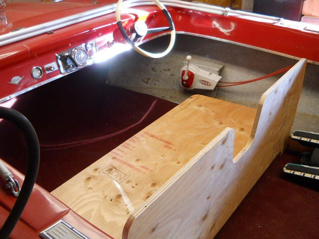

OK I finished the interior framing and lay out.
Installed my I-Pod stereo. I wanted to do my own interior work , but
due to time issues , today I am shopping a few upholstery
shops to get her done !!
