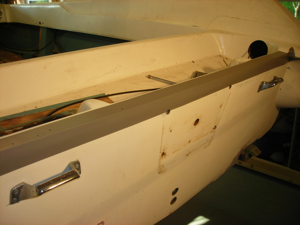

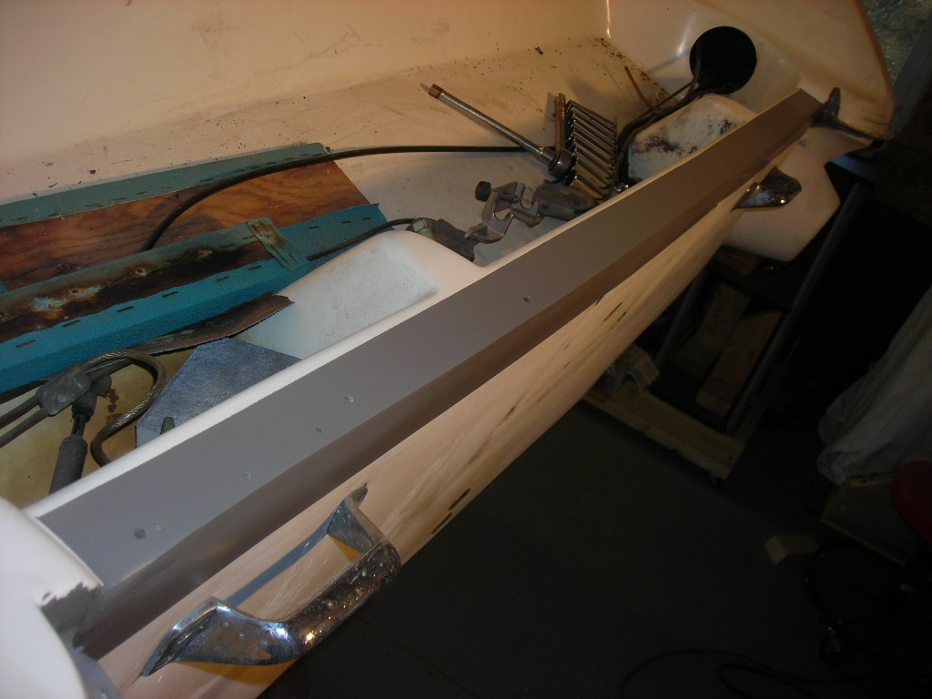

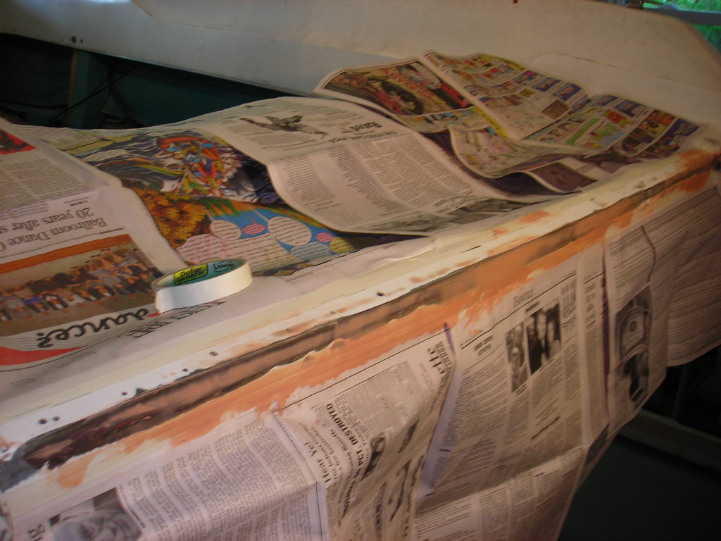

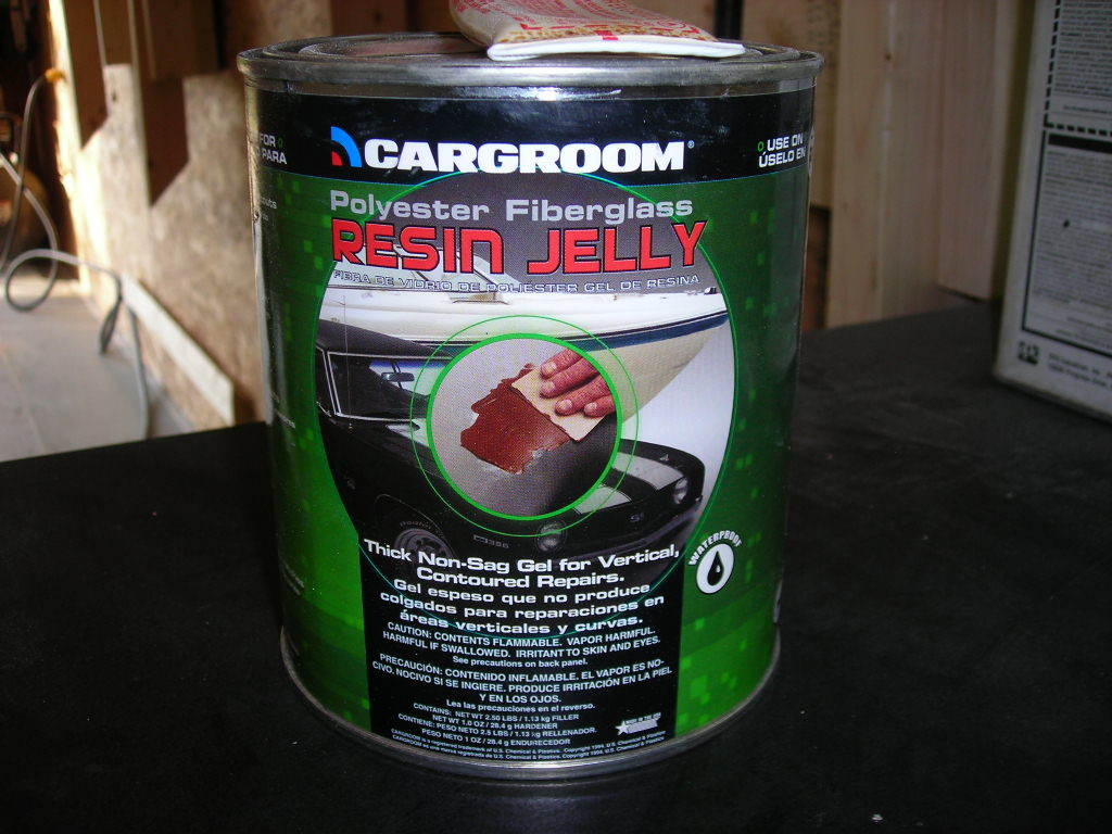

i finally got a chance to work on the sunray ,i took off the stainless metal transom plate and transom covers,and found out that there was plywood layed horizonitaly on top under the fiberglass,(built that way)but the transom fiberglass was just begining to peel away from the plywood(the plywood was still in great shape),like a dummy i didnt take before picks,but here is the during and after pics.
i found what i think is a good product,to do it with its polyester fiberglass resin jelly,i guess ill find out if its good in a few years,i hope its at least that long,lol.
the 1st pics are before sanding the others are after primer,before painting it i will feather it in.the pink stuff is a small amount of bondo to fill the pin holes most was sanded off.
i also found out that the rubrail went into the transom,i had to fill those holes too,because i cant find the same rubrail. [img]http://www.fiberglassics.com/media/kunena/attachments/legacy/images/a_transom_and_hardware_008 [img]http://www.fiberglassics.com/media/kunena/attachments/legacy/images/a_transom_and_hardware_009.jpg

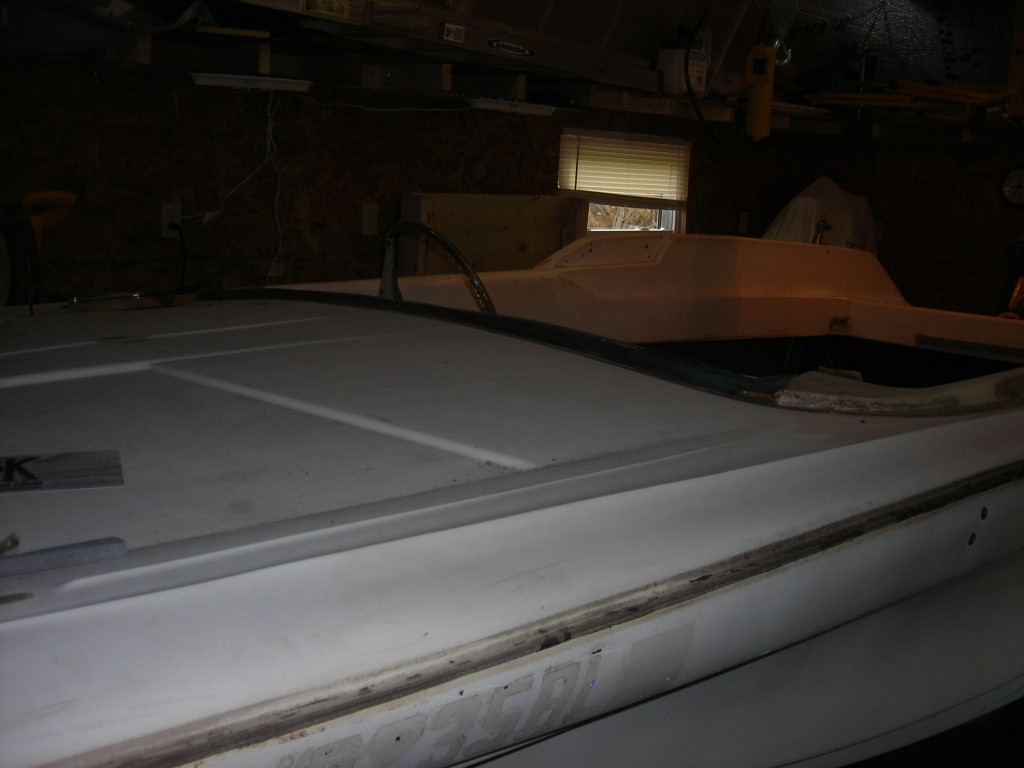

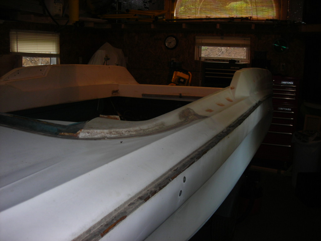

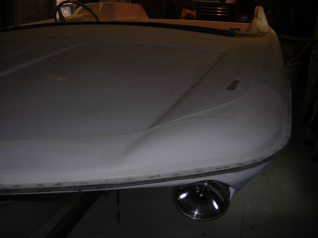

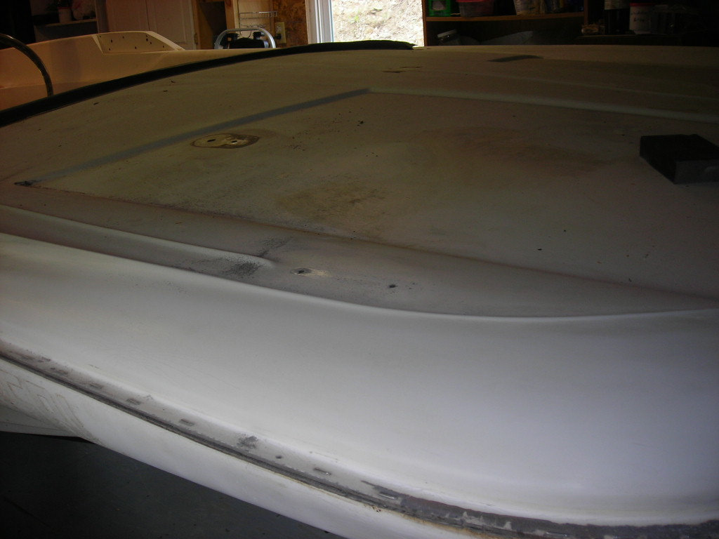

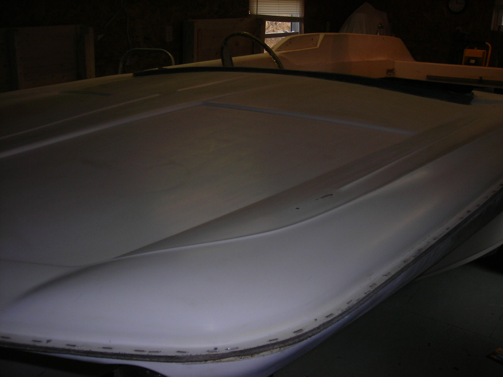

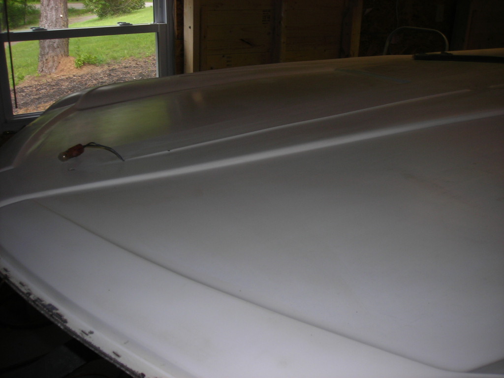

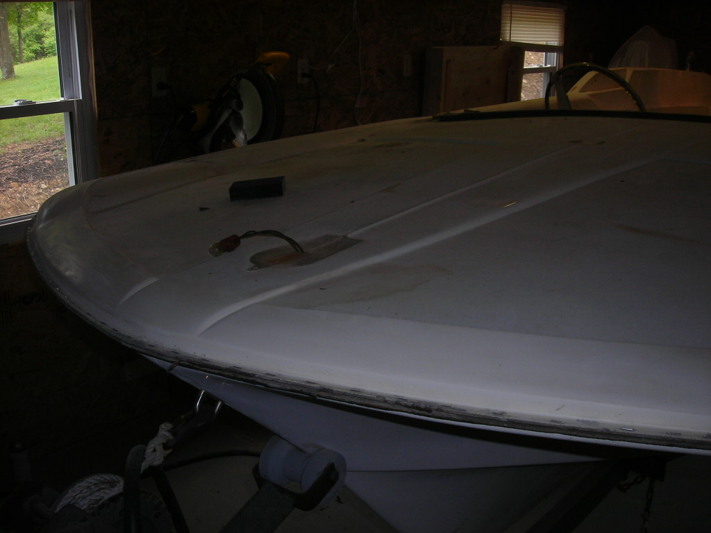

the 1st pics are before sanding the bow,the lighting is bad,so click on the pics to enlarge them to see the difference.
these are after 3 and 1/2 hours of hand sanding.
the good news is,the boat is in even better condition then i had thought,very little crazing,it could have been buffed out and looked good,the bad news is im going to pick up the metal decking for the porch today and will be pouring concrete on saturday,i hope i have enough time to at least paint the sunray after that and before the silver lake meet on june 5th,john

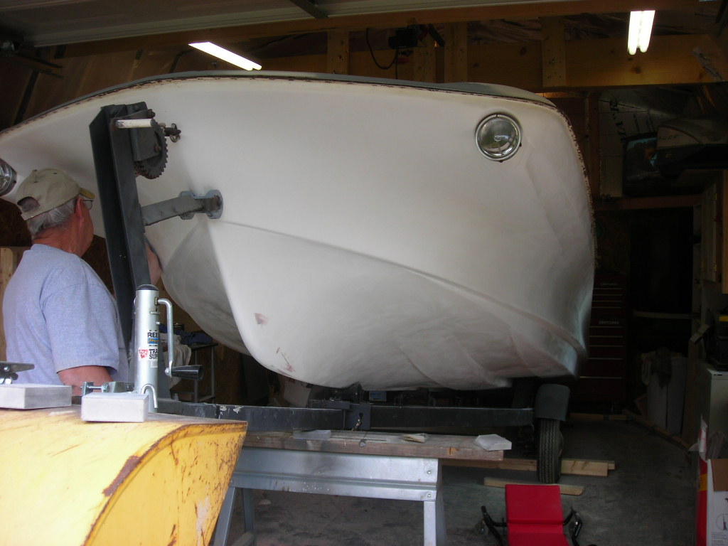

wow,i got alot done on it today with help from the owner ,ed gordon ,my moms fiance,we picked it up and sanded the entire bottom and sides,just a few very minor nicks in it,im happy.
also almost have the porch done just 2 more steps to pour and im done with that and can paint the sunray.the last pic is mom and ed,hes a character,lol
all i have to do is a little more sanding.

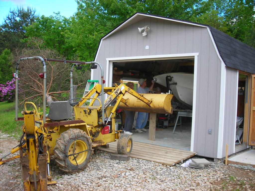

thanks delray,i used to have a construction company and built new homes,now i have a damaged heart on the left side,(3 heart attacks,1 clot)and had to sell out,or i would have built it myself,its only 14x24 but its better then working in the basement,lol,i had to make room everywhere i could,i have made fold up tables that hang on the wall,and a 4x8 folding table that hoists up into the rafters,plus everything is on castors,lol,if i hadnt done tht the sunray would not have fit.lol darn i cant post pics.

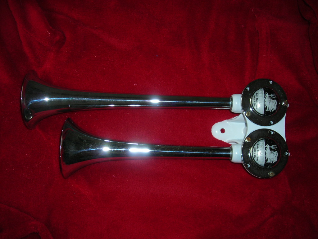

i got the custom made burgee today,wow,she did a great job,also finished buffing and painting the neptune vintage air horns,now i have to go out and fix my compressor,had to get a new drain petcock,and the air filter broke off,im going to make one from pvc waterline.i hope,lol
