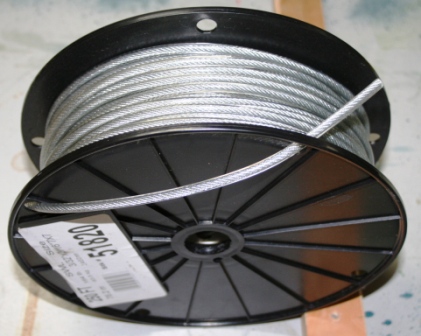

I just overhauled my 1970 Sea King cable/drum/pulley system. It's sweet! Make sure all pulleys and terminal fittings are through the hull. I feel confident in it personally. I had to buy 250 feet of 3/16 vinyl boating cable and probably used 40 feet. Made in Atlanta Georgia by Tie-Down Engineering. If anyone needs cable let me know. I'm sort of an engineering type and can say that there is nothing wrong with a well maintained cable system for smaller HP motors. It's pretty dang simple and easy to visually inspect as well.

daddye, Im interested in purchasing some of that cable from you. I am currently in the process of restoring my 63 Duo X15. Let me know What you want per ft. I just pulled mine apart yesterday and will get the measurement of what I need and post it on here. I want to stay with the original pulley cable system to keep it looking the same.
Re:push-pull vs cable steering 14 years 6 months ago #59509
Just measured my old cable and 40 ft will do it. let me know the cost, thanks
