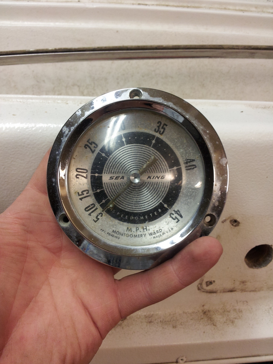

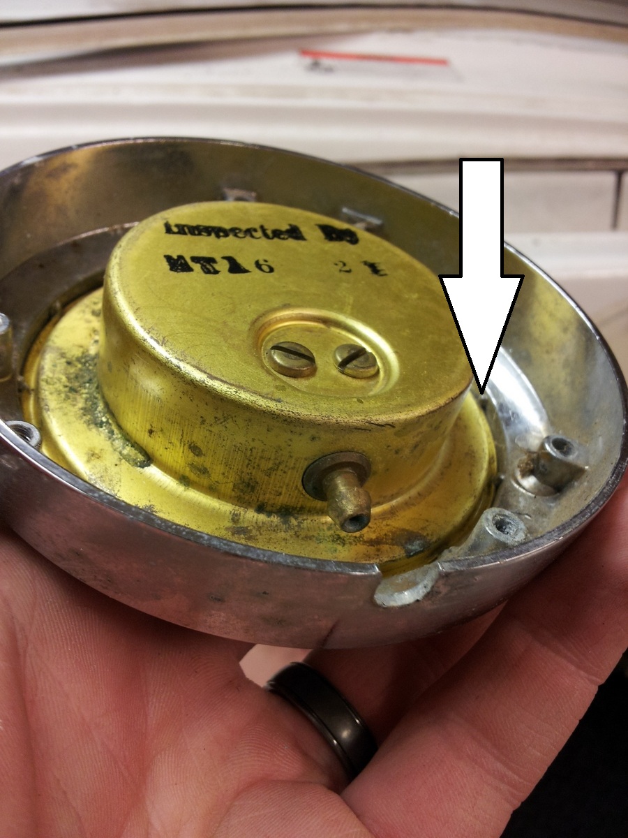

trying to clean up/test/reinstall the speedometer on my boat. i've read the section on how to test 'em, so i've got that covered. i just didn't know how to safely get the thing apart to clean it up. any hints? i didn't want to just pry the heck out of it and break it!
it looks to be clipped into place by these tabs (as noted by the arrow) but i wasn't sure.

onto another issue: is there a way to get the gauge out of the housing without damaging it? if so, is it possible to restore the face of the gauge without moving heaven and earth? no point taking it apart if i can't get it to clean up, i suppose.

pushing out the meter from the housing has real risks. I have had success and failure doing it. Really, there is no reason to take it apart if the bezel isn't crazed or discolored. The face of the gauge is impossible to fix unless done by a pro. It is usually less expensive to find a NOS or nice used gauge than to have one restored by a pro.
