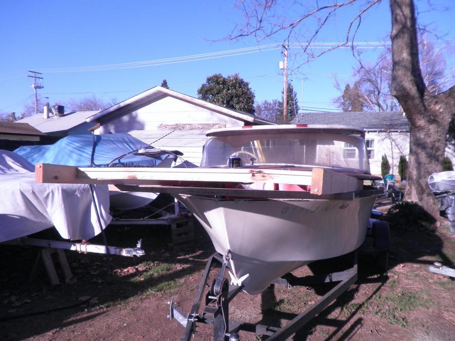

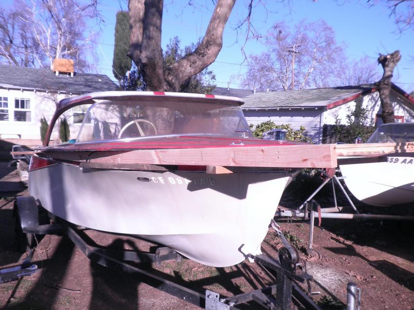

Before I split a boat I buy lumber to make a "gurney" for the top deck. I usually buy a pair of 16 foot 2X4s and a pair of studs (8foot) When splitting the hull - lift either the port or starboard side just enough to slip one of the long 2X4s between the hull and the deck. For strength - the lumber needs to be on edge, not on face. Then lift the other side just enough to slip the other 2X4 into position. Then use the 8 footers to tie the ends together. Cut off any excess - but be sure to leave enough wood beyond the hull & deck to make a nice lifting point. Then get 3 friends or relatives to help you lift the deck off of the boat. You will want to set the ends of the lumber on sawhorses. You can also cut some legs to support the middle point of the lumber so the 2X4s dont sag in the middle. This will make the deck easy to handle & will keep it from getting wrecked. If the open hull is very "floppy" cut some "spanners" out of 2X4 or 2X3 lumber. Screw a couple little blocks of wood to the spanner where the hull lip meets the 2X4 - this will prevent the hull glass from creeping outward or inward. Choose your support points on the hull VERY carefully. I personally like to support the hull in 2 places - right at the "heel" where the transom meets the bottom - and at the Prow of the boat - where the shape and contour of the V provide support without flexing.

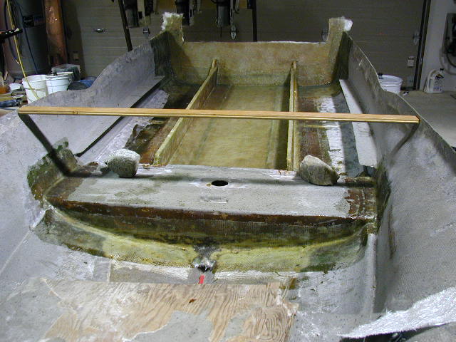

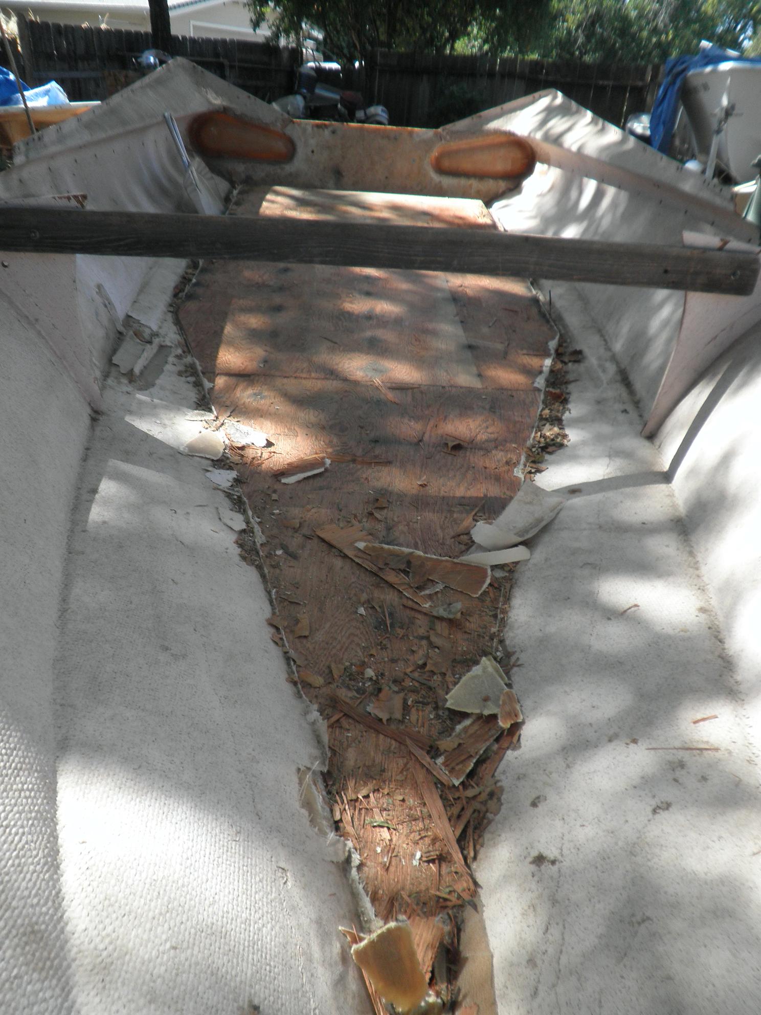

I assume that you will be replacing the floor/stringers what have you, so bracing the hull is a good idea, as the wood comes part way up the hull. If not held in place and the wood cut over sized it will push the top sides of the hull out.
I simply fit a strip of wood to the inside of the hull, prior to removing the deck & screwed it in place when the deck was off. Your boat is bigger than mine, so you may want to use several strips.

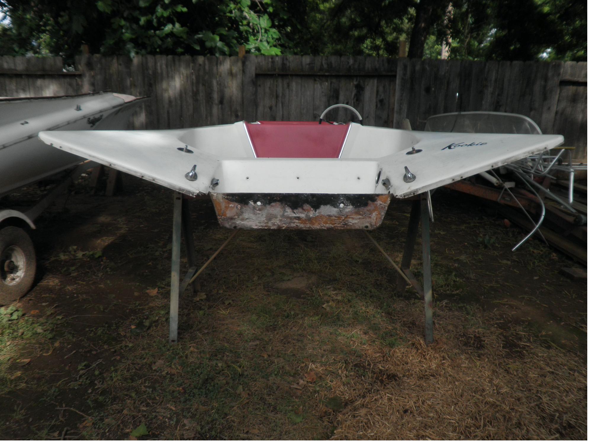

Here's where a picture is worth a thousand words
Cheers
Bill

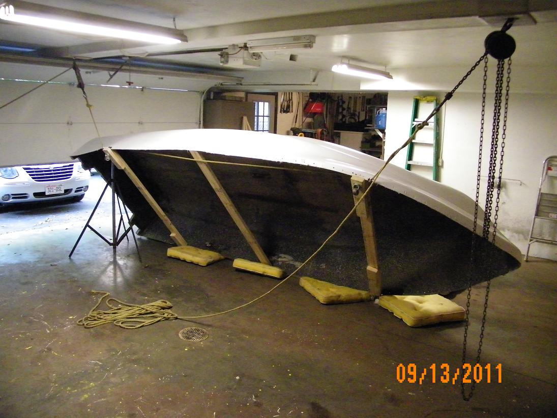

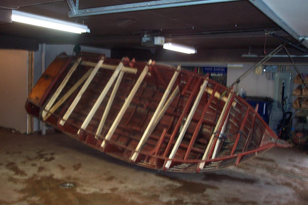

I'm apples and oranges here but when I removed the topside from my woodie I braced it across the top every few feet. This was before flipping. When I removed the top from the glass Herters I screwed three 2x4's across the inside. Put fender washers on the screw heads so they wouldn't pull through. I was able to screw some dolly wheels on the boards when the boat was flipped to make it easy to move about.
