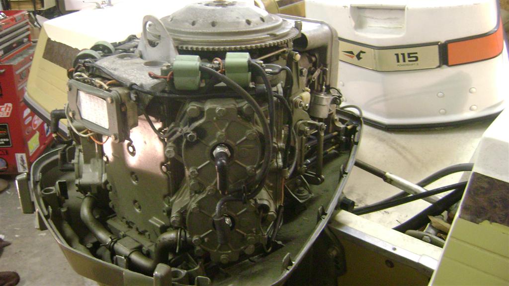

Thanks for the responses y'all, I appreciate the input. I just put the impeller in about a month or so ago, right after I bought the Starflite. This was it's fourth trip since, probably has 10 hours total on it.
I ran it on the muffs when I got home for almost 30 minutes, and the pressure seems fine, but I may pull it all apart anyway. I also have a test barrel, so I may give that a go and see what else comes out. The paint is all still shiny green, hopefully I didn't do any damage. I had planned on replacing the w/p housing next time anyway, it wasn't scored badly but looks like it could use a new one next go 'round.

Green? What year is that engine? I Thought it was white?
