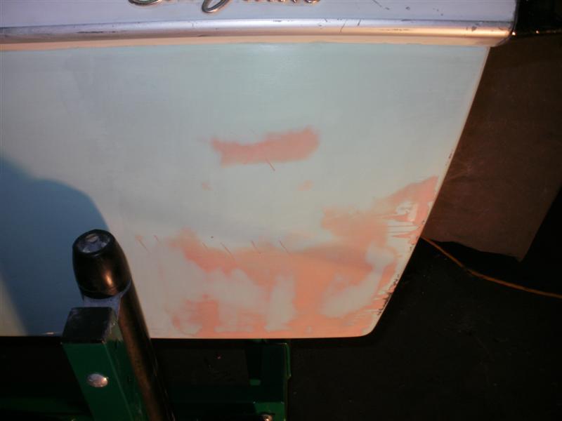

CraigLam, its not the same thing as Bondo filler. Bondo-glass is harder and filled with chopped fiberglass... it goes on green and sands out gray. Bondo filler goes on and sands out pink, very soft.

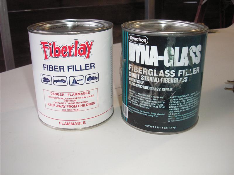

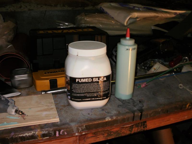

I have used Dyna glass and a fiberlay product that is like a resin jelly that you add a hardener to. It works great for faring and filling and leveling. When you say Bondo on boats attracts moisture Hard to figure how when its covered with Primer than a good coat of paint and these boats are mostly kept in a garage and get wet maybe 12 times a year then washed and toweled dry ? I could see the problem if it was below the waterline stored in the water at the dock or sitting out in the rain. You can also mix Fumed Silica with Resin to make a paste . I filled some cracks with some color matched Gel coat and the silica and you can't see where they were

I've used the bondo class plastics but better ones with great success but my boats do not sit in the water. Mine are pulled every use. It is on the roof, I see no problem what so ever. The chopped fiberglass products are great too. In fact I love them. They are strong and versatile.

If you're going to be gelcoating over the filler material, it's important to remember that you need to use either polyester or vinylester based products. Gelcoat does NOT adhere well to epoxy. I love using Epoxy based fillers due to the longer working time but Gelcoat and Epoxy do not play well together. Mixing your own is the way to go due to the consistency factor. When you buy it in a can it's usually like creamy peanut butter and I like mine to be more like Mayonaise. Flows into cracks and crevices on horizontal surfaces much better. Vertical require thicker consistency so you just add a bit more filler to the resin. I agree with andrew on the filler from uscomposites for expoxy. For Poly I use Q-Cells and Cabosil for above the waterline and 3M Glass Bubbles for Below the waterline.
