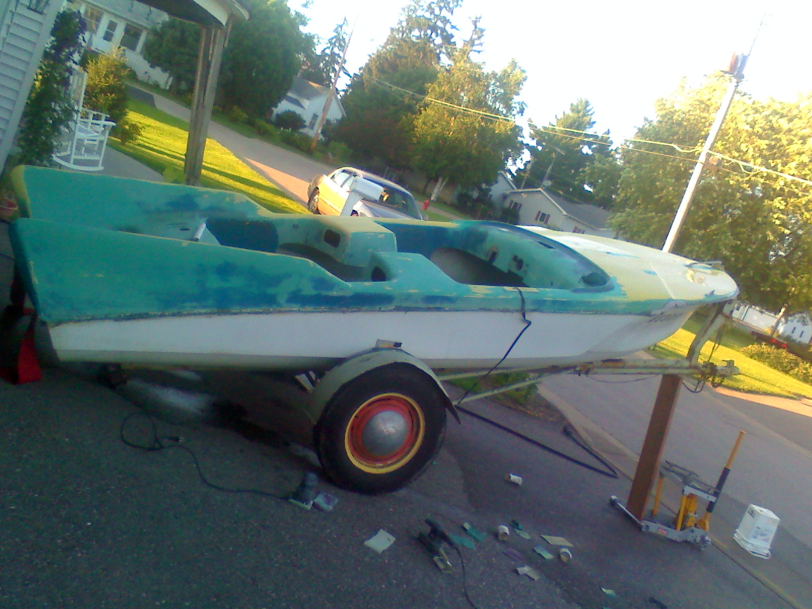

Does bondo really work well for fixing spider cracks on old boats? Is it better to grind out cracked area and re-gel coat or should fiberglass resin be used? I have a 1958 glasscraft citation that has many spider cracks and some minor transom rot at the top.

I used a variety of materials when I did my Power Cat, from resin with matt, kitty hair (filler with fiberglass strands or pieces), and then finish work with NAPA's Micro Lite body fill. Depended on the depth and structural position. My boat was covered with these cracks, both hull and deck, many I'm sure resulting from a collision the boat once had with an immovable object. I would grind them down till I couldn't see an underlying white line that indicated the very bottom of the crack, and based on that depth and structural position, would figure out which product to start with. I didn't use much resin/matt, used quite a bit of kitty hair, and a lot of Micro Lite. You can get a handle on what I did visually here: www.powercatboat.com/Group/FA_14t/FA_14t01.html

Monte; I am using Epoxy resin which is non toxic and very user friendly. Much about the product can be gleanded from my posts here on Fiberglassics www.fiberglassics.com/glassic-forums/main-forum/restofish-continued
make sure to follow the link on the first post to archives and start there.
